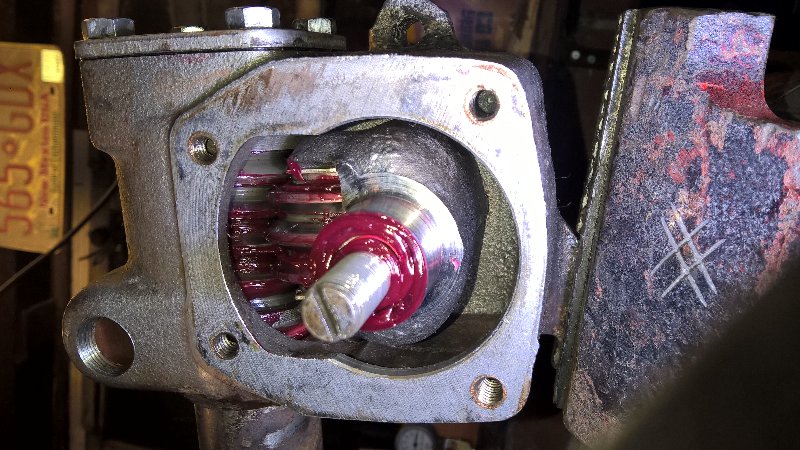

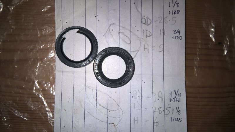

If you have a decent bearing stockist locally, take your bearing and seal and see if they can match them. Very often on these old vehicles the manufacturers would use off the shelf bearings and seals rather than having something special made.
Re: db's 1970 DODGE A108 Sportsman van

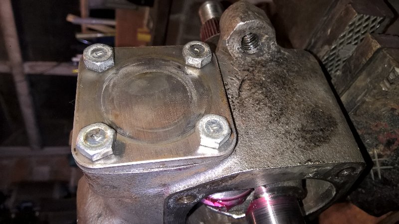

Hmm, just had a closer look. The races and the gear are cast as one part and pressed onto the shaft.

Good old Bearing Man (now BML Hayley) came up trumps today
They had a seal for the steering shaft in stock and the cross shaft seal will arrive in the morning.

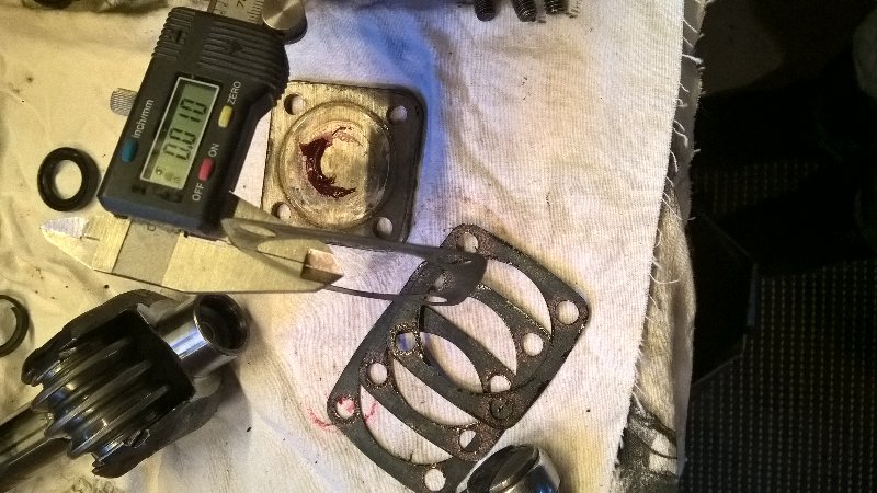

So the steering shaft bearings are preloaded by the work drive cover applying pressure when tightened. You adjust this by adding or removing 'shims'.
My shims are all .01". 4 is too loose, 3 is too tight...

Make a paper shim to go in there.

Thanks Steve that's a good option.
I noticed the cover plate, which is a flat stainless plate, is quite worn on the bearing side. I've reversed it and that seems to have done the trick! I've slid the cross shaft in now so I'll see how it feels once that's bolted up.

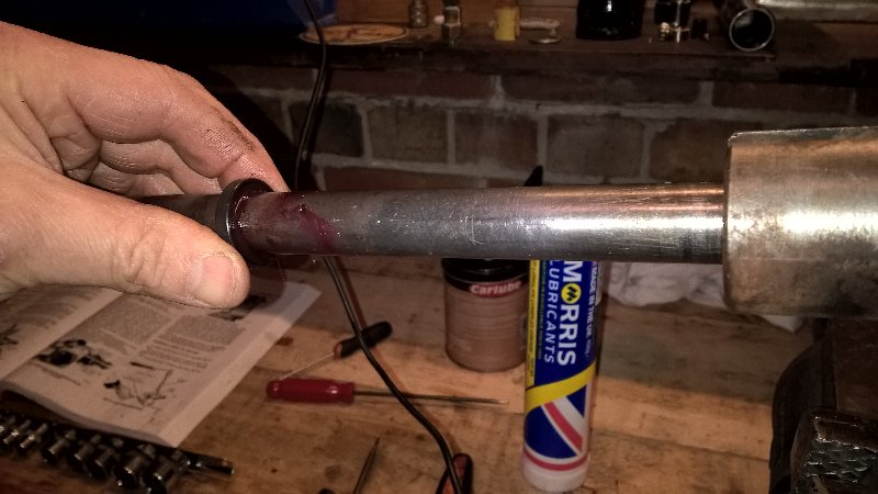

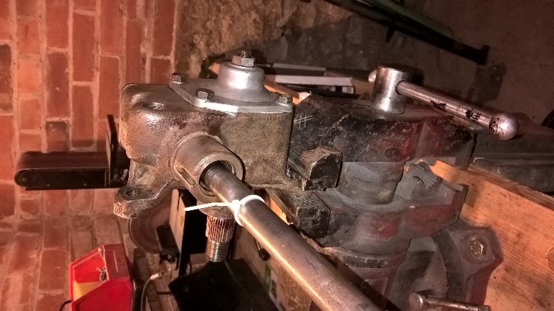

I scotchbrited the greased the shaft- that a long way to slide a seal! Hopefully it's survived. I put a cable tie around the shaft to make it easier to centre the steering.
I reckon it's pretty damn good now
I don't have an inch/ pound torque wrench to it's tensioned by hand but all the horrible feel it had has gone. It turns smoothly with a slight but almost uniform resistance.
I can tweak it slightly if necessary with the screw and locknut once it's fully assembled on Dusty. The adjustment required is in tiny increments- like an 1/8 turn makes quite a difference!

is the worm and bearing pressed onto the shaft or just the bearing race?
if both are there are a few later dodge truck worms on ebay but would need to be pressed off their shorter shaft.

Yes the sector is good mate. The worm gear is good it's just the lower race. It looks like the worm and both inner races are cast, machined and hardened as one, then pressed onto the shaft.
