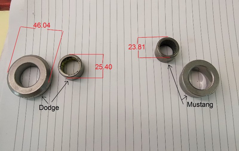

press the roller bearing out of each and put the mustang bearing in the mopar magnum bearing holder and whack it into the boss of the crankshaft flange where the converter spigot sits on an auto that should work.
If it's not deep enough a longer roller might be necessary, I can't see how far the end of the input shaft sits into that area in the end of the crank. I used an adapter that put the end of the spline level with the frication face of the flywheel...that might have resulted in not enough space for the plate or indeed a need to push the bearing back a bit in its boss.
Thanks for the advice again Dave
But I have a problem :-k
I did as you said and bought the two spigot bearings, a Dodge Dekota and a 2000 Mustang spigot bearings.
The Dodge bearing retainer fits great,the problem is the mustang bearing is too small for the Dodge retainer.
Have I done something wrong? :-k

just go to your local bearing supplier with the dodge bearing 'carrier/sleeve' and the ford roller bearing (as well as the gearbox input shaft size) and they supply the right one.
choice 2 is get a local engineering firm to turn a new bearing 'carrier/sleeve' to fit your dodge crank and the ford bearing.
either will work, neil.

mygasser wrote: Thu Aug 13, 20 6:23 pm just go to your local bearing supplier with the dodge bearing 'carrier/sleeve' and the ford roller bearing (as well as the gearbox input shaft size) and they supply the right one.
Thanks for the input Neil
Once back at work, I can make a carrier. But I really want as many parts as possible as just plug ang play, rather than making bespoke parts, if possible

TIB3300 wrote: Fri Aug 14, 20 8:42 am
once you've made it you only need an off the shelf ford bearing any time it needs replacing. the carrier you'll only ever need once.

Thats odd
let me check again what i have...
apologies if i have mislead
i'll do a bit of digging
"have you done something wrong"...no its more likely i have been mislead. apologies again
