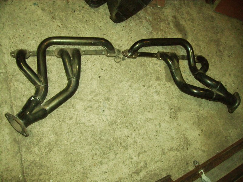

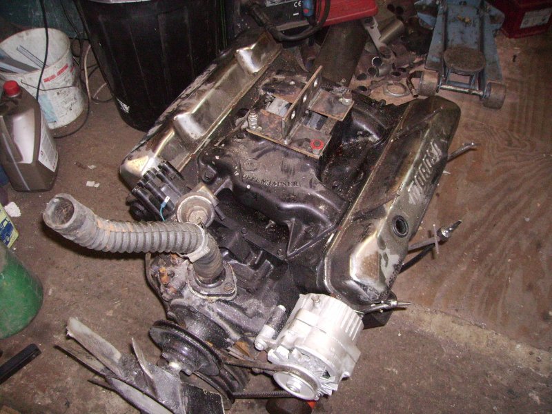

today was a good day for me. dawn called to tell me the schumacker tri y headers i bought from dave billadeau had arrived and i collected the engine and box too

i'm making a start on pulling the engine and box today. i'll get the engine out first so i can slide the box out without removing the trans crossmember. that way i won't need to slacken the torsion bars off (not my first mopar rodeo ;) ).
updates later.
