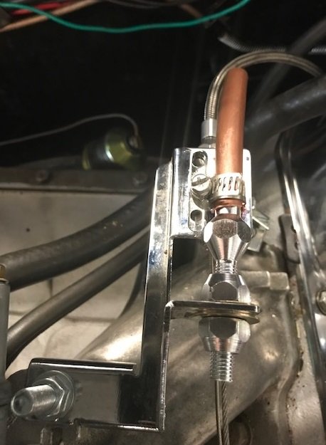

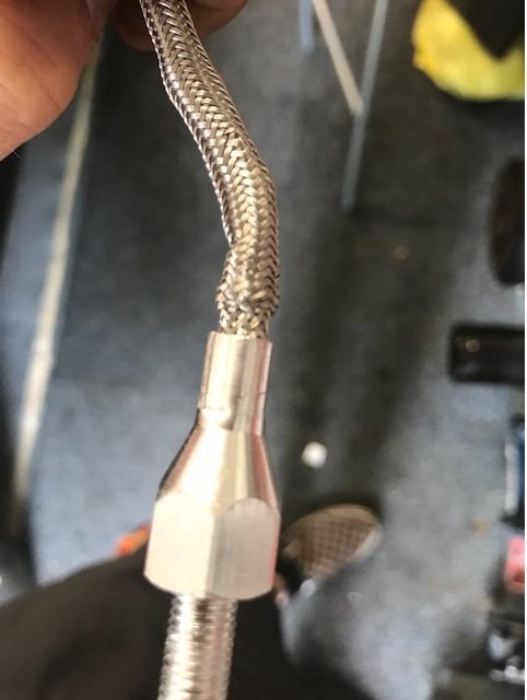

So - throttle cable. With the best will in the world the throttle cable from the 50 years ago small block just didnt reach. I lashed it so it would run but it was a stretch. Ordered a generic to replace it (or rather bought a generic as it was in stock) - looks like a lokar - happy days. (or so I thought).
What a piece of junk. It has no structural integrity and camp resist compression. So the first one I trimmed, fitted, fettled, got it nice. First time I pressed my foot on the cable and it just 'crimped'. Never seen anything like it - result, slack cable, 1/4 throttle. grrr. I managed to get it straight enough to work and then the 'carb joiner' popped off. (balljoint thing). On investigation the cable only went as far as the grub screw (not beyond) so there was nothing to hold it. (see diagram).

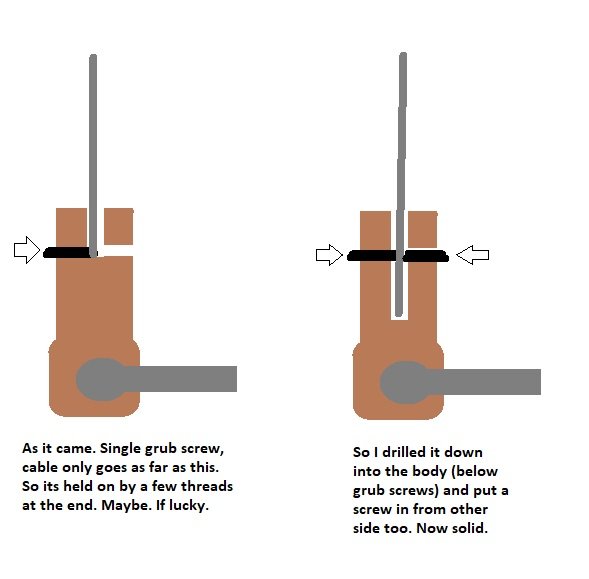

So I assumed it was a dud, got another one, gave it more length, drilled the grub-scrww-cable-end so it went all the way on. Happy days. Then I pressed the throttle. Crimp. See photo. Cable simply 'compresses'. It might as well be made of cheese.
So (and here is the redneck bit). I've got the remains of two throttle cables. Two lots of all the hardware. A length of cable which would do it but even if I crimp ends on it would prob collapse again. It occurs to me if I can 'force' the cable to follow a route it wont crimp. So I decided to take a piece of 10mm copper tube, trim a length of braided cable shield long enough, and use the copper pipe to 'hold' the new cable in place. Here are the results - and its magnificent. As a result it follows a set route, doesnt catch or bind and most importantly WORKS. Coupled with the freshly drilled balljoint I can have some confidence.
What I actually neeed of course is the 'real' mopar cable (or the mancini replica) but I need this running in a week - I am out of ordering time. This'll do it...
So - happy days. I know its unorthadox, but its only silly if it doesnt work !

Order the combined Lokar throttle & kick down, got one on my 440 and works a treat. Some don't like the kick down cable, but mine works as it should now I have adjusted it, you must follow the set up instructions to the letter ! I fitted an added a return spring to the gearbox valve lever as recommended by Blue or Dave can't remember who sorry!
Rog
Started with an MGB in 2004, then built a Cobra Rep with a Chevy 383,next a Chevy Bel air with a Big Block 454 and now lastly maybe ! my 68 Charger 440 RT always work to do.
Super Sloth
Posts: 692
Re: status - Help ! - Morgans 68 Charger. Engine #3...
Post by Super Sloth »
Agree with Roger (Nice to catch up on saturday btw!). I've just set up the kickdown linkage on mine and it took me the best part of 2 hours to get it setup in the ballpark as per the instructions and then subsequently adjusted to suit when I upgraded to a 4bbl. It's quite the faff.
-Jon.
Re: Morgans 68 Charger. Engine #3...
I did exactly the same thing years ago !

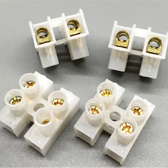

Also you can cut open a cable terminal block and take out the brass bit for some added cable security on both sides.
One thing to note is ensure your engine earth is in very good condition or the copper tube will glow when you crank and crank as it such a good conductor.... been there burnt foot
Ps. Dave has a lokal setup for sale in forsale section and it’s the way
