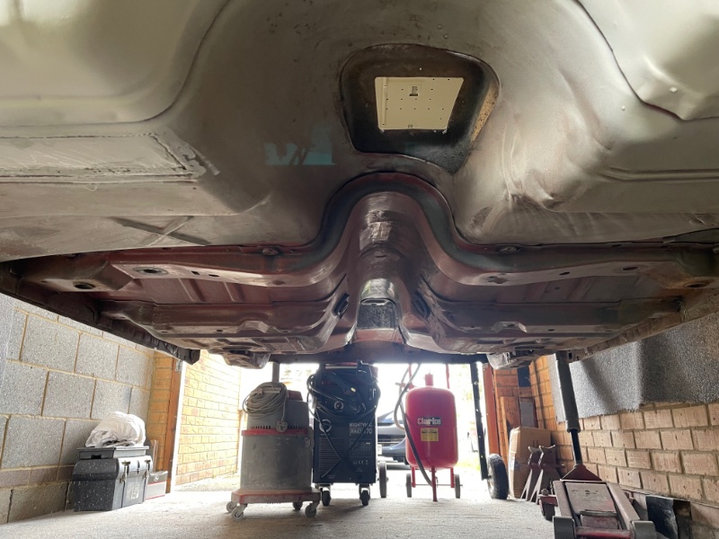

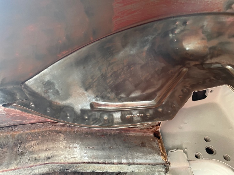

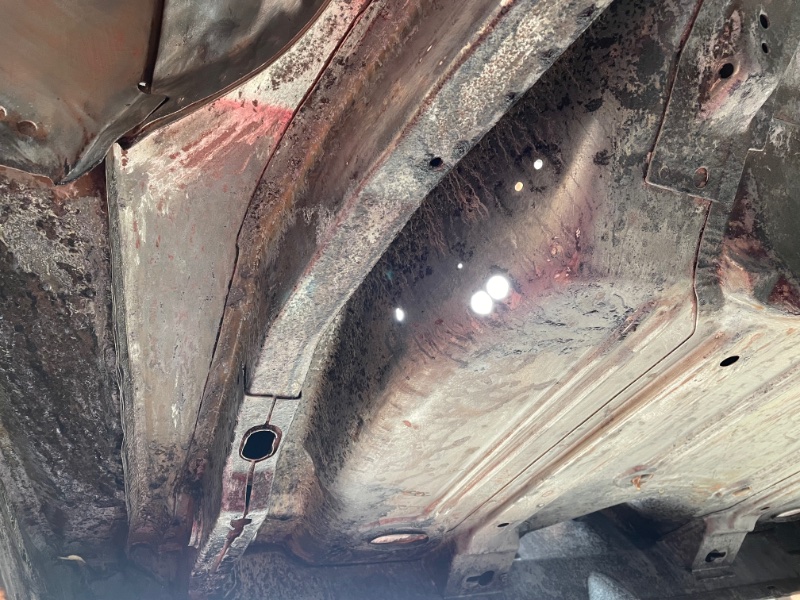

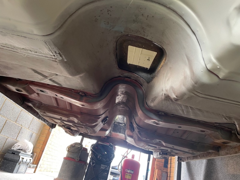

While I’m trying to sort out the rad support at work I’ve lifted the shell so I can get the underside ready for epoxy
From the front bulkhead to the rear bulkhead it’s virtually like new, but have surface corrosion from the exhaust box position back
I’ve welded one small patch panel which will be fully dressed and will be invisible once primed

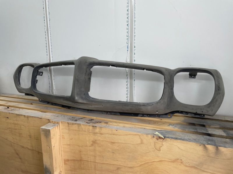

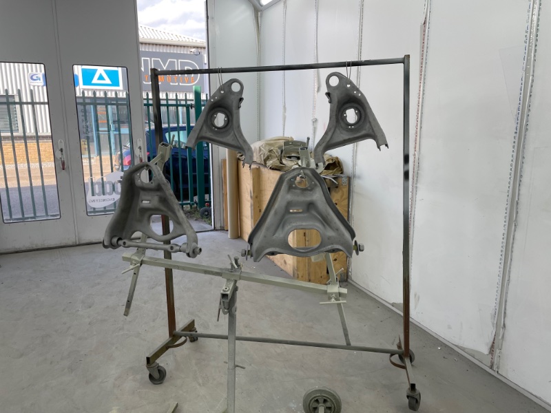

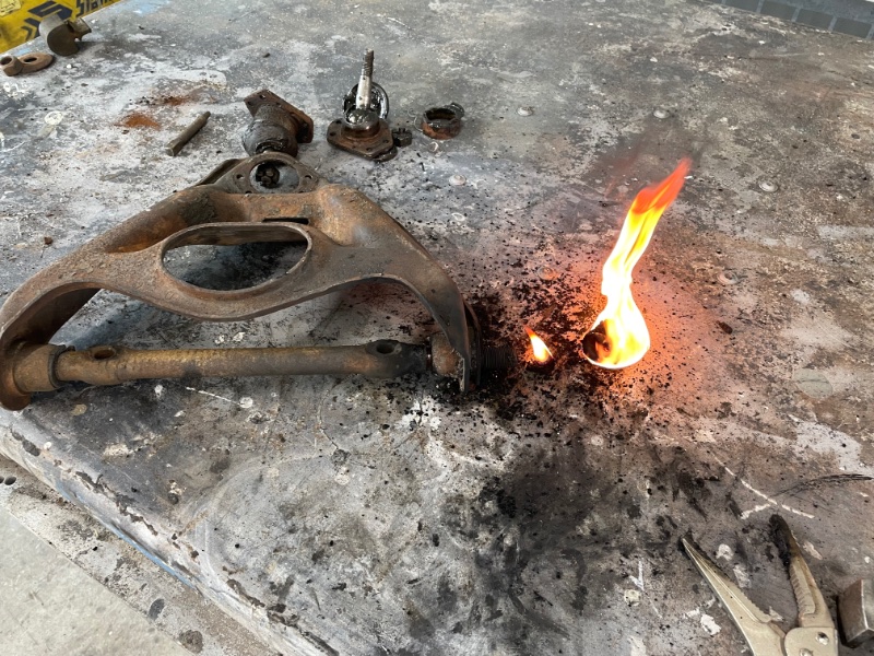

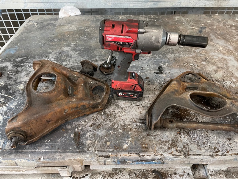

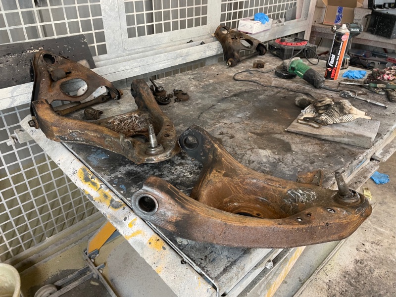

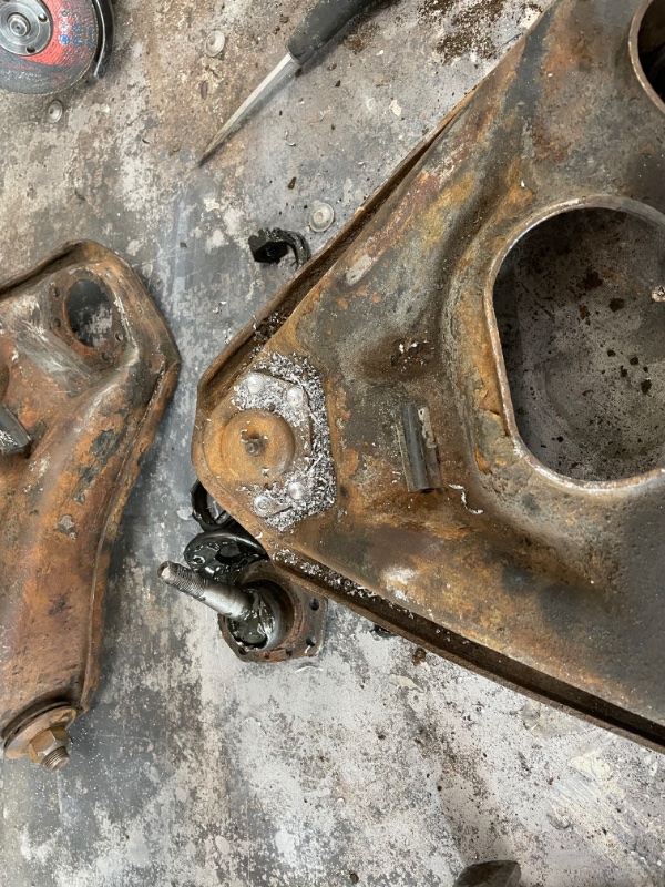

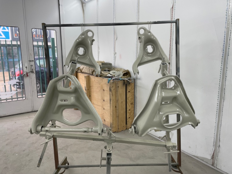

Been busy this week, finished the rad support and stripped and started to refurb the front control arms

Still got the top arm bush cups to remove but after 9 straight hours I was running out it time and needed to get the blasted arms in Epoxy!

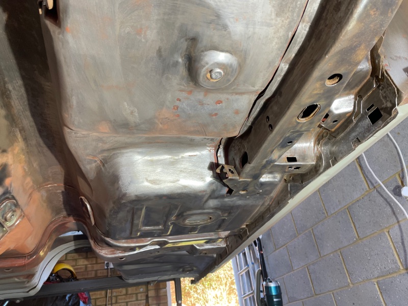

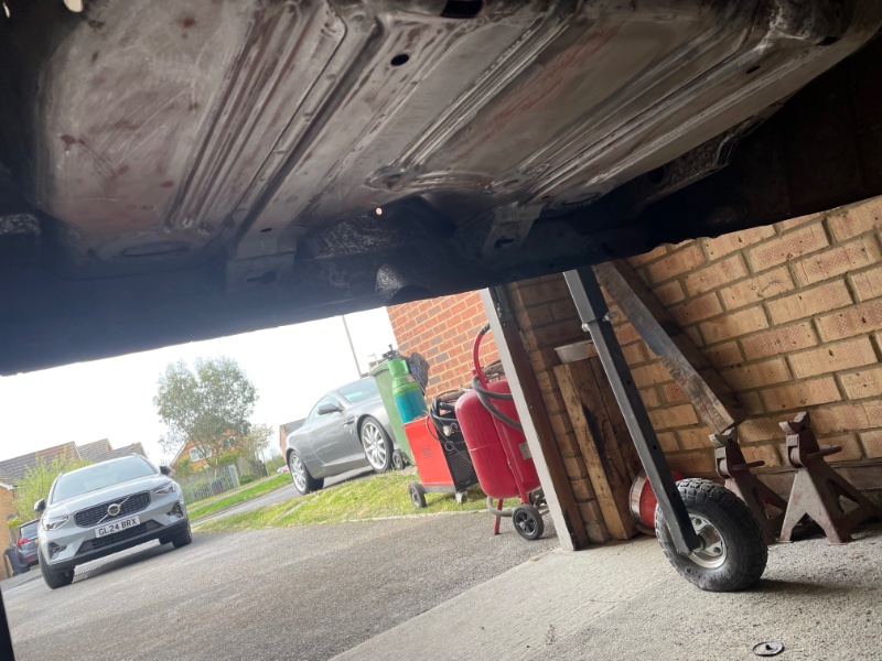

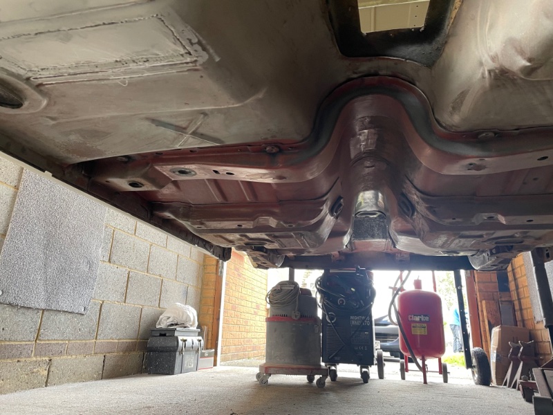

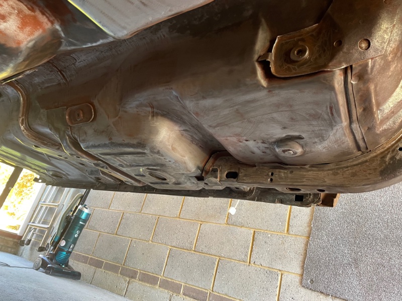

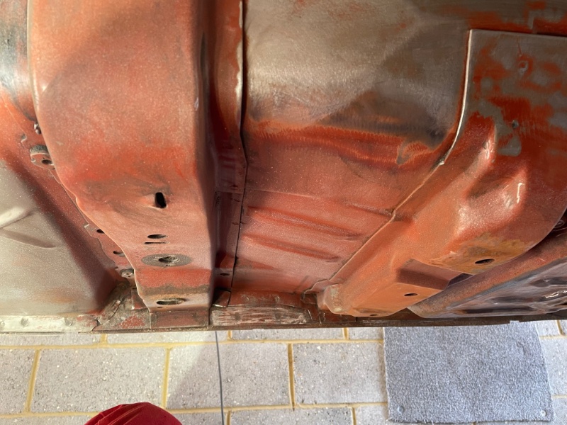

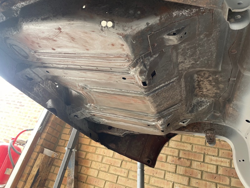

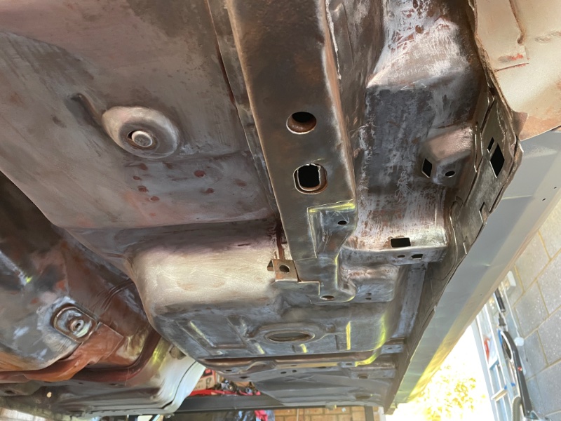

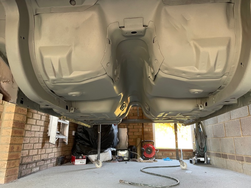

Spent all day today on the underside managed to finish the preparation to the right side and I’m well on the the left side,
I’m completely knackard now , far too old to be lying on my back working upside down for 7 hours!
Still got a lot of parts to buy !
But will have to be brutally honest if prices rocket and use more of the original stuff I’ve got ??

Re: My very last restoration!!!
That must have been tough going. Blood draining from your arms and getting absolutely covered in dust and grime I imagine!
Yep !
Finding it hard going now, but I just don’t have the room for a rotisserie and they can be dangerous tools in a confined space,
Since I torn my bicep tendon I’m damaged on my right side now which obviously doesn’t help!
But I’m not to far off paint so that will be a relief!
Joys of restoration work ,

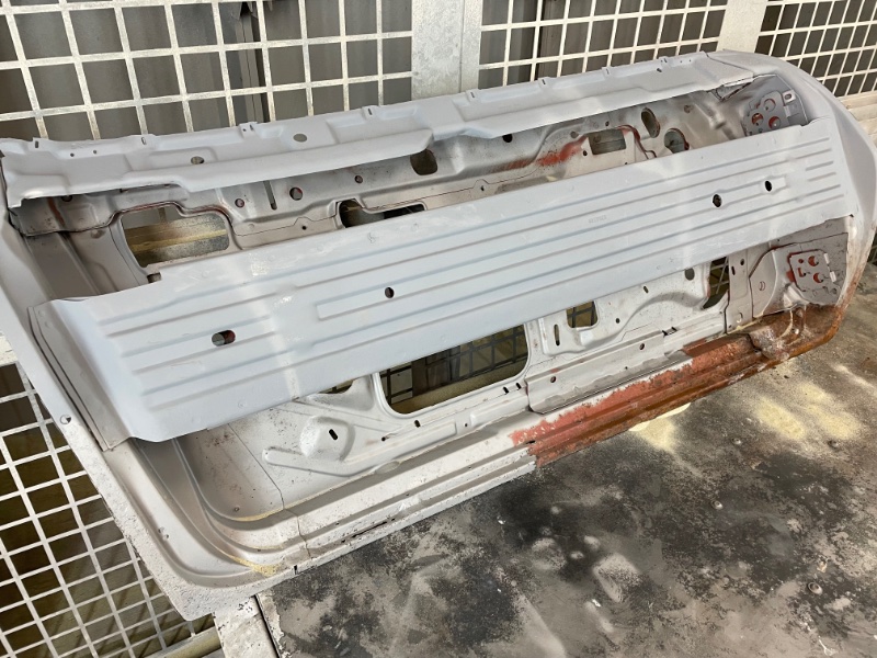

Been busy
Started the Right hand door
And managed to get the floor in primer

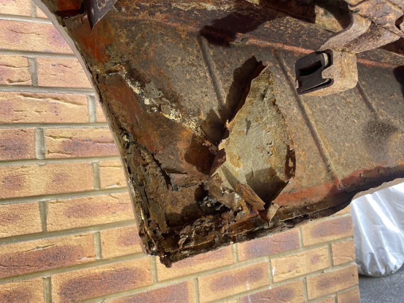

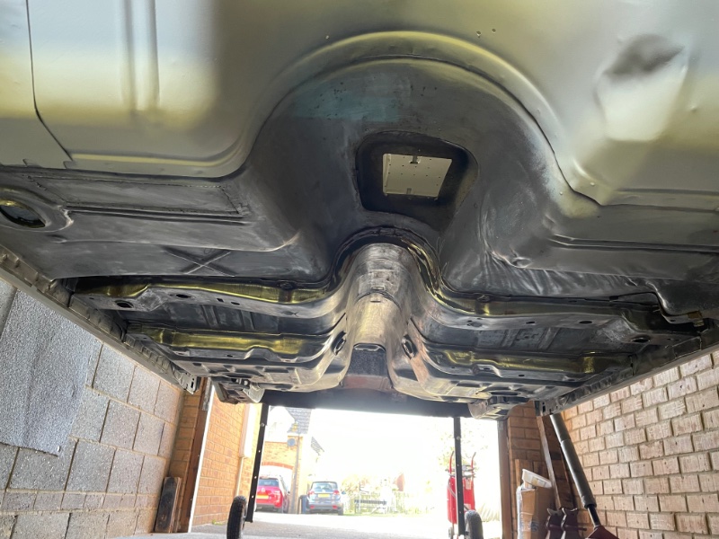

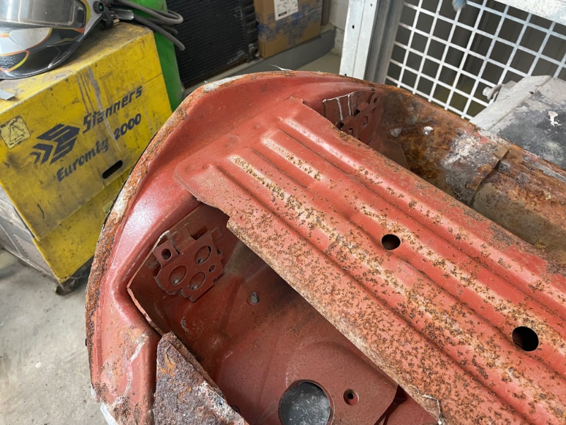

Spent yesterday on me back trying to clean the floor rear section, the trunk floor is perfect but I do have flakey corrosion to the rear rails and over the axle areas
This is extremely difficult to remove, combination of local blasting and electric wire wheels etc,
Very hard on ones body,
But I’ve done about 75% now so one more day should see it ready to epoxy,

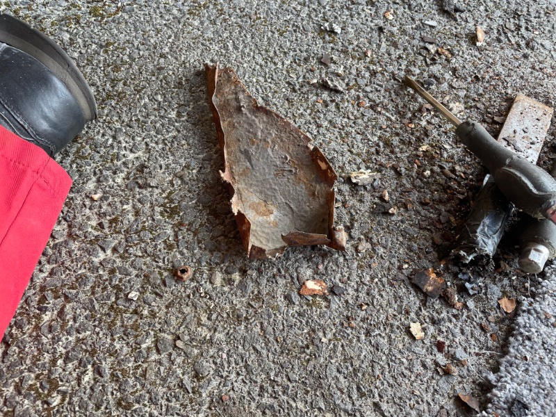

Got a nasty bit of pre repaired rust to the right hand rear drop off, crappy 80’ patch repair etc,
So will chop this out and fabricate a new panel,
Both my Lower outer drop offs have rust damage so I’ll replace with new material when I finally get around to doing the rear quarters,

Nice work. Shame about that dodgy repair section though but it could be worse and thankfully you have the skills to make it good again!
Yes it’s completely normal to see this type of bodge,
10 year old car , not worth much so just get it patched up
Most of the damage to the body is were the shell was prepared with a angle grinder,
Just how it was back then,

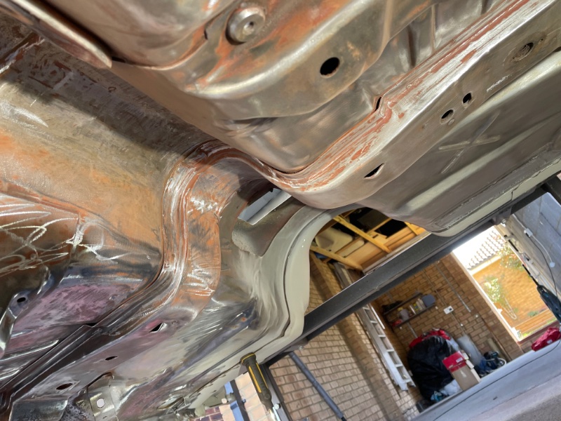

Very hard work removing corrosion from the metal
When ones got gravity to cope with !
Also extremely difficult to local blast upside down,
Still I keep nibbling away and it’s definitely becoming cleaner ,
This is were a full blown blasting or full acid dipping score,
Both have there own issues, with acid having consequences that can prove damaging at a later date

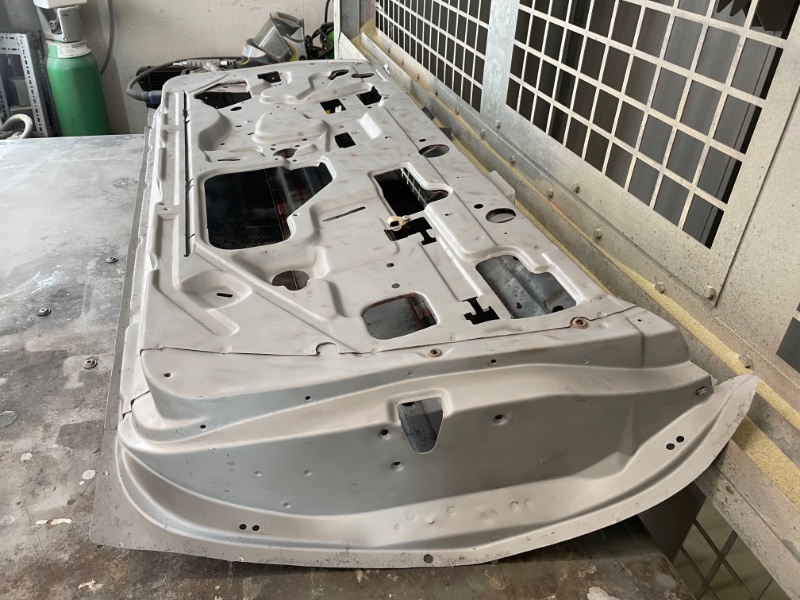

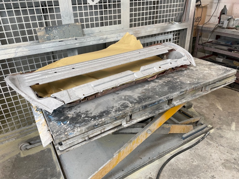

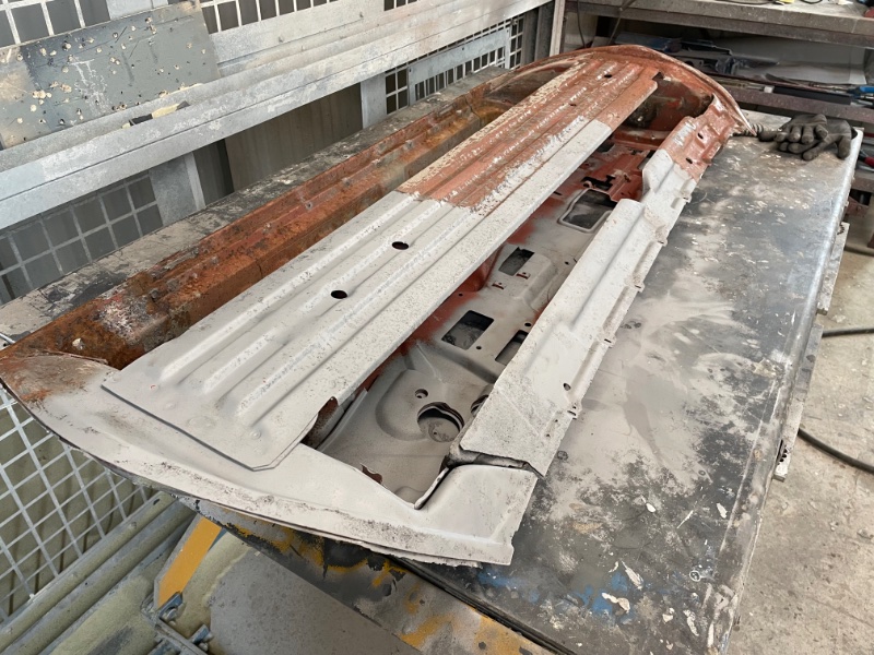

Finally finished cleaning the right hand door shell
Got some acid on a couple of difficult areas to remove,
Then epoxy and reskin ,
