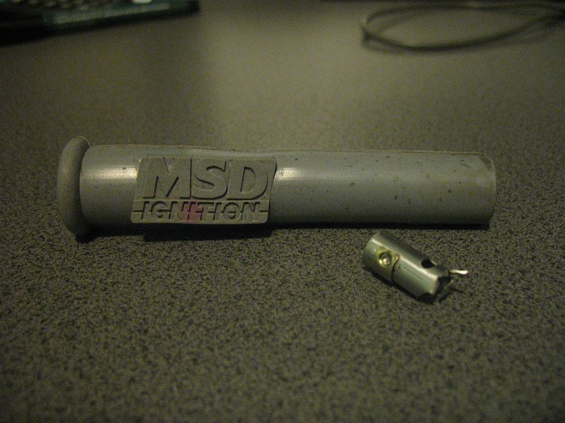

Bloody MSD plug boot broke. :x
Same #3 cylinder as the pushrods bent on. That is one unlucky cylinder.
Found a spare right-angle boot tonight though. :thumbright:

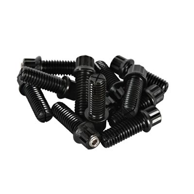

http://www.summitracing.com/parts/PHP-20003/
Split lock bolts! The expand against the hole.
If that is where i am leaking from those should sort it out.
Going to have to check i can actually get a hex key in on all the bolts heads though. I suspect not.

those split bolts might leak through the splits :( but its worth a try or the other option is to get the head repaired :(

Dave wrote:http://www.summitracing.com/parts/PHP-20003/
Not seen those before, could be a handy reference for the future

rickster wrote:those split bolts might leak through the splits :( but its worth a try or the other option is to get the head repaired :(
They are only split at the ends so should be OK. I would pack the whole thing with silicon anyway.
