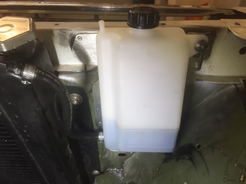

Re: Blue's Valiant
Ever since I put the crossflow Radiator in the car I've had an issue with keeping the water in it at a constant level, It always seemed to need topping up. I finally got around to properly investigating it last week, a pressure test showed a small leak on the bottom hose which I nipped up, that made no difference. Thinking a bit more about it I decided it should probably have an expansion tank, a mate turned up with one he'd saved from a John Deere buggy he had scrapped. I piped it up and filled it to the second mark and filled the rad right up to the cap. When the engine is hot it half fills the tank and when it cools down it gets sucked back into the rad and the level returns to the second mark. This seems to have done the trick and the mechanical temp gauge seems much more sensitive now which is nice....
Posts: 1446
Re: Blue's Valiant
good idea with the expansion tank/bottle blue. if you wanted to 'hide' it a bit in the past i've masked a 1/2" strip top to bottom and painted them black. they don't look so modern then but the strip lets you see the level still. :thumbright:
Re: Blue's Valiant
Good idea, I need to do this. Just have to find a suitable bottle....
Posts: 14502
Re: Blue's Valiant
There are plenty of aluminium ones on eBay if that floats your boat...

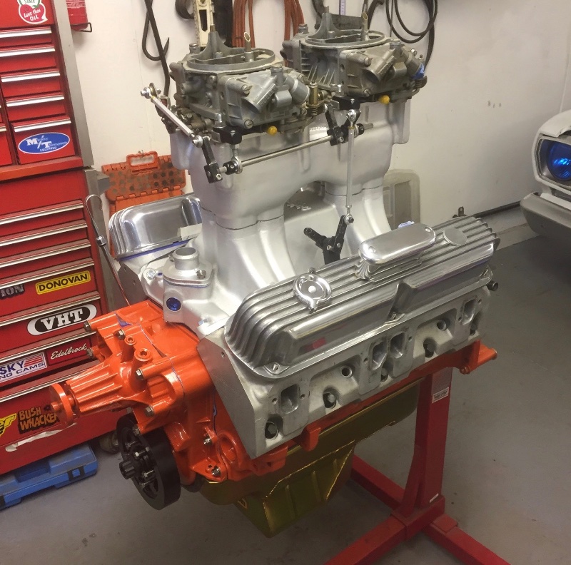

Posts: 14502
Re: Blue's Valiant
So there it is in all its 70s gloriousness, about time I got my finger out and got it in...
Posts: 1678
Re: Blue's Valiant
That sure looks impressive :rr: :rr: :rr: :thumbright:
Re: Blue's Valiant
Proper old school cool !!!
Well done Blue. Outstanding work \:D/ :thumbright:
