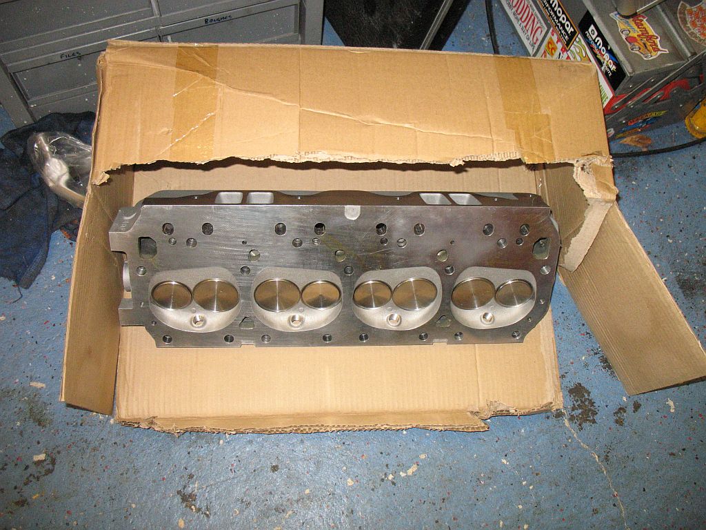

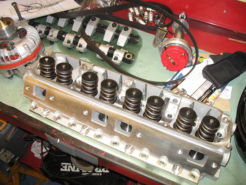

Well the car may be sold in principle but I still have to fix it and make sure it is running well for the new owner. It's the least I can do.
So it will be off with the old ported iron heads and on with a pair of stealth heads. These will be used in "out of the box" condition as they flow as much like this as my old ported heads.
I will only be fitting the matched valve springs for my camshaft and lapping the valves in. The rockers will need a little adjusting on the shims to center them exactly on the valve tips and I will need a new set of spark plugs as these heads require long reach plugs.
The big job will be removing the pistons and having the quench domes on the piston tops machined down. I can't remember how far they protrude above the deck but I need them to be flush with the deck so that with the gasket in place I will have 40 thou quench space in the head.
