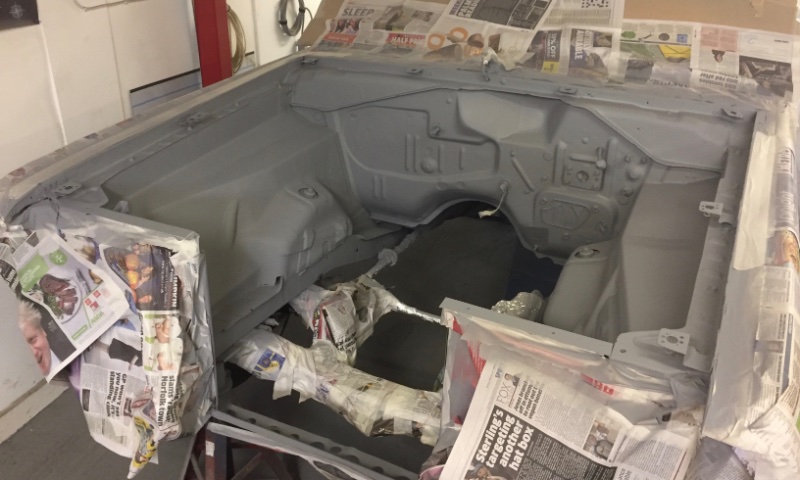

This is dragging on a bit but I'm now in primer...
lough3969
Posts: 882
Location: London
Re: Blue's Valiant
Post by lough3969 »
over the worst bit then... looks bang tidy!

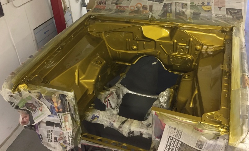

Posts: 14545
Re: Blue's Valiant
As Spandau Ballet would put it, GOLD!
IMG_0292 (1).jpg (146.96 KiB) Viewed 2994 times
Posts: 7563
Re: Blue's Valiant
Looking good mate, is that after the laquer.
Posts: 1549
Re: Blue's Valiant
Great colour, is it the light or is that like Aztec gold (a greeny gold from memory)?
Neil.
Posts: 14545
Re: Blue's Valiant
It does have a green tinge to it but not as much as it looks like in the photo.
Posts: 1549
Re: Blue's Valiant
Either way it's a very nice colour :thumbright:
Re: Blue's Valiant
Proper colour. Nice work Blue 8-)
Posts: 3665
Re: Blue's Valiant
Mmm, like that 8-)
deppmobile
Posts: 137
Joined: Mon Oct 03, 16 4:00 pm
Re: Blue's Valiant
Post by deppmobile »
Lush!
Is that cellulose or 2 pack?
Posts: 14545
Re: Blue's Valiant
Its 2 pack using Screwfixes finest £34 gun...

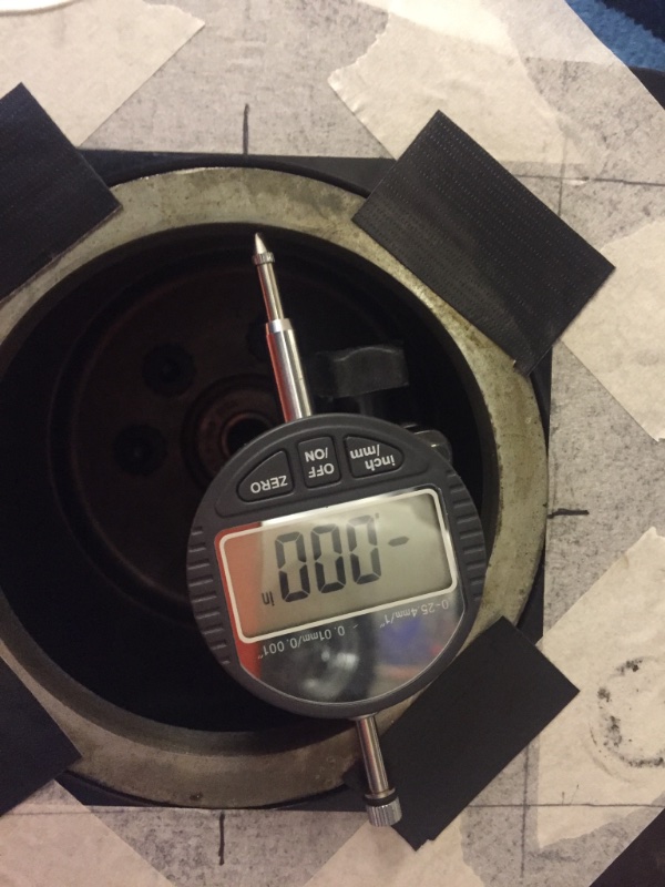

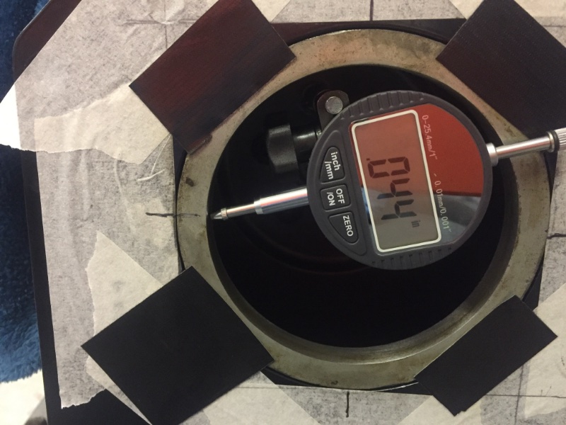

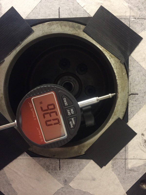

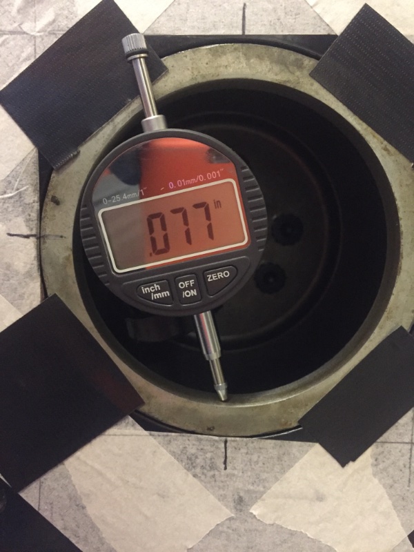

Posts: 14545
Re: Blue's Valiant
The great American aftermarket strikes again. Clocking the quick time bellhousing centre bore before final engine installation. I'm checking that when installed the transmission input shaft will be in line with the crank centre line, any more than .005" off will result in clutch and or bearing problems. Offset mounting dowels are available to move the housing to correct misalignment, but this is too far out for that option. Hopefully Trev D will be able to make an offset centre bore adaptor otherwise a new and expesive component is basically scrap.
