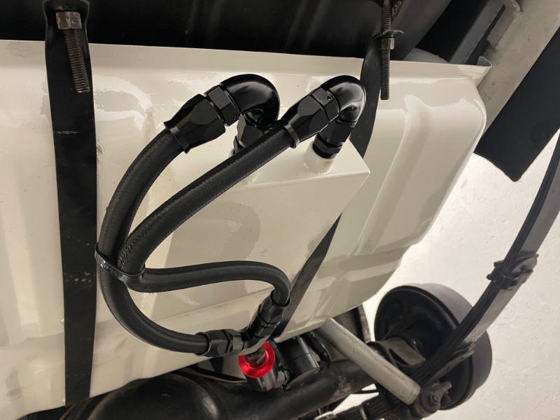

Redid the rear lines with full flow fittings, might have to try a 90 degree on the right to get rid of sharp turn in that line.

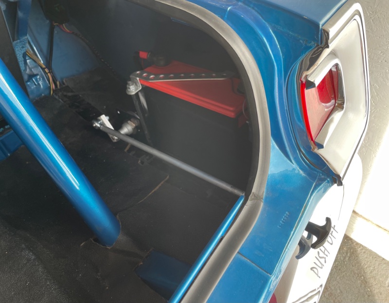

In my continuing effort to get my car MSA legal for super stock I fitted a battery cut off switch with an external shutoff. Barracuda’s have a gap under the boot lid above the bumper so an ideal place to run the rod through. Just need to run a new alternator lead through to the switch so it cuts the engine as well.

Don't forget the Mandatory MSA-compliant Shut off Sticker!!!

Re: Blue's Barracuda
I bloody knew you’d mention that!
Keeping you honest!

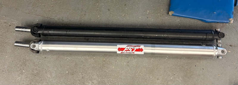

PST aluminium driveshaft with Mark Williams billet yoke. Hopefully 5lb of rotating weight saved should get me some improvement no matter how small…

Now that’s cool! 😎

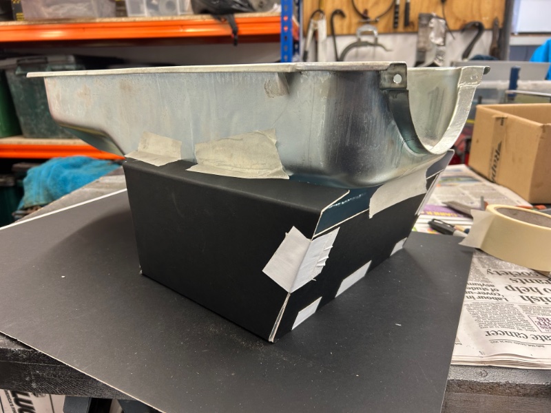

I bought a Moroso pan which had the 8 quart capacity I wanted but it was deep which concerned me give the cars startiine antics. Months of research found there wasn’t an off the shelf pan with the capacity but not as deep. I also wanted to keep the oil away from the crank to cut down on windage so building my own is the only way. First job was to cut the pan to the finished depth so I have something to work from.

Next, after some measuring I folded up some cardboard to see what I had space for. Calculations work out at just over 8 quarts with the full level around an inch under the crank, the level will drop as RPM increases. So thats the finished template, need to get some metal next and start folding.

You can't beat a bit of good old CAD.

Stu Twin wrote: Mon Mar 23, 26 1:15 pm You can't beat a bit of good old CAD.
:lol: :thumbright:

Love a bit of cadboard…
