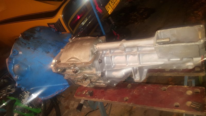

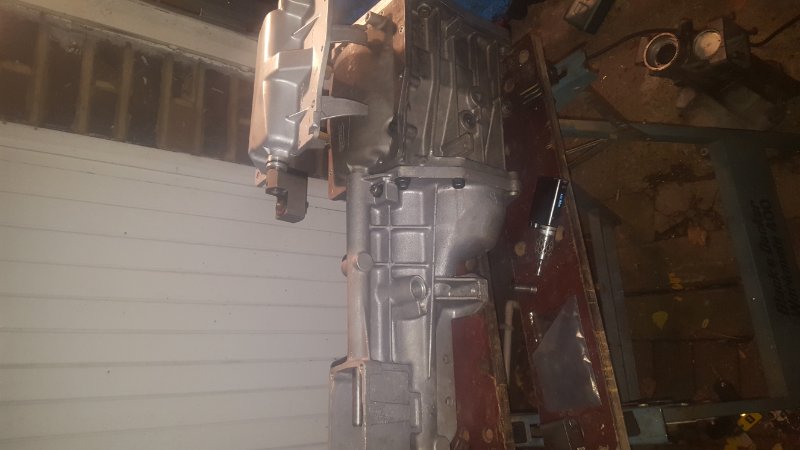

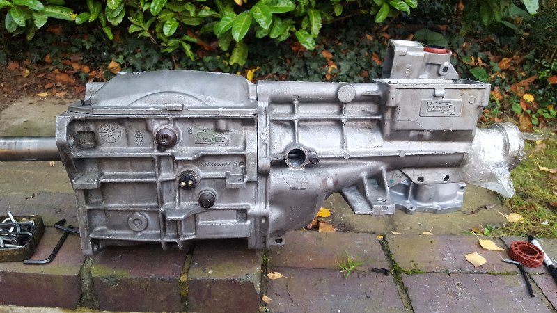

haven't updated this in years.
new motor in, out, in, out, in.
rebuilt close ratio 4 speed in out in.

OK i have been messing about planning a T5 conversion. I Fancy a 5 speed. But don't want to cut the floor or cross member.
This might fall into the too hard category. but he who dares etc.
Got the T5 via a Ron Fenton delivery last year
1999-2004 ford mustang T5 i.e a tremec xxxx-xxx-260
stupid overdrive ratio of 0.63, but thats why its not ford sierra money
This box got the longer input shaft length like the ford racing box of the mid 90s
it also got the better alloy gears and full roller bearing set up from that box
it foregoes the pocket bearing input shaft. (not bothered its a 300 ftlb box and my original TR4 4 Speed was ok rated at 240)
but gains a reverse idler brake and better synchros on 5th and reverse
its has a electronic speedo tone ring right up near the main case and the hole for the pickup is perpendicular to the shaft.
Things to overcome first
1)I Need a mechanical speedo. I refuse point blank to pay 300-400 for an electronic box when plastic gears cost $25
2) Need mechanical speedo tailshaft housing. the hole in the ford one is direct into the shaft not angled over or under it for gear drive
3) After a mock up alongside a standard 4 speed even more obvious was the need for a mechanical speedo tailshaft housing with the stick in better position, The mustang one wants to go through the cross member hump and to complicate matters it needs the correct machining inside for the reverse idler
4) need bellhousing, want to keep standard clutch arm , so need standard bell and adapter
5) Adapter needs to site the input spline in right place for driven plate, the input shaft spigot in right place for spigot bush and to some extent stick and mount in right place.
6) input bearing retainer might need cutting down.

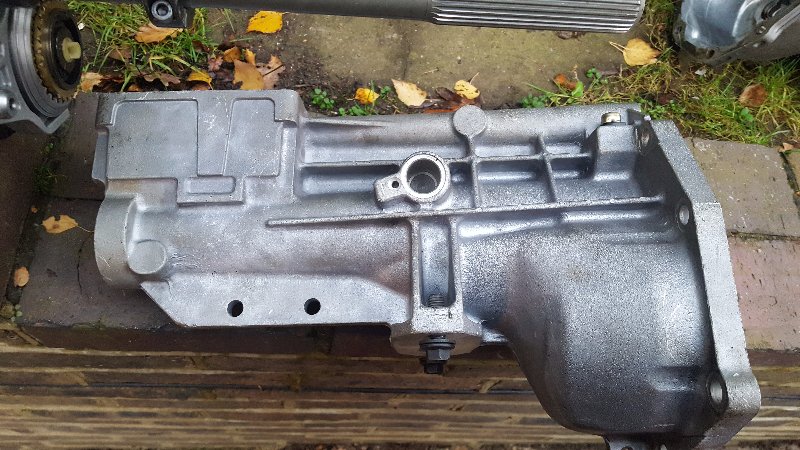

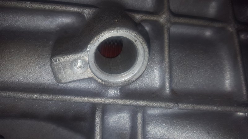

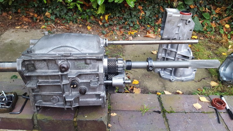

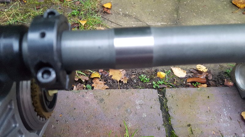

Anyway, I made a start by pulling off the tailshaft housing to see what was what in respect to speedo drive.
Discovered that the output has the fat bit where the mechanical speedo gears would have gone on earlier versions.
to the left right up behind 5th is the current reluctor tone ring for the electric speedo in the mustang.

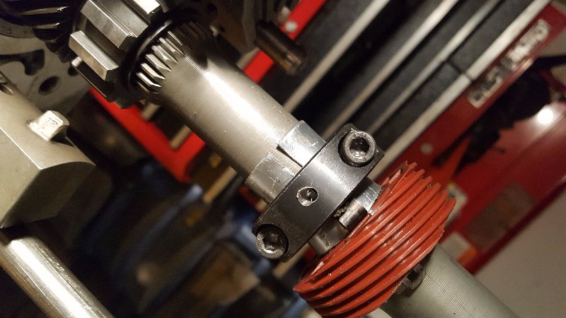

I got a 28 mm double split shaft collar, drilled it to use as a fixture to assist with drilling the shaft 1.5mm deep for the speedo gear clip
My best drill bit is now dead. Shaft showed no impact. You just can't drill hardened steel at home....
So a new solution was sort
Shaft collar holds 0.9mm metal shim with a section cut out with a tab that fits through the retaining clip for the gear
clamp the sleeve and the gear can't move , held in the normal way by its retaining spring, and my heath robinson clamp holds that spring to the shaft. hopefully job done.
You can buy a kit in the US to do this but £10 spent with bearing-boys provided much the same solution
note also a rubber bit around the shaft pushed right back to the left in one of the pictures.
These gearboxes were supplied pre filled with oil. That rubber bit sat on the very end of the output shaft spline sealing the output shaft to the output seal and stopping the oil falling out. On first install of the yoke it gets pushed back into the trans and lives there from then on. handy....
next move is to get the new tailhousing on.. prove speedo drive works, mock it up with bellhousing on the back of a motor to work out

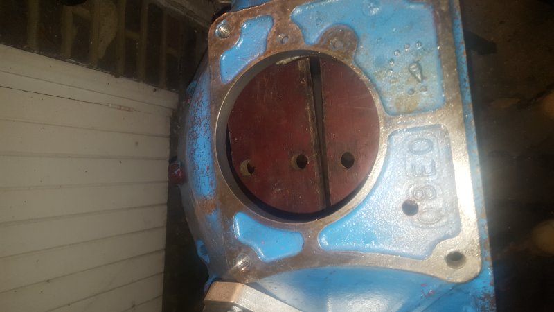

1) where the clutch will sit in relation to the input spline
2) where the spigot bush needs to go, ideally into a roller bearing conversion stuffed in the torque converter register in the middle of the crank hub
3) then work out thickness of the adaptor. followed by a trip to either Trev D or an engineering shop in watford for a steel adaptor plate.
might have to invest in one of these
http://store.uscartool.com/67-75-A-Body ... p_141.html
looks the buisness, and comes in bits for custom assembly.
anyway more in a few months
when i get round to it

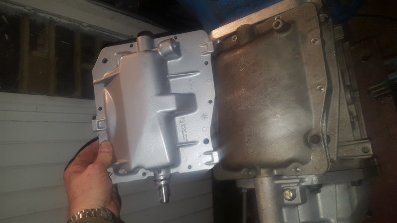

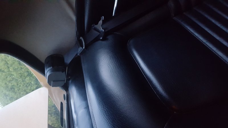

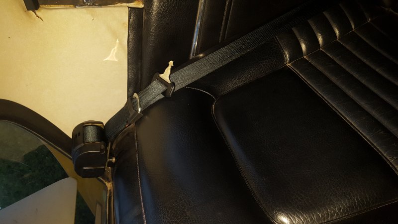

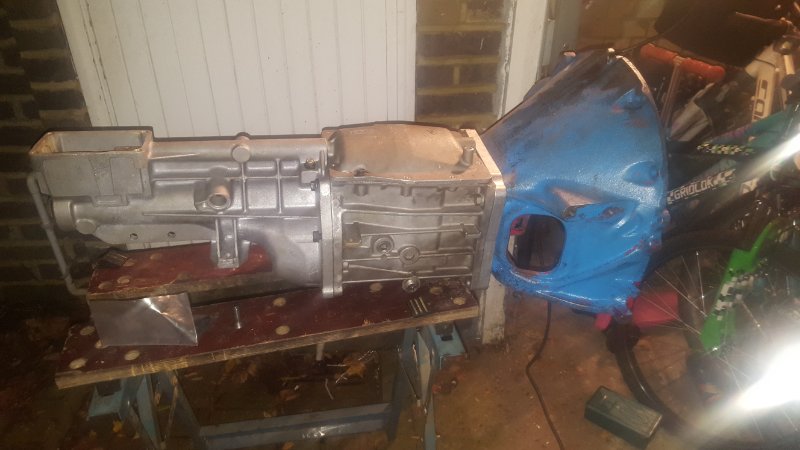

well i have done nothing with the T5 other than get the bellhousing adaptor bolted on to the housing.
so instead i fitted some seat belts in the back.
purchased a set of 80s Kangol parcel shelf retractors about 8 years ago and left them to get dusty on a shelf
these are seat belts that only work when bolted to a horizontal mount not vertical
they come with a double free-end anchor so that a loop comes down the seat back to act as an adjustable top drop link for the cross body belt
I had previously tried to fit them just after purchase only to discover something that with hindsight was quite obvious
cars with upper mounts for fixed seat belts have them tucked up tight in corners becasue they don't need to cater for a massive inertia real....
hence i'd guess most mopars of the era that got mounts but no belts will suffer the same problem.
My original fixed belts were so UV damaged that their original black had faded to purple and beige. i doubt they would have actually done anything useful and following the aussie standard the buckles and webbing were, as far as i was considered inferior to our british standard belts of the time.
any way after a long search i found these
https://www.moss-europe.co.uk/bracket-a ... 514-5.html
a reasonably kick-ass solution to the problem
an afternoon of swearing followed and this is the result.
look a bit incongruous but i have sat in the back and thrown my self into the belt with force and my face only gently hit the headrest.
apologies for poor photos it was getting dark and i'd used my phone battery for the light so i could see what i was doing
next move full set of kangol reflex as per UK import Mopars from oz...in the front
just need these to arrive
https://www.hemiperformance.com.au/shop ... -link.html
dismantle my new belts down to the nuts and bolts to get the free end through the loop and rebuild em
drop links handy for 2 and four door hard tops and coupes
or indeed anything with the upper belt mount in the roof rail rather than in the B pillar
stops yer ead gettin cut orf....to put it bluntly

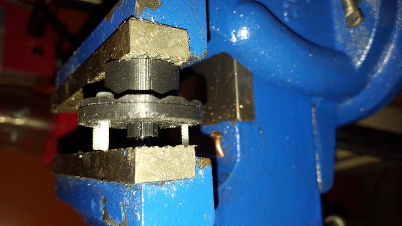

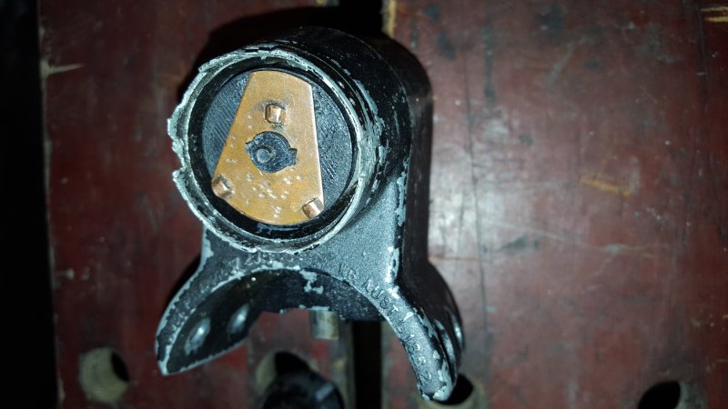

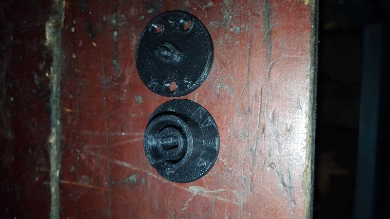

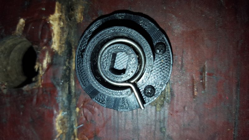

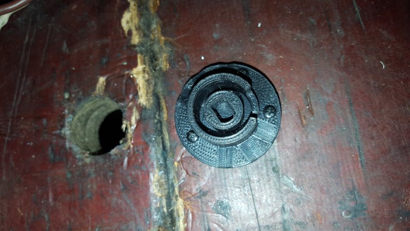

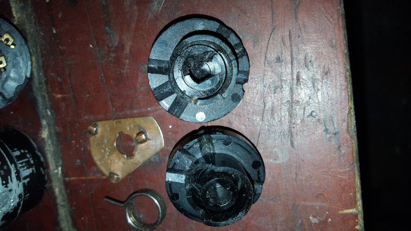

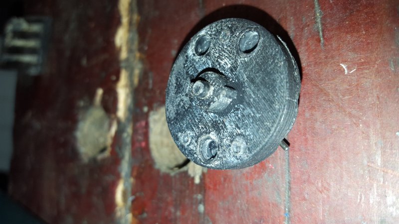

and I've had some stuff plastic printed for fixing aussie ignition switches. but it is top secret until i check it works...I might do that tonight.

adventures with bits of switch.
Aussie ignition switches VH- CM usually fail due to the main plastic part cracking and allowing the contact to short out on the case melting the springs and causing a fire.
the plastic part has many functions
1) needs to fit onto the end of the drive from the lock barrel which is a rectangular shape with slightly bowed sides
2) needs to have 6 indents in the top side so that ball bearings can act as detent balls for switch positions
3) needs a 3 step spring guide to clamp spring and leave space for spring arm to engage with housing. needs back stop to stop switch going too far back when steering lock position is chosen
4) main body needs to be right diameter and thickness
5) base needs 3 4.2mm holes for springs
6) base needs offset drive for copper contact
7) base needs spigot on the bottom to engage with switch base centre
8) plastic part must move up and down in housing to allow steering lock PRESS to engage function so can't be too thick.
plastic printing can't really print a part easily that is narrower at the base than the middle
easiest option was to get it made in 2 parts and glue it together
material is as hard as bakelite but a little more flexible. i.e unlikely to crumble
seems to work ok
will probably see if any aussies want some and get some more made
switches are otherwise $150-200 which for an ignition switch that is just as likely to fail as the one you just broke seems a bit steep.
could not have done this without my mate paul photographing and manually measuring to make up the 3d model...
none of these switches made since about 1978. company bankrupt and the switch is unique to CAL

- spare getting screwed and glued
- assembly.jpg (57.62 KiB) Viewed 3881 times
- checking it fits and turns and the spring doesn't break the new part
- installed in housing.jpg (35.41 KiB) Viewed 3881 times
- main switch contact sits like this and floats on springs
- contact fit (2).jpg (57.88 KiB) Viewed 3881 times
- complext shape
- new bit showing offset drive.jpg (71.23 KiB) Viewed 3881 times
- groove for spring modified to keep it aligned better under tension
- new bit showing spring fit.jpg (76.04 KiB) Viewed 3881 times
- 3D printing can't print the shape as 1 part so i needed to make it in 2 parts and glue it together. screws to help . None of this can be metal due to shorting out
- new bit glued and screwed.jpg (76.43 KiB) Viewed 3881 times
- Printed by makeitquick.com
- new printed bits.jpg (66.51 KiB) Viewed 3881 times
- one i repaired earlier with experimental plastic part
- repaired igition switch.jpg (54.78 KiB) Viewed 3881 times

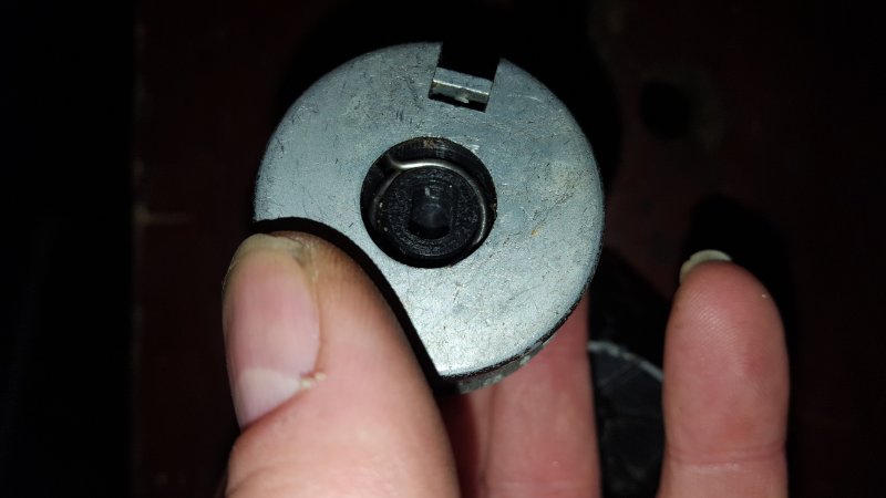

- Aussie switches fail by cracking this drive/spring part
- cracked bits.jpg (82.87 KiB) Viewed 3881 times

T5 Fandango
Got a new tailhousing from Oz. its off a holden and has a ford shifter box in the reverse position
speedo drive on opposite side from all others but as can be seen my heath robinson speed gear fix seems to have them in the right place
1) needed an adapter of correct thickness
2) needed an adapter the covered all bellhousing and box flange mounting holes
3) needed an adapter with a centreing spigot that was the same or just a bit bigger than the hole in the standard bell so that any boring did not encroach on the clutch fork mounting bolt holes or breach the low top/back of the housing
achieved 1 and 3... anything that covered all 8 holes without any sharing the same space or banging into any pre drilled holes for the adapters proper application were either too thin or had a bellhousing spigot so large that my bell housing would no longer be viable after boring
took the cheapskate option space for 3 bolts and a workable sized spigot.
drill and thread 4th hole and hope all is well
need 4th hole counter sunk for the flat head bolts. so will need to come apart ande visit a machine shop. i don't have a big enough drill chuck for the size of tool necessary to counter sink these holes
used unbrako bolts so should be pretty tuff
next move
1) finish adpater
2) bolt bell to standard gearbox and mark out points of interest along the floor. i.e cross member/ mount etc
3) put bell and adaptor onto T5 check against marks on the floor
4) work out what needs doing next to get box into car without having to cut any bits off the car
5) cut bits off the box instead
purchased new top cover, lower profile. comes off a chevy s10 world class box
purchased off set levers might be handy
purchased a few shift rails for cutting up ...
next move
1) finish adpater

- new top.jpg (42.5 KiB) Viewed 3878 times
- speedo sorted.jpg (58.46 KiB) Viewed 3878 times
- assembled bell and box.jpg (56.81 KiB) Viewed 3878 times
- bellhousing.jpg (51.03 KiB) Viewed 3878 times
- bellhusing adapter.jpg (42.42 KiB) Viewed 3878 times
