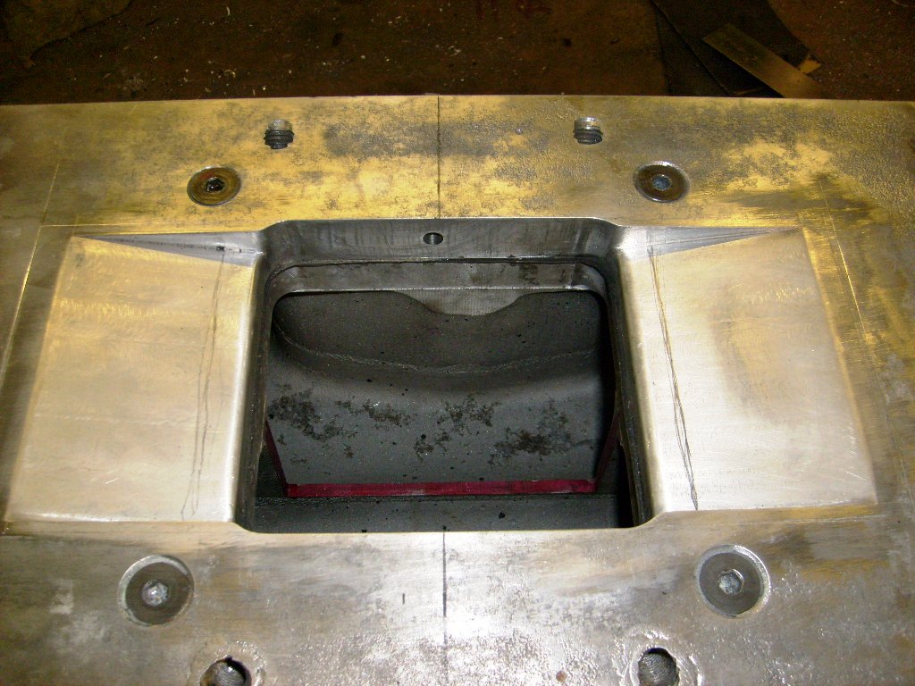

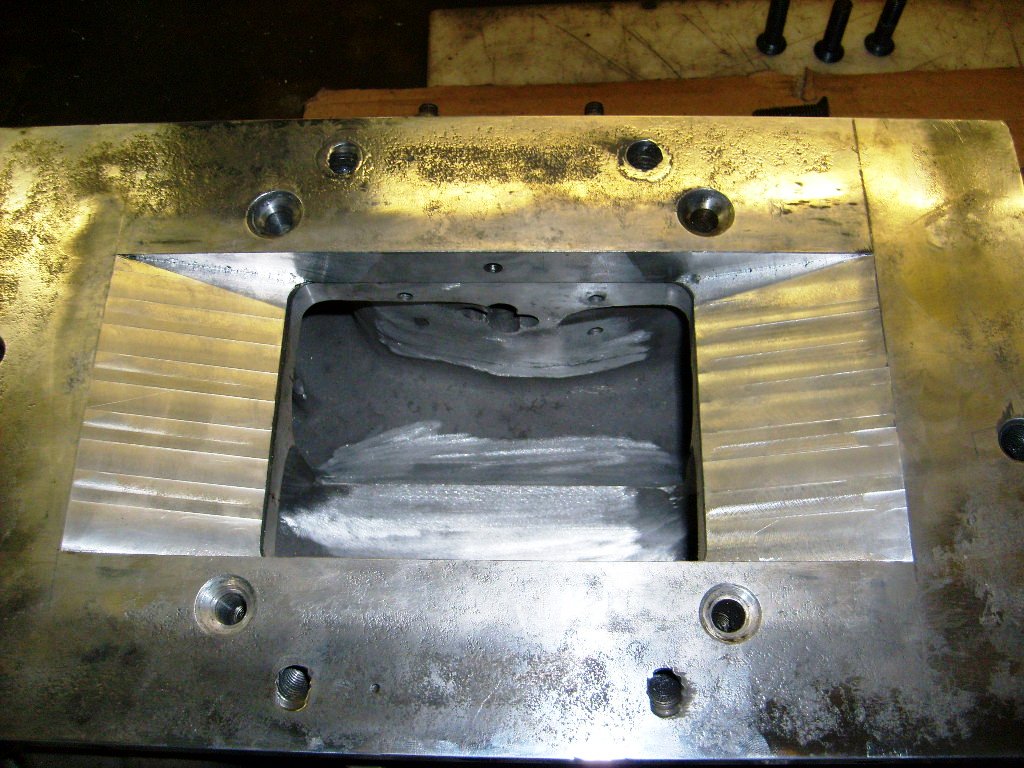

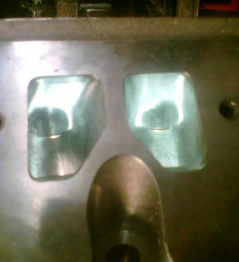

1st pic shows supercharger transformation plate as was fitted on my last run. The plate intake has now been opened out on a milling machine ( with intake still attached ) to increase opening by approx 20 % : longer, wider and a more exagerated taper into the intake. Areas marked with a red felt tip are all solid obstructions to smooth airflow.
2nd pic shows these areas marked red reduced to smooth low arrow like shapes. You can also see how much bigger the supercharger outlet is now.

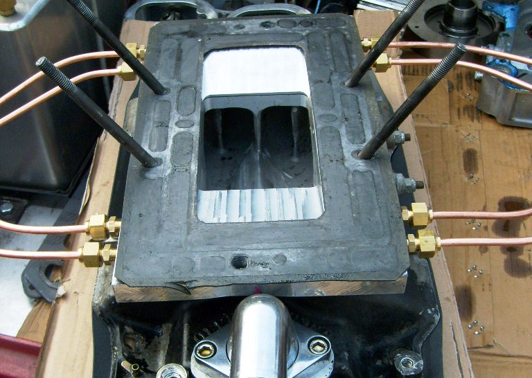

3rd pic shows side of transformation plate now drilled and backfilled to form a series of interlaced circuits through the centre of the alluminium. Via a low temperature dx refrigeration system I will be aiming to drop the whole plate to approx -15 c to create a supercold intercooler. The refrigeration system has been sized to give me 2 minutes use only so should be enough for burnout box and the run. This should significantly increase the efficiency of the supercharger and engine.
That`s the theory ... we`ll see [-o<

Part of the refrigeration system going in.
The system I`ve built runs on dc voltage between 8 and 53 volts and weighs less than 10lbs.
It is not driven from the engine so don`t have any hp loss to overcome
:read2:

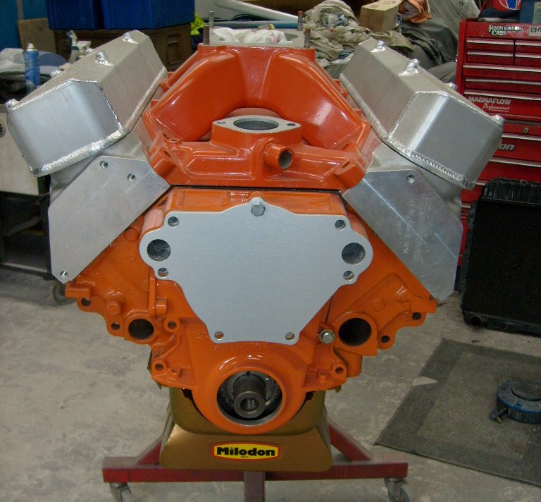

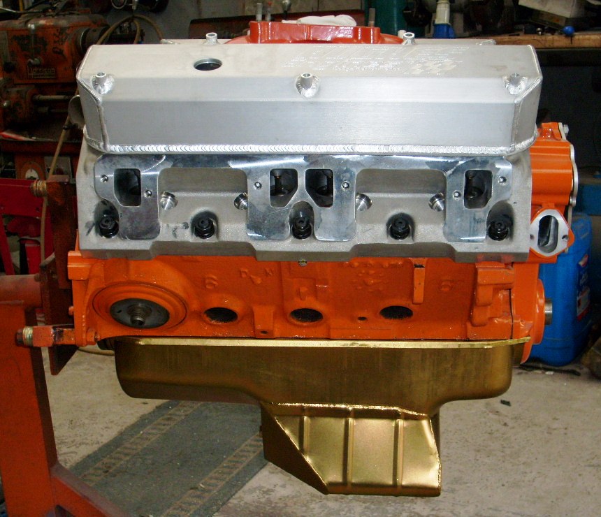

Have decided to pull the 360 blower motor out as I`m not happy with some aspects of the build and think I may be pushing my luck trying to get a motor I do not know the history of to run a 10.
I am putting the blower / pulleys / carbs / intake to one side and will be building a R3 blower motor from scratch with proper bottom end, steel crank, Indy 360 / 2 cnc ported heads and super strong low comp rotating assembly, blower cam, solid lifters. Should be able to get 700 ish hp ??. This will be a long term build and is likely to take 1 - 2 years to complete. Had toyed with fitting an R5 Nascar used engine but again, you don`t know what you`ve got til you use it and trying to replace custom parts would be a nightmare.
In the meantime, Dave Billygoat has nearly finished my 408 so will be fitting this together with 4500 torque convertor and refrigerated intake very soon which should see 10`s ???
( pics below )

Finally got the pushrods today. I think Dave has tried Comp Cams, then Smith Bros, and now Canton.
Billydoo`s gonna fit them and hopefully we can get the thing on the dyno next week
300 HP here we come :lol:

Jon Connolly wrote:Part of the refrigeration system going in.
Can I ask what you are using as a compression and expansion device.
Perhaps wrap the high-side around one of the headers and do without the compressor, assuming that you are using one ;)

Dusty
This is top secret mate, can`t tell you
But .... here`s a clue
http://de.refrignet.danfoss.com/Technic ... 00l622.pdf
Dunc ... there`s only one way to find out
