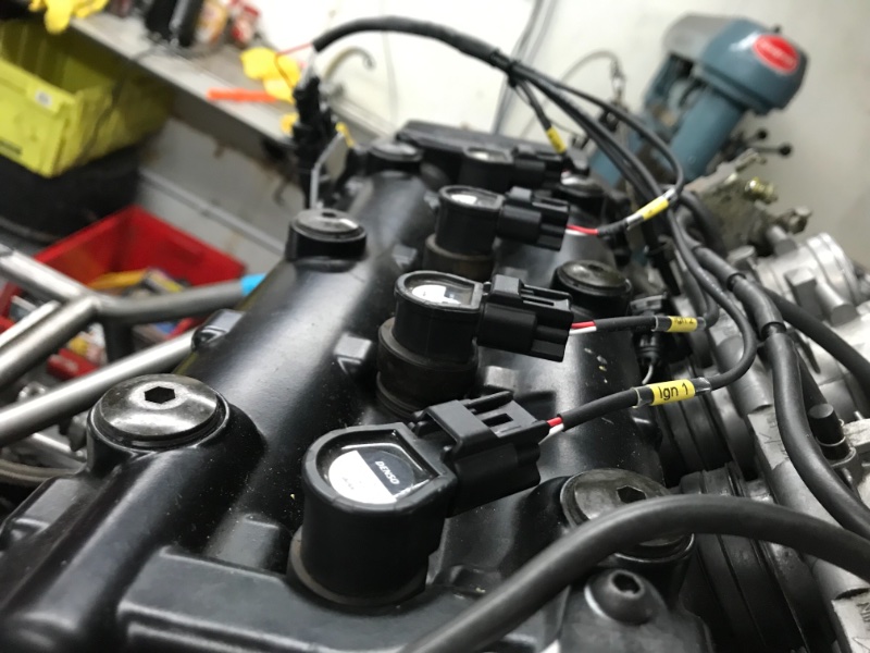

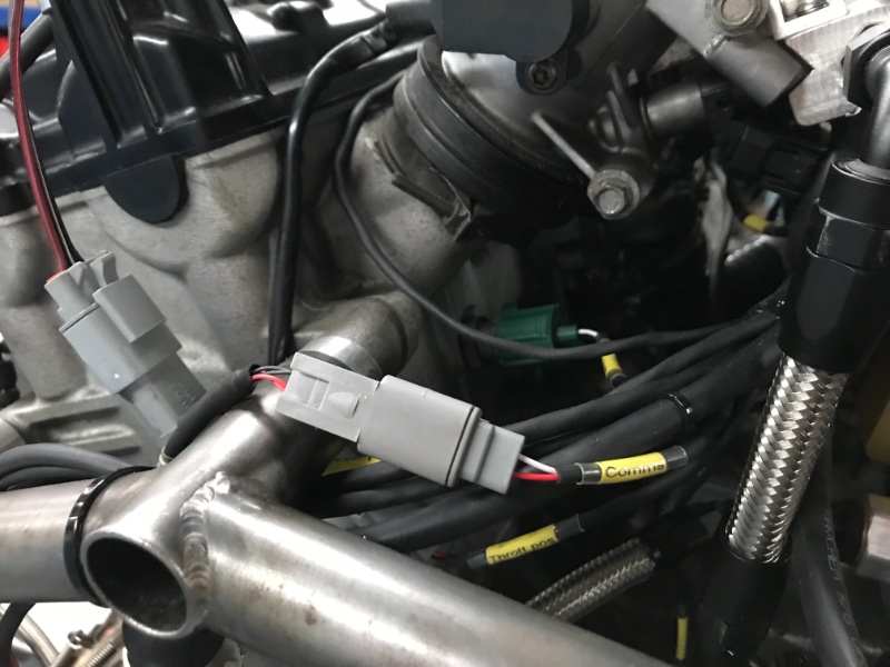

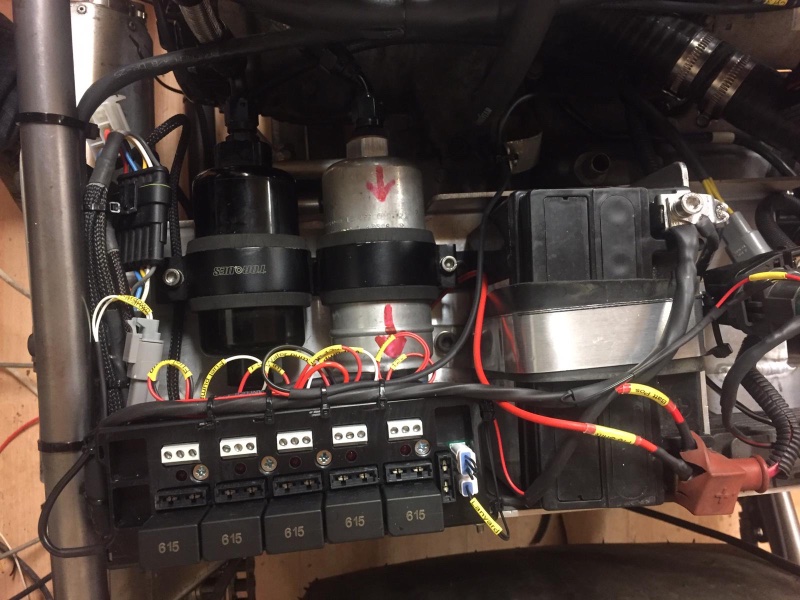

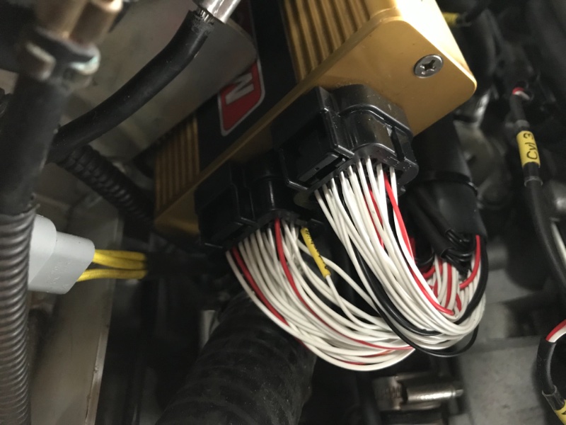

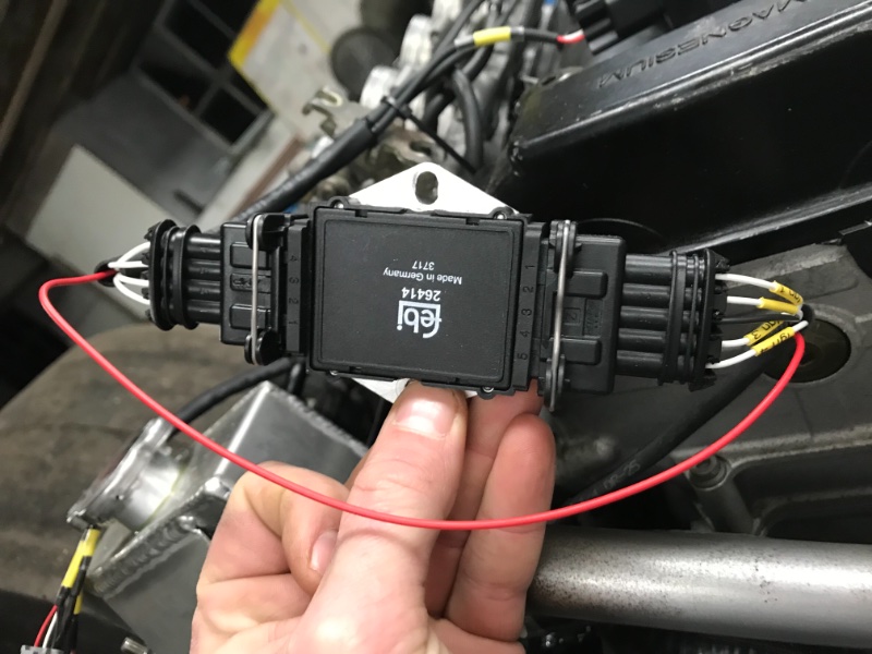

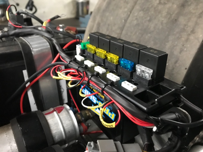

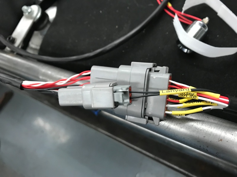

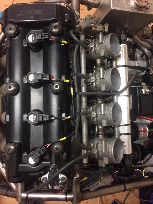

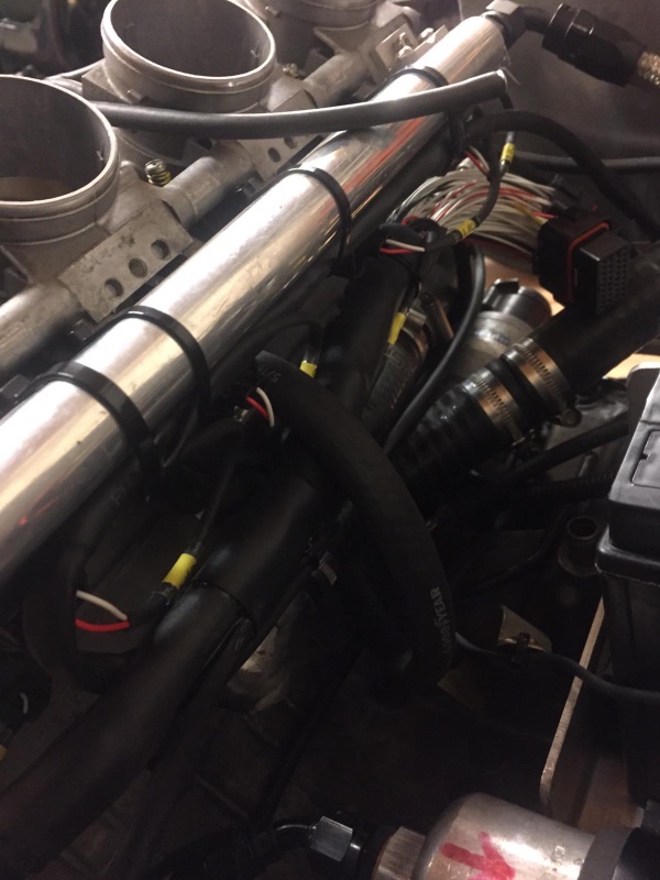

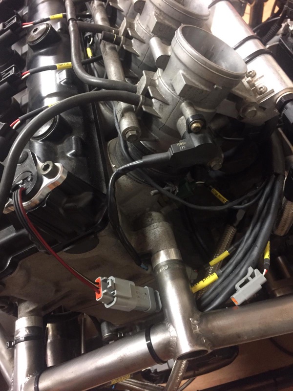

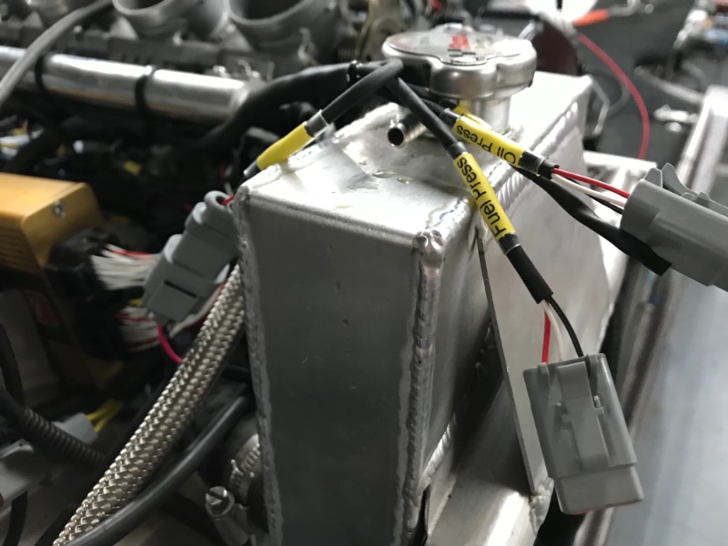

She fired up !!!
Might have to clean the injectors as I'm running alot of pulse duration but she is alive !!
