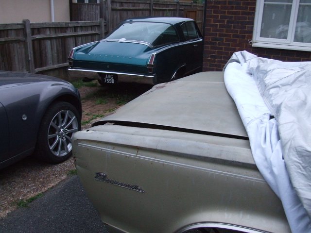

in the mean time. why just have one Barracuda when you can have two.
one has much nicer chrome that the other so i can swap parts around to make a nice cruiser and a the other a bit of a racy old nail.

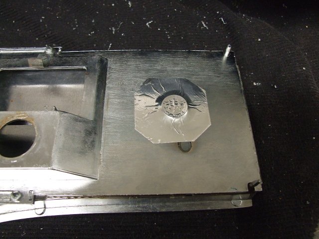

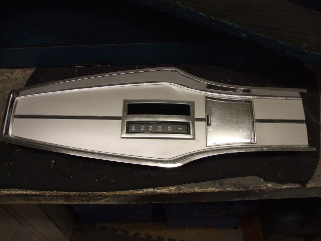

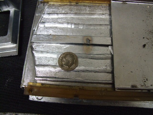

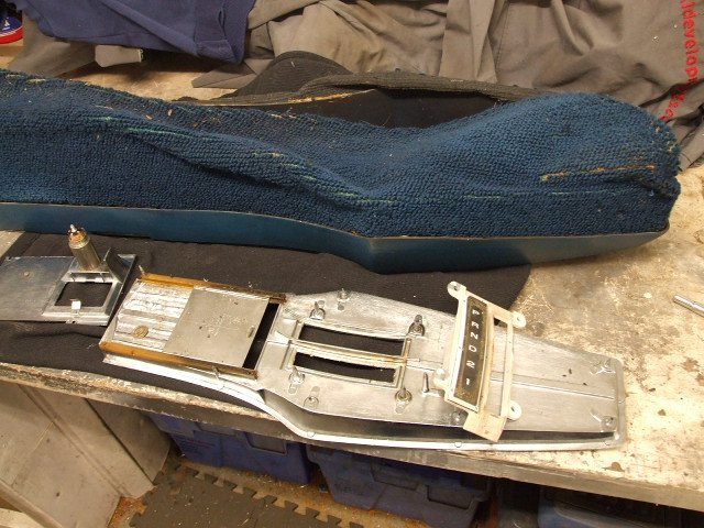

anyway. there was this annoying clunk when accelerating and decelerating which turned out to be the cover for the ashtray in the center consul.
traced to the plastic sliders being fitted wrong and now the lid has a nice friction to it.
found the obligatory American coin. Did you know it is Good Luck to have a coin in the car? i have seen some cars over the years with coins in places they could not have got there unless placed. one even taped to the back of the glove box.
anyway, i have taped the coin back in which will confuse the next owner when it comes apart.
