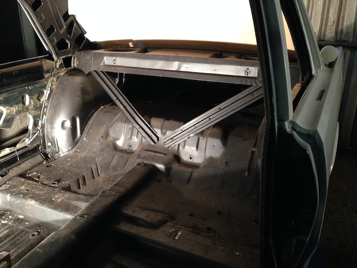

I always thought that those in-boarding kits went inside the Chassis rails completely so it was less visible, but from the picture it looks wider?
I suppose it is dictated by the spring width.......I guess the perches will have to be moved even further inboard than on previous occasions?

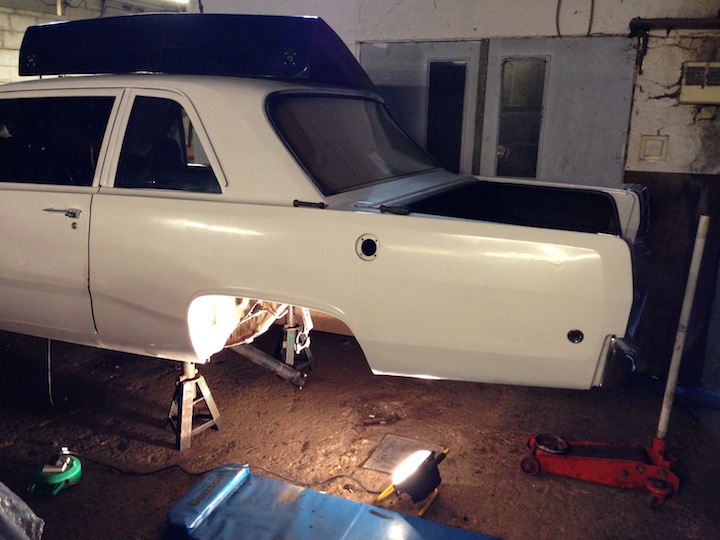

6am start and a 4 pm finish? you deserve to be knackered mate.
Looking realy nice Blue.
Those car lifts look like nice bits of kit.

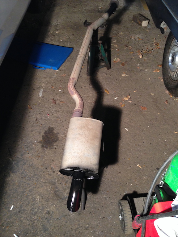

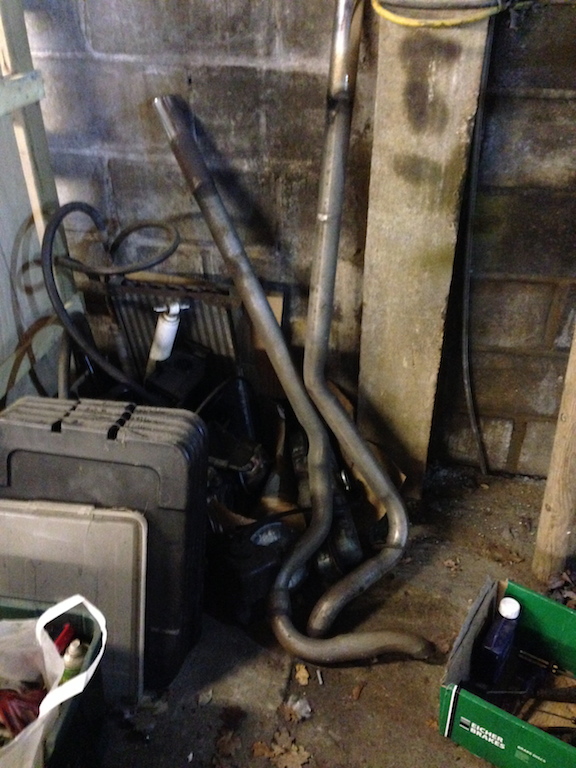

So, this afternoon's job, chop off the tailpipes, fit turndowns and a bung for my AFR gauge, sorted! If anyone wants the tailpipes for free, come and get 'em sharpish before they go in the iron. They are 2-1/4", well made and in very good nick, seems a shame to chuck 'em.
- IMG_0740.jpg (204.96 KiB) Viewed 2094 times
- IMG_0739.jpg (198.74 KiB) Viewed 2094 times

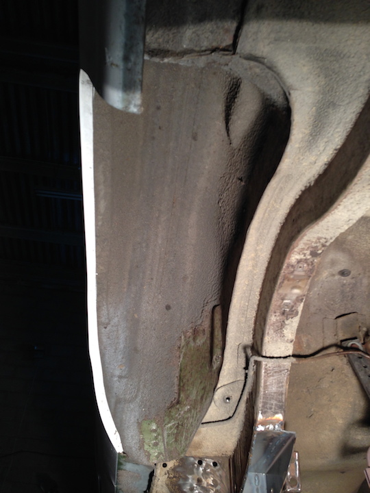

Next job, sort out the wheel tubs. For those that haven't done it before, this is a pretty major job, and even though I've done it a few times before it's not a job I enjoy. Fairly big strip down required, interior out, axle & suspension out, fuel tank out, rear loom out and deal with the brake and fuel lines that are in the way as well. You need to cover or remove the windows unless you like having small metal fragments permanently embedded in them when you unleash the grinder, I covered mine with thick cardboard.
You can see how narrow the stock wheel well is, what isn't apparent is how quickly it curves inwards just above the outer lip. This means unless the car sits pretty high, the tyre has to sit back into the arch a fair bit, not a look I like.
So, I'm all set to get cutting...
- IMG_0751.JPG (111.83 KiB) Viewed 1844 times
- IMG_0749.JPG (109.3 KiB) Viewed 1844 times
- IMG_0747.jpg (141.15 KiB) Viewed 1844 times
