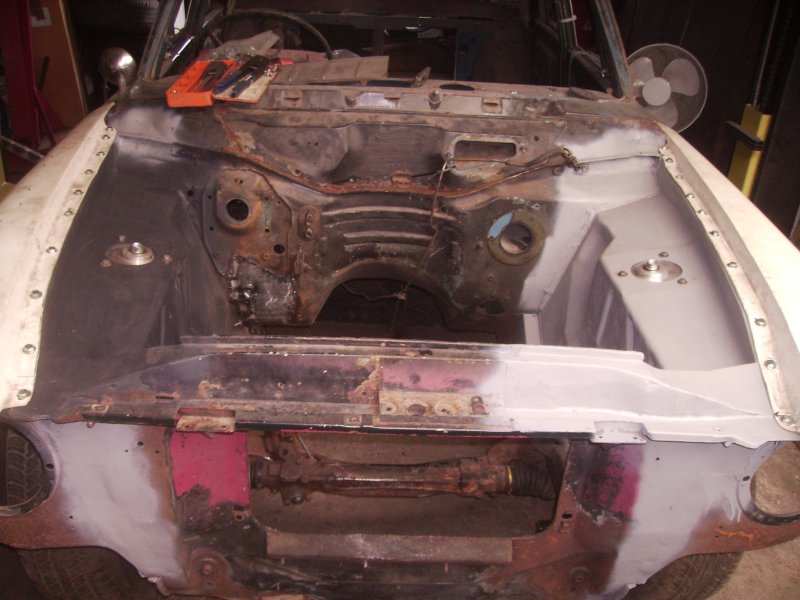

Posts: 1644
Re: a bit of this and a bit of that
the zephyr's structural welding is done, woohoo! i've got to collect a pair of tyres tomorrow so may not do anything on it until thursday now. then it's hook the steering rack to the the cut off zephyr column and sort the access hole in the floor there. this one's nearly done.

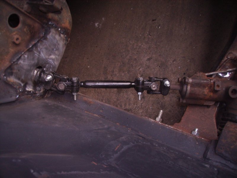

Posts: 1644
we got the majority of the steering sorted yesterday. i needed to pop over to rally design to collect uj's and splined shafts. a section of 1 shaft had to be turned down to fit inside the zephyr's inner column, much better/stronger than butt welding to the end. we turned a supension poly bush down to slip tightly between the inner and outer column and made a 'top hat' spacer to sit between the bush and upper uj as a retainer. next with the 2nd uj on the rack splines (after they were shortened 2") so we could measure the intermediate splined shaft. with the 2nd shaft cut to length we welded the splined ends into a sleeve their full length. the top hat and shaft were painted as the last job ready to assemble today. the last part is to trim the jinormous hole in the bulkhead and add a plate with just a small hole for the column. on these old ford's the steering column/box assembly came out through the inside of the car so the hole had to be big enough for the box to fit through. someone has cut a big 'flap' extending down from said hole that was just bent inside the car? we'll sort it and make a tab to weld to the column outer that'll bolt to the new bulkhead section we'll add today.
pics today once it's all wrapped up. :thumbright:
