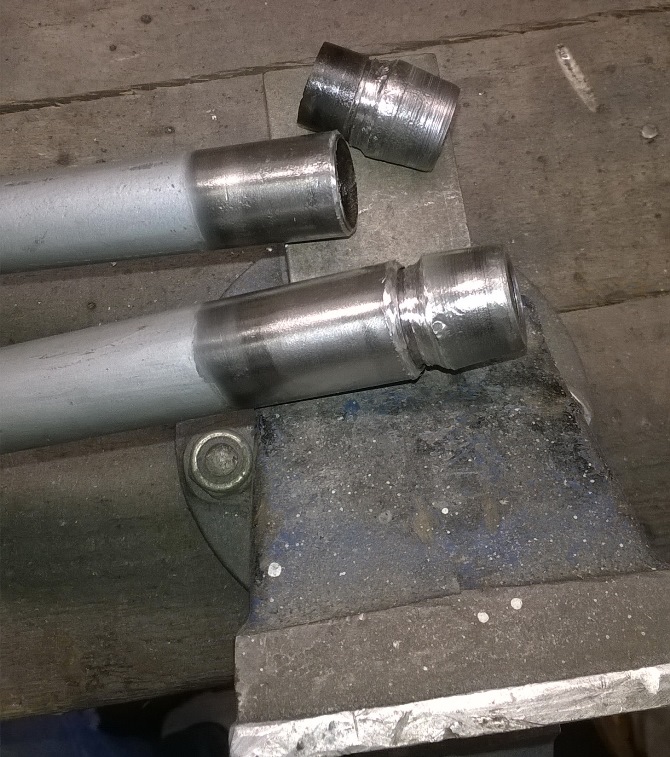

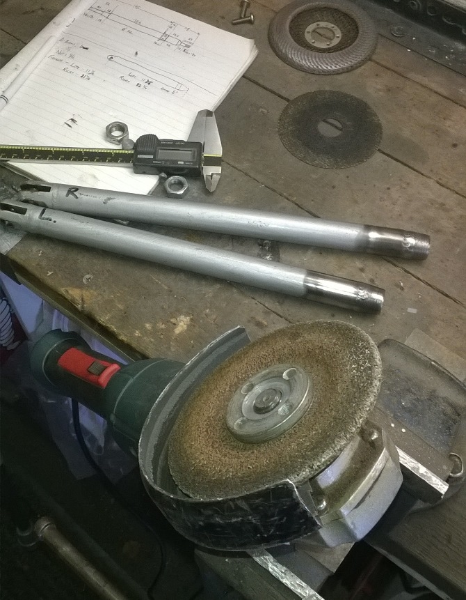

So when I set up the front struts and corrected the trail, etc, the rear lower control arms were slightly too long. They adjusted correctly but with no room for jam nuts on the rod ends- not ideal!
The tubes are different lengths o'course due to my asymmetrical steering set up...
Todays task is to grind out the welds and remove the threaded inserts, then cut the tube down by 1/2".
I'll tack the inserts in but I'll take them to my mate Dan for professional welding, being such a critical part an'all!

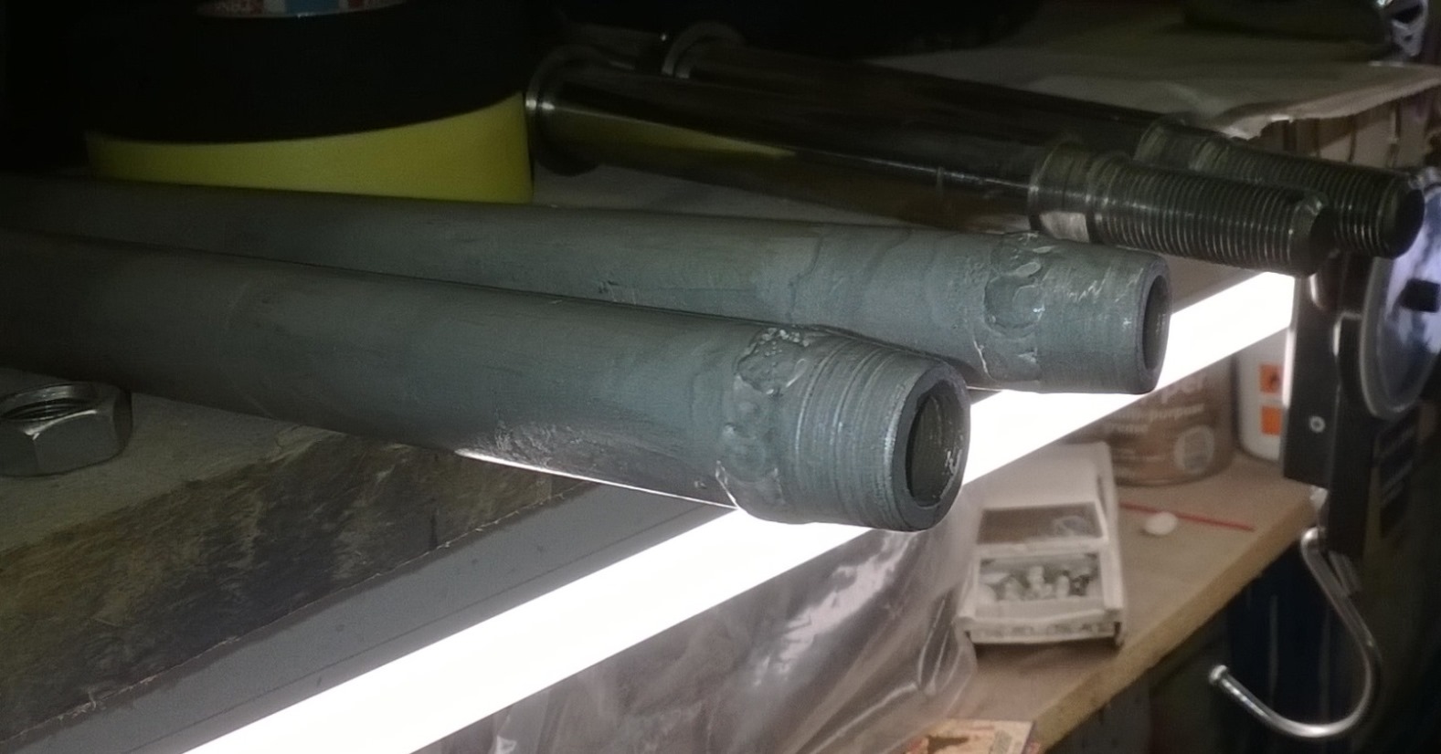

Control arms done, I welded them myself in the end due to impatience.

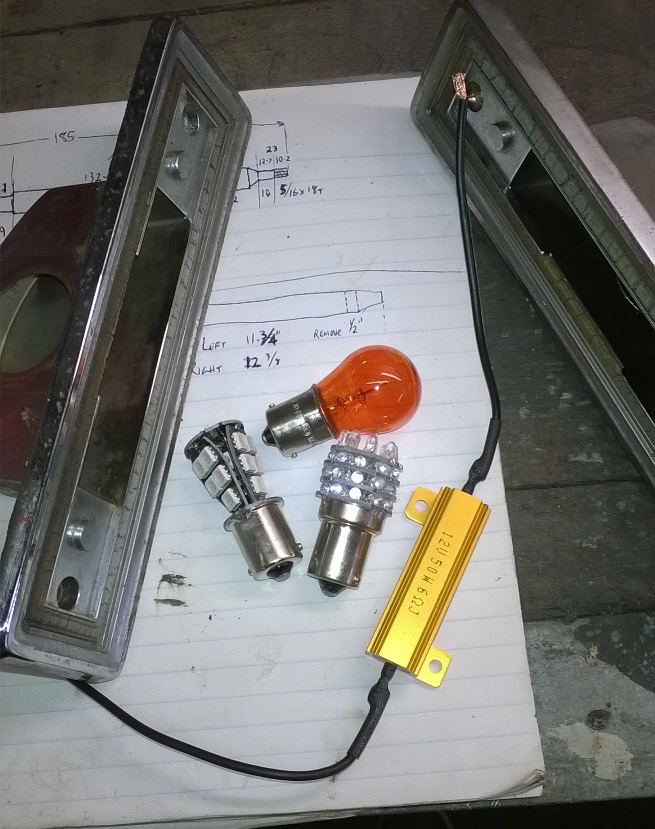

I started on the feeble rear indicators. I tried out 2 different LED bulbs with resistors. These were even more feeble!
I've had competing advice- do the reflector surface in gloss white paint or chrome tape.
I'll try one of each and compare.

I was thinking of LED rear lights for my belvedere, but they didn't seem to work with the rear indicators, have you got it to work?? I have the standard red blinking indicators.
I also found them to be dimmer!
In my alfa I managed to get red LED bulbs for the brake lights which helped quite a bit for brightness...
Some LED bulbs don't like flasher units??
Posts: 8368
LEDs have no resistance for the flasher to work so you need a resistor like the one in my photo. They're still crap tho :D

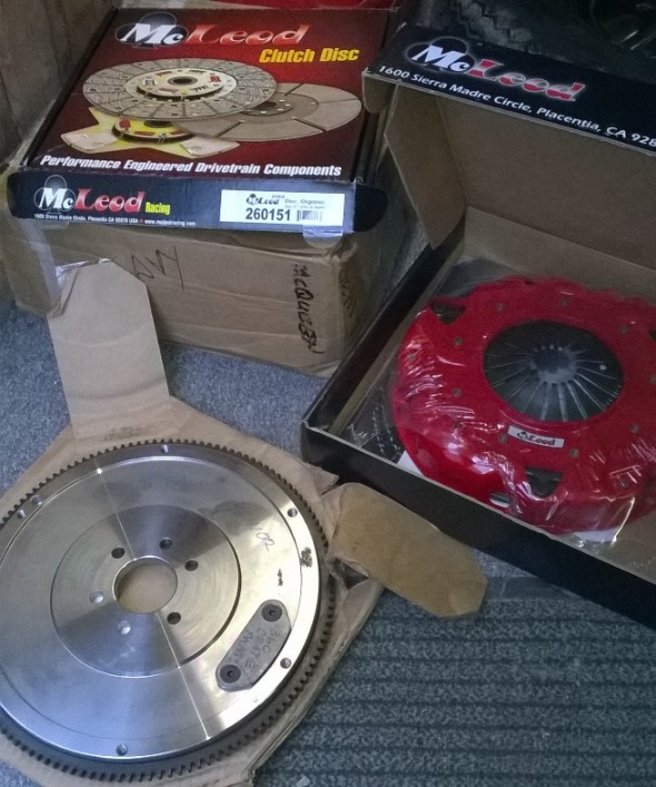

Hmm, I wonder what this could be...?
:D :D :D :D :D :D :D :D :D :D
Posts: 22137
A727 Replacement???
Let's see you get under the car, Pegleg!!!
your welding looks good nothing wrong with them fella
Posts: 14457
My X ray vision says thats a clutch...
Posts: 8368
Pete wrote:A727 Replacement???
You know I like a challenge ;) .
Will- ta mate. Sometimes it works, sometimes not...
Correct Blue :thumbright: I bought it in March! Unfortunately I'm sure the bloody friction plate is wrong. It's a full organic and I'm sure I ordered an organic/ ceramic same as Ades. I lost my original order when my laptop died and there's no paper copy so I have some checking to do :?
