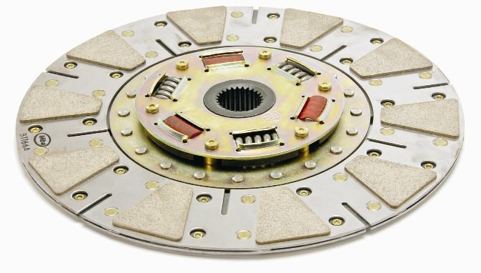

I just need to order the ceramic/ organic tomorrow from WASP. It's special order so I won't get it til mid-July but... I'm off the road anyway so that's fine.

I've ordered the disc, eta 24th July... good thing I'm not taking it to the Nats then!

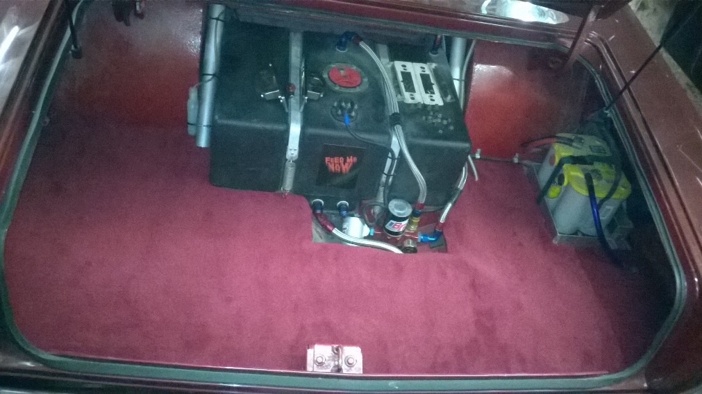

Meanwhile, I hobbled round the back of the car and tarted up the trunk with a bit of carpet.
Trunk carpeted.jpg (237.47 KiB) Viewed 1404 times

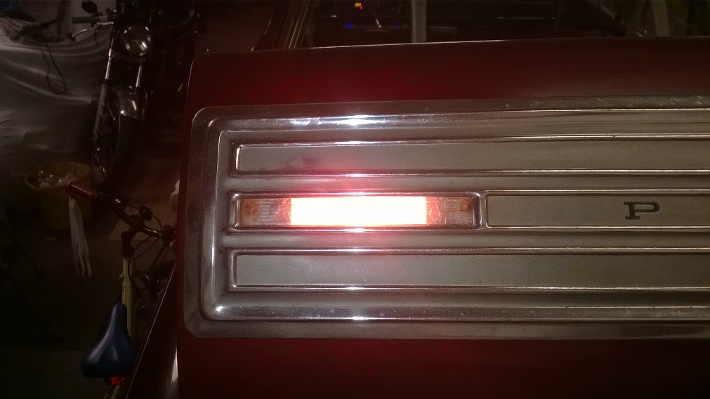

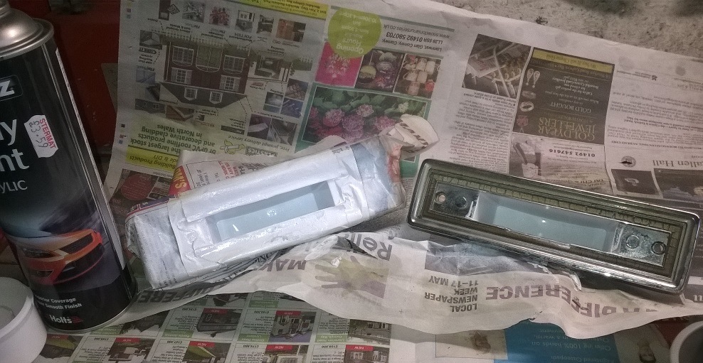

I sprayed my rear indicators gloss white inside, should make them more visible on sunny days I hope!

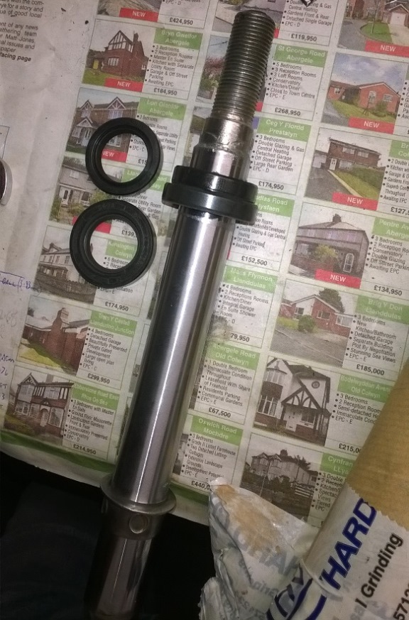

Shock rods arrived back today :D £130 the pair.
The original seals were a one-off and no longer produced so I'm replacing each one with two plain seals, one single lip, one double. Together they're the same shape as the originals.
I just need to get some 5wt bike fork oil and rebuilding can begin :thumbright:

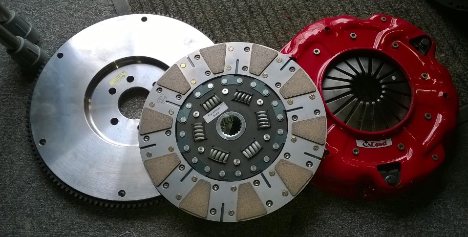

My new organic/ ceramic friction plate has arrived!
Time to hop to the garage and start stripping out my gearbox :thumbright:
Posts: 8368
Busy day today...

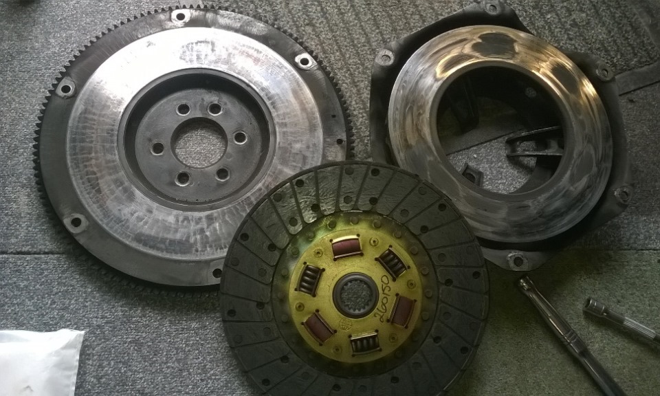

Stripped out the gearbox and pulled the knackered old clutch out.
The new flywheel is on, new clutch is in place, it just needs aligning. I've ordered a tool which won't arrive til Monday, I doubt my patience will last til then so I'll probably do it by eye anyway :roll:

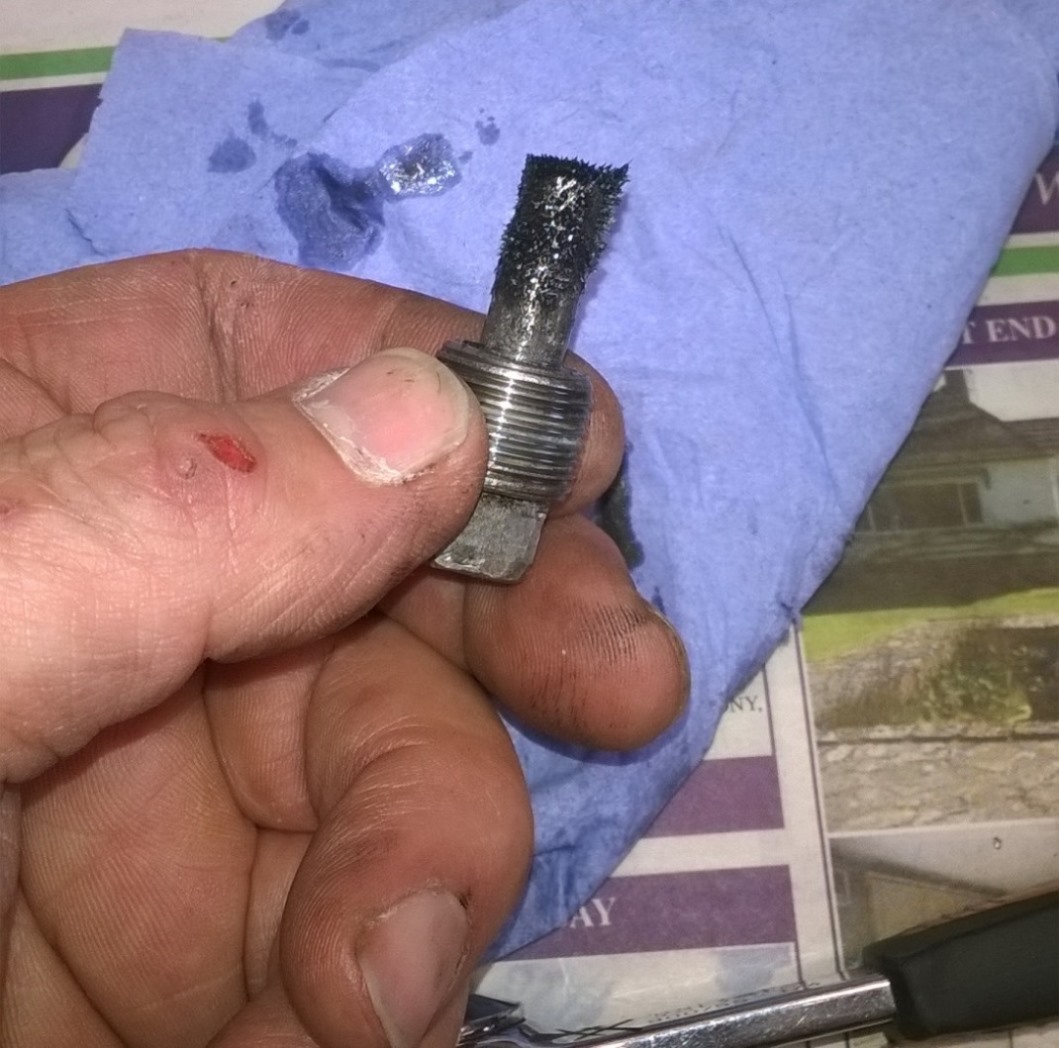

The magnetic gearbox drain plug has collected some swarf, I'll investigate that before it goes back together. I also still have a bad leak from the front seal, this is due to play in the input shaft so I need to sort that so it doesn't pee oil all over my new clutch.

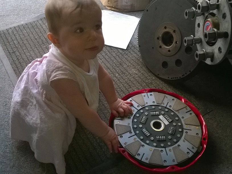

Wren has taken over from Willow now as quality control.
Wren checking new clutch.jpg (202.38 KiB) Viewed 1252 times
Gearbox swarf.jpg (231.68 KiB) Viewed 1252 times
Clutch- shiny new.jpg (201.43 KiB) Viewed 1252 times
Clutch- old roasted.jpg (206.07 KiB) Viewed 1252 times
I have a universal tool here if you want me to bring it up.
I have always got a fat marker pen and wrapped it in electrical tape till it's a perfect fit and just used that.
Remember that any oil or anything on them clutch plates is a big no no
I would clean everything with Acetone (nail vanish remover) before install

I popped the side cover off the gearbox, no sign of any damage or further metal bits so I'm happy to leave it be. The oil leak isn't what I thought but I did find a likely cause- the end of the countershaft is prone to leaking and needs a smear of sealant. Well I didn't do a very good job of it last time! Fingers crossed it's sorted now, gearbox is all ready to put back in the car.
