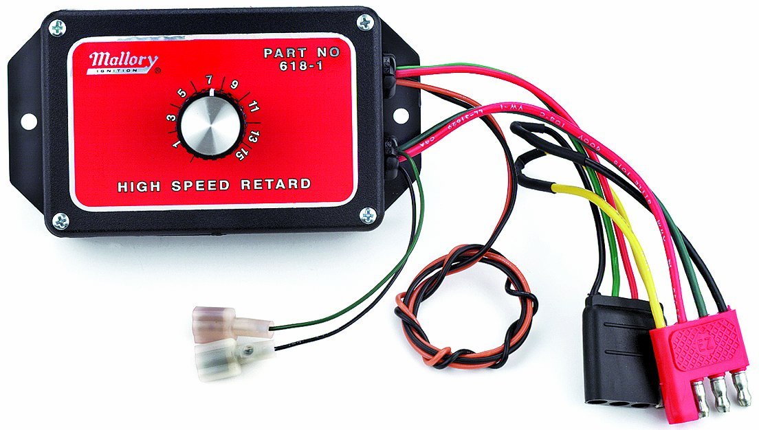

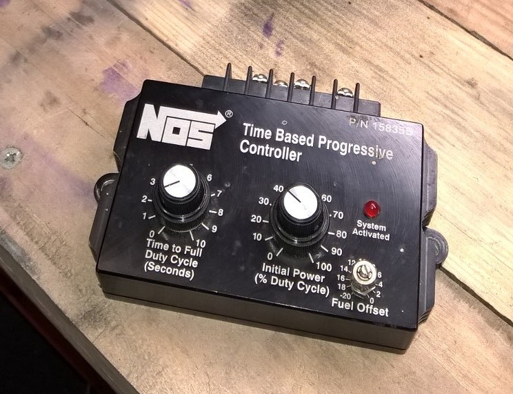

I've been picking up useful bits recently, I now have an auto ignition retard unit and a progressive controller for my nitrous setup. I've not attempted to wire it all up yet
- NOS controller 01.jpg (179.26 KiB) Viewed 2531 times
- Mallory Retard 618-1.jpg (123.4 KiB) Viewed 2531 times

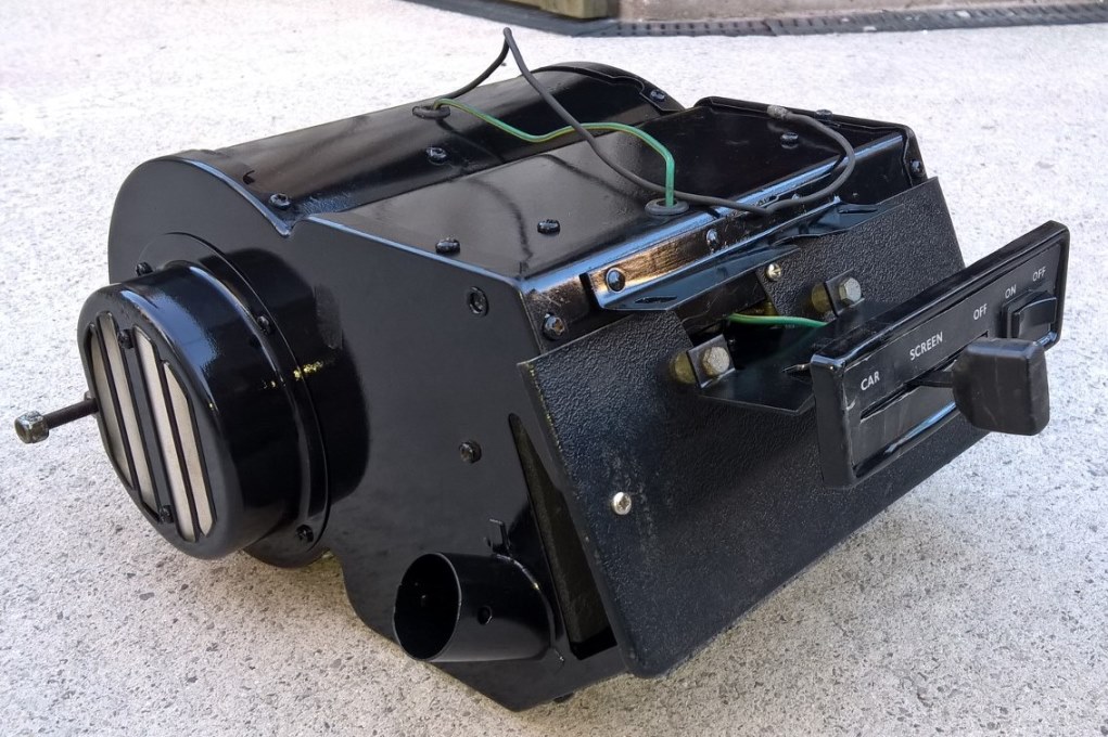

The controller came from the Essex swap meet, along with a mini heater for a tenner

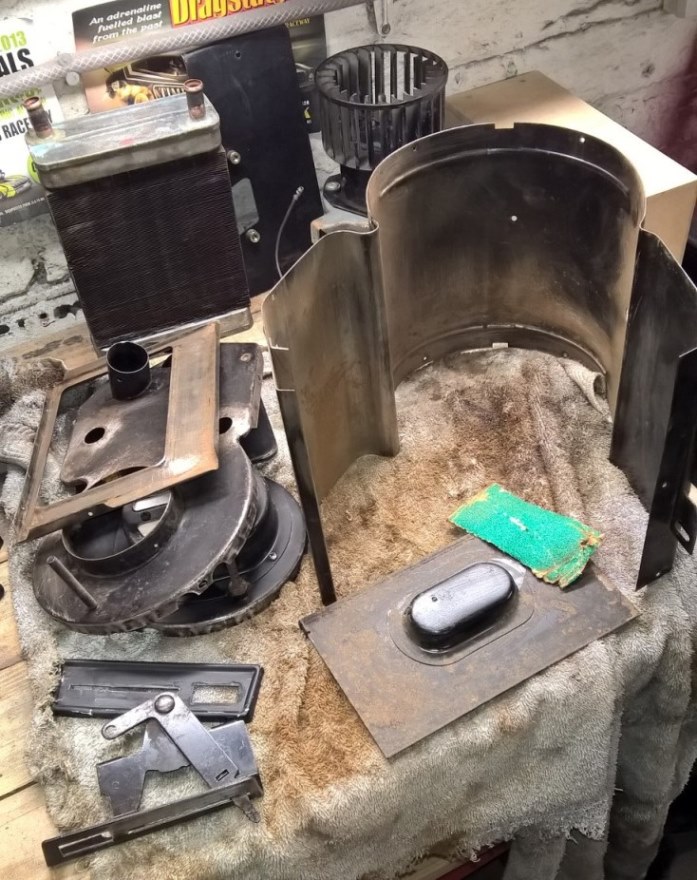

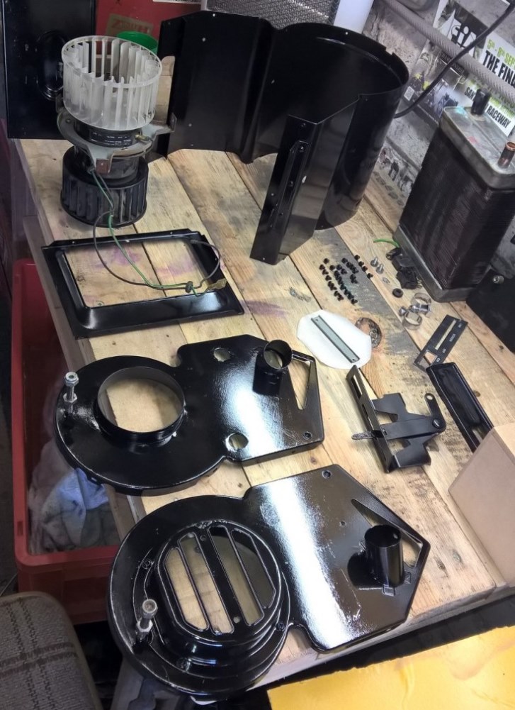

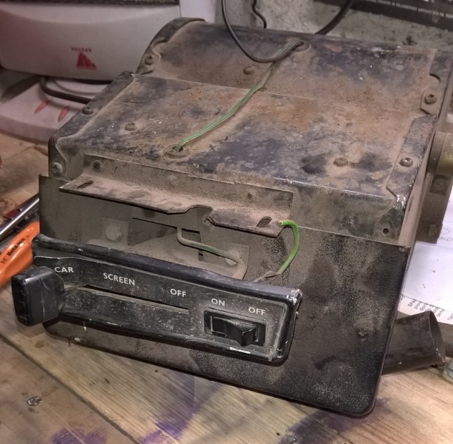

I got a bit carried away and the task of cleaning it up and testing it turned into a full recon and paint job... I pressure tested the matrix (airline and rubber bung in a bucket of water- overdid the air, blew out the bung, caught it in the face along with a lot of the water and swelled the ends of the matrix. Such fun!)
It'll sit nicely up under the dash and shouldn't be too hard to remove for racing weight reduction if I feel the need
- Mini heater 05.jpg (233.42 KiB) Viewed 2525 times
- Mini heater 03.jpg (218.37 KiB) Viewed 2525 times
- Mini heater 02.jpg (216.83 KiB) Viewed 2525 times
- Mini heater 01.jpg (156.28 KiB) Viewed 2525 times
We did not have a lot of success with the time based controller. All in on the line gave the best results - 1.39 60 foot time as a best and regular 1.40 - 1.42.
However, not sure how it will work with a 4 speed as you are on and off the gas for shifts so the Nitrous WOT switch will be on and off.
Do you intend only using NOS at the top end or off the line?
I haven't a clue Pete!
I was sort of thinking that if I start at say 20% and 3 seconds, by the time I shift out of 1st it'll only be up to maybe 40%, 2nd maybe 60%, etc.
If I do use it at the nats it won't be til Sunday so I'll get at least one days racing in before I blow the ar5e out of the motor
I'd never planned on a progressive but this as £25 at the swap meet so I had to grab it!
Well, I wouldn't call it a plan... but yeah, on a wot switch, timer resets on each shift, car spends longer in each gear as you shift up allowing each successive gear a bigger hit. That's my theory anywaysGuy wrote:Just a thought....You may not be able to use the timer between gears unless you do wide open throttle shifts, if you come off the throttle the timer will reset/lose power as the nitrous disarms
I guess you have already thought of that and got a plan.....

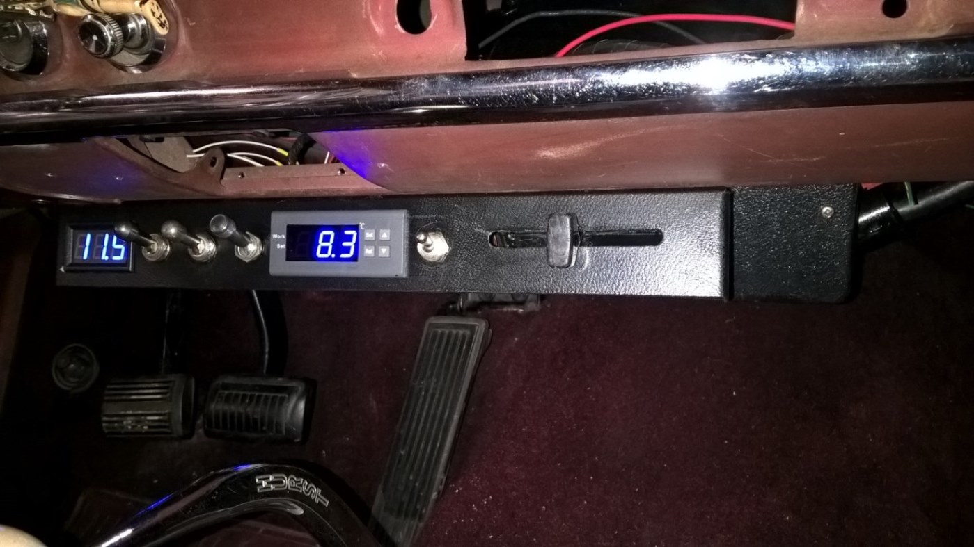

I've also installed the heater unit. It's not wired or piped yet, but I do feel very smug about how it appears under the dash

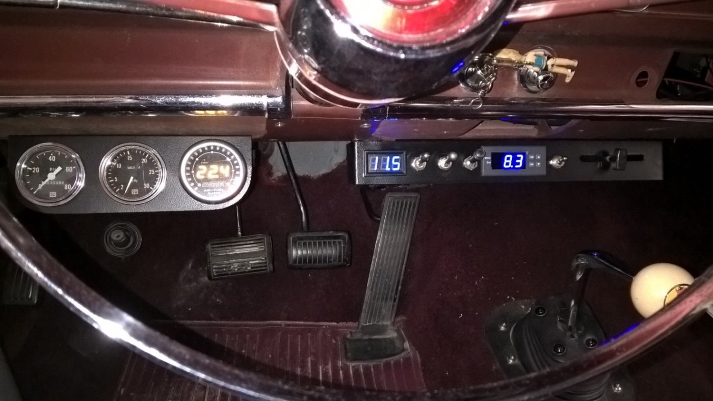

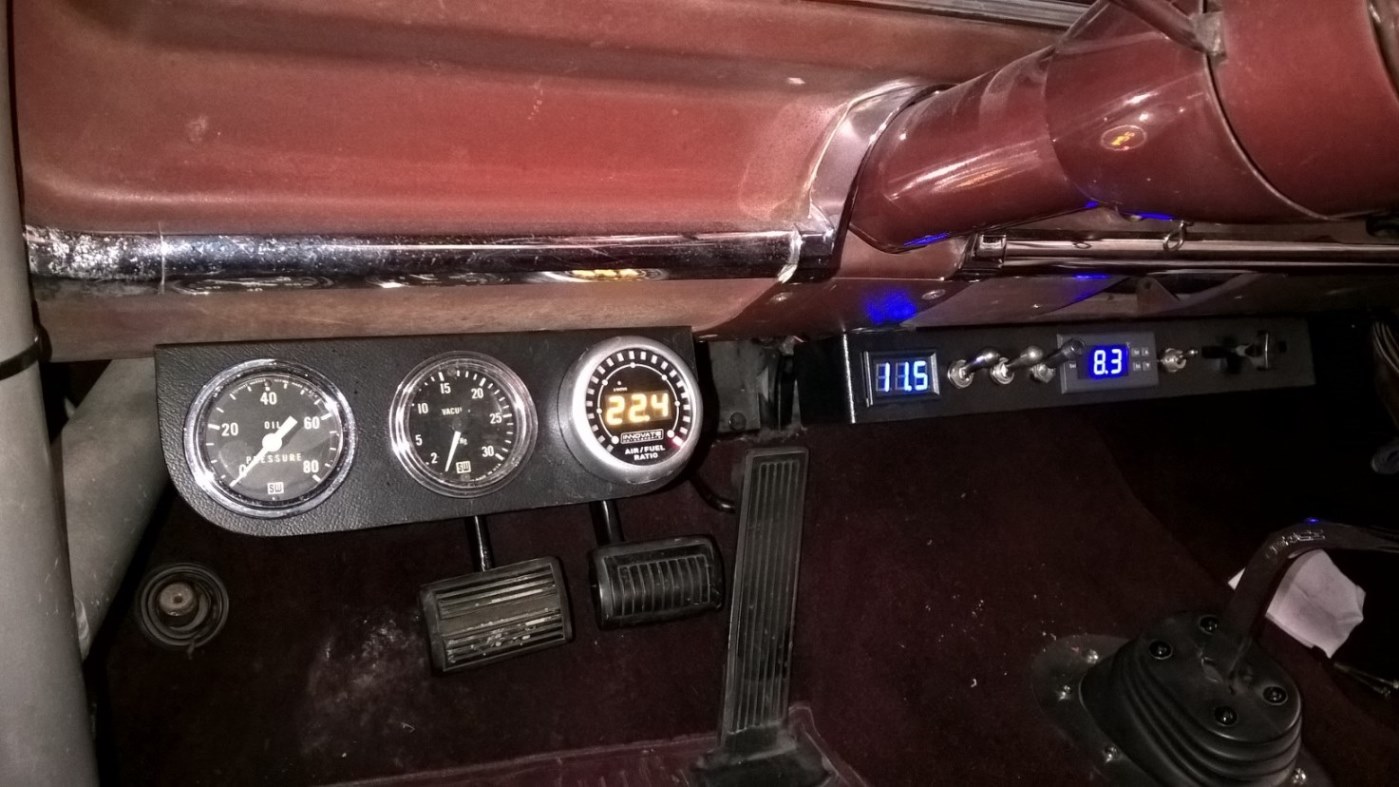

You can just see the heater is in pic 3, the original Mini lever is poking through the new panel I've made along with all the extra switches and stuff I've had to add for the fuel pump, N2O, etc. When I'm feeling brave I might signwrite... Steady hand needed!
I also made a matching panel for my AFR and a pair of vintage Stewart Warner gauges.
I finished both panels in crackle satin black, to match(-ish) the glovebox lid.

- Gauge panels 03.jpg (235.34 KiB) Viewed 2429 times
- Gauge panels 02.jpg (230.49 KiB) Viewed 2429 times
- Gauge panels 01.jpg (234.05 KiB) Viewed 2429 times

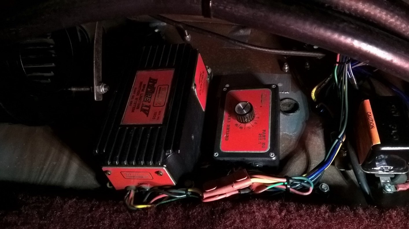

I eventually figured out how to wire my retard unit, that's now finished. The car runs with it wired in but I've yet to check it actually retards the ignition.
So aside from the actual gas, N2O is good to go!

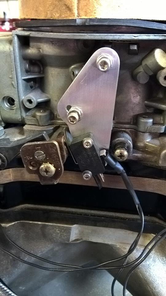

While I was in a wiring kinda mood, I also wired in my Linelok to a button on the shifter.
- Ignition and retard 01.jpg (233.85 KiB) Viewed 2408 times
