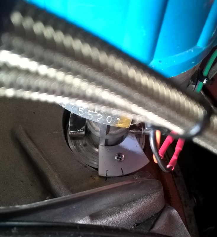

I've tuned the timing and idle to suit the new Mallory Streetfire and it runs like a dream! The multiple spark thing at low rpms has cleaned up the carburation and it starts, idles and pulls away much more smoothly now.
There's no noticeable difference at full noise over the Mallory unit.
The timing is quite different- I made this marker plate to help line up the dissy, the right-hand mark is for the Mallory and the left one for the MSD.

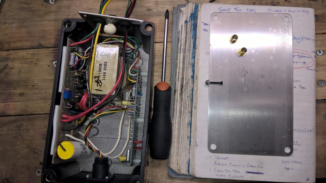

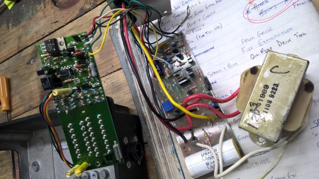

With Dave999's advice, I opened up the faulty box.
There's nothing obviously burnt, broken or swollen, so I got my meter out and started measuring. One of the first things I checked was the transformer and the primary side (red wires) measures 0 ohms- definitely not right!
So thanks Dave, I have a chance of fixing it now, I just need to find somewhere to buy a matching replacement transformer, or maybe get it rewound?
I've got the Mallory retard wiring worked out now (luckily they write what each wire does on the circuit board- shame you have to open the units up to find out!)

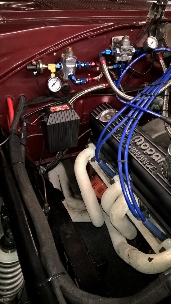

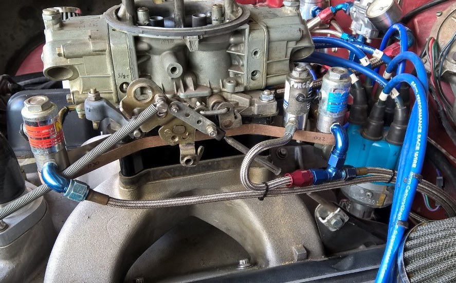

I had a spare nitrous solenoid so I've plumbed that in as a purge. I've stripped out a bit of redundant wiring, tidied and taped up the engine bay loom for the first time, much nicer!
So while looking for a replacement retard unit, thinking mine must be faulty, I found the wiring diagram for the MSD version. This has the same wire functions, just different colours!
I worked out I'd connected the wrong one of 2 green wires. I swapped them, connected it up and it fired! Yaay!
