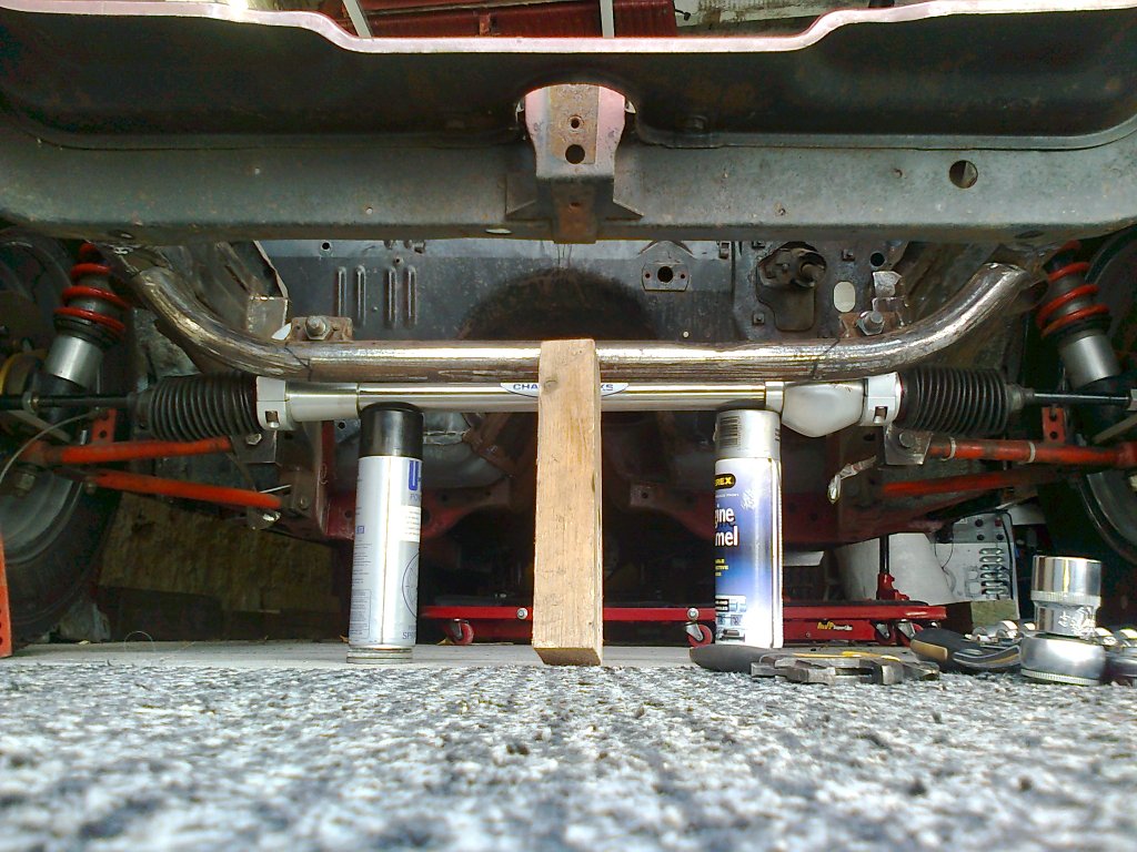

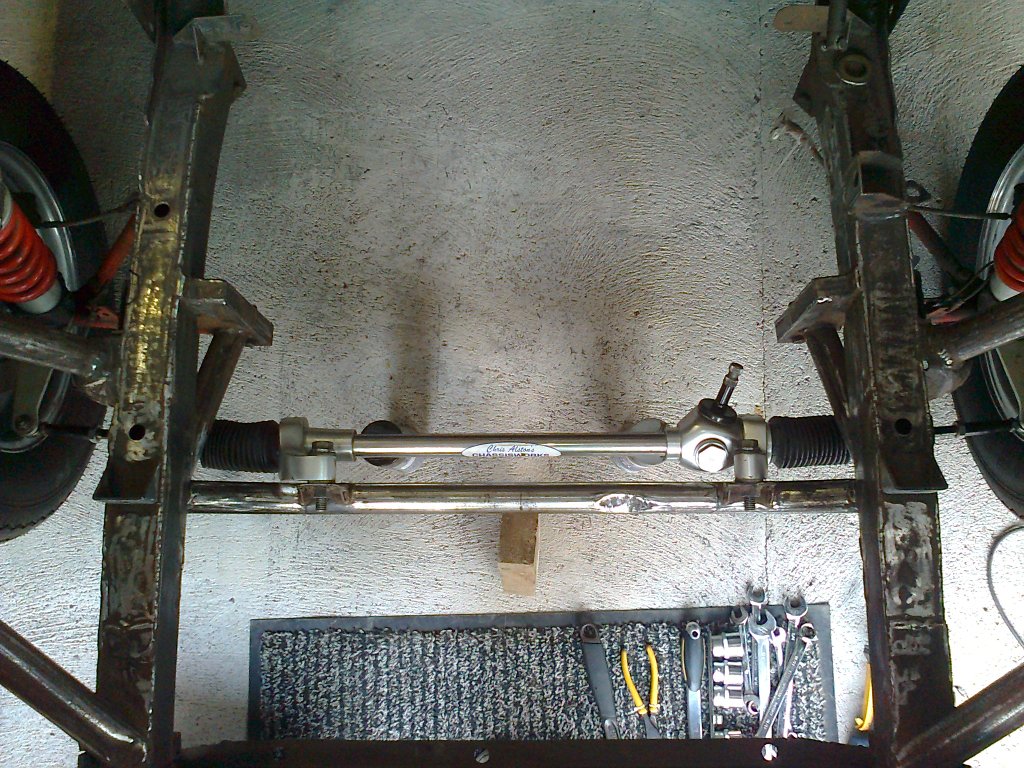

I finally have the rack in the right place and tack-welded in
It took most of yesterday to get it lined up and all that did was prove how badly the A-arm mounts were out of line
I got the rack millimetre-perfect level and centred in all planes, only to find one wheel kicked out at the back. This could only be due the bottom A-arms being unequal.
Luckily they're adjustable on the rod-ends so i managed to get the wheels symmetrical without any more cutting & welding. Obviously once i've got registering sorted it'll still all have to come off but it's good enough for now
- Rack in place, ready to weld 02.jpg (243.91 KiB) Viewed 963 times
- Rack in place, ready to weld 01.jpg (178.52 KiB) Viewed 963 times

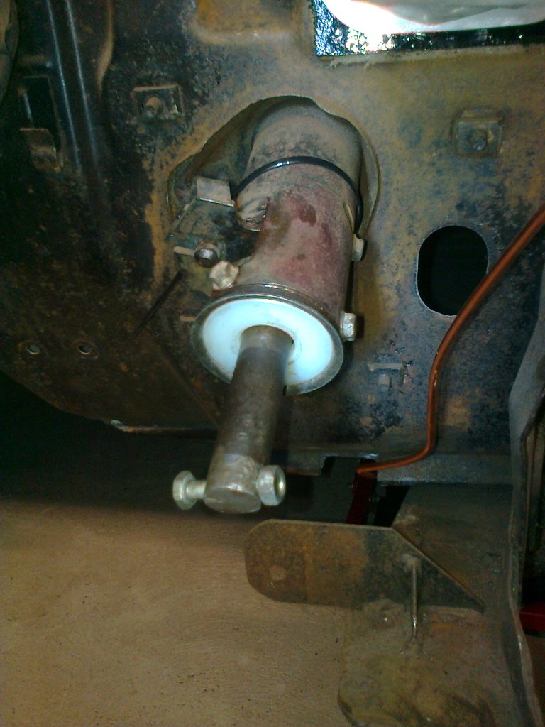

I've had a poly steering column bush made so that's sorted now
I need to shorten the steering shaft now as i've moved the rack back, only i'm a bit concerned about the way the uj attaches to the shaft- it just slips on and is drilled for a little nut & bolt. Doesn't seem very secure to me?
The lower uj mounts on splines onto the rack, so much better.

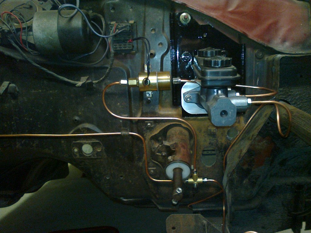

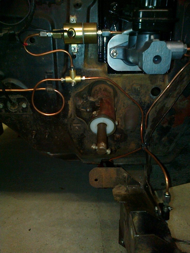

Brakes pretty much sorted now with Daisy's assistance
I've made all the brackets & run the cable, we plumbed in the copper lines and mounted everything. Just waiting on a couple of adaptors to connect up the Linelok and i can bung in the fluid.
Only concern is i didn't allow for the Z-bar, may have to re-route a bit when i try to fit.

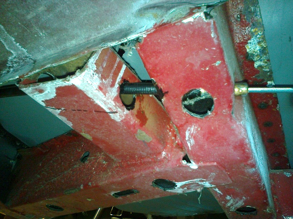

I've 'adjusted' the Parking brake release handle to clear the cage.
I had to drill the cage outrigger to route the cable.
- 04 Parking brake- front cable chassis route.jpg (174.36 KiB) Viewed 911 times

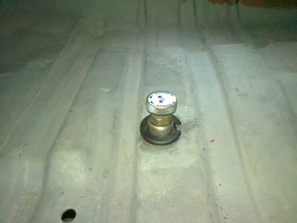

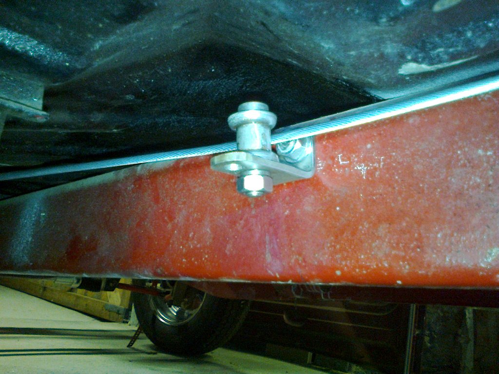

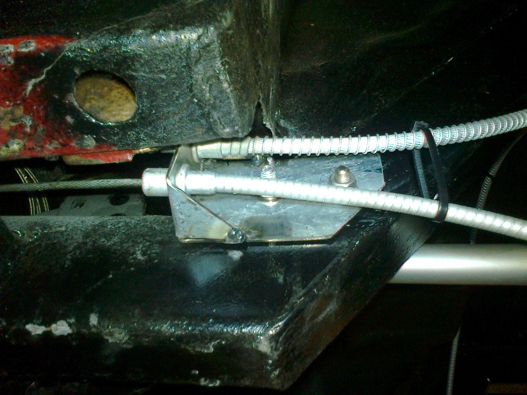

I made this guide for the turn in the Parking brake cable. It may need to be stronger but it's bolt-on so i can re-do if needed.

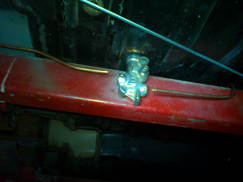

I've cunningly located the bias adjuster so the knob appears under the seat.

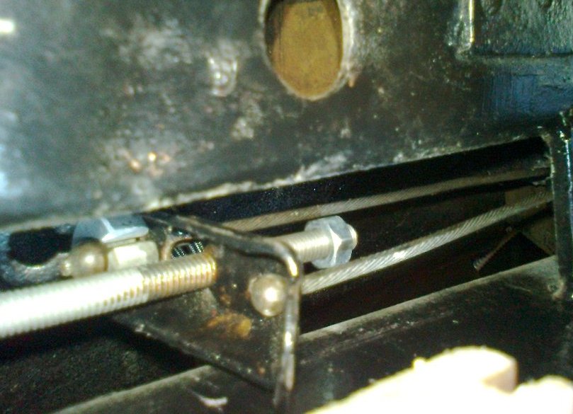

The rear cable inners were differnt lengths so i made this little spacer. They may equalise once it's all under tension. If so, i can simply take this out.

- 08 Parking brake- rear balance bar.jpg (86.79 KiB) Viewed 906 times
- 07 Brakes- Bias adjuster 02.jpg (119.89 KiB) Viewed 906 times
- 06 Brakes- Bais adjuster 01.jpg (104.57 KiB) Viewed 906 times
- 05 Parking brake- front cable guide.jpg (159.88 KiB) Viewed 906 times

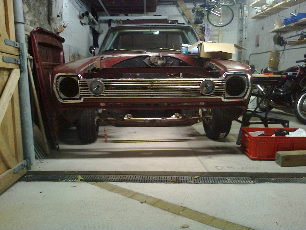

Time for a long overdue progress report...
After weeks of struggling with lack of time, money and enthusiasm i've got somewhere!
I have WORKING BRAKES!!! They need re-bleeding but there's pressure there and the linelok and parking brake work.
I re-routed the pipes below the m/cyl as i realised they'd be in the way of the clutch rod.
It has a face! I've put the brand new grille & headlamp surrounds on as well as the tail & reversing (soon to be rear indicator) lamps, just need orange bulbs
Tomorrow my mate Ritchie will have a pair of 7" halogen headlamps, a neat washer pump & bottle and a better upper steering shaft u.j.- a Vauxhall one which is the right shaft diameter but has a flat on one side- much safer than relying on a teeny nut n bolt!

That bolt looks similar size to mine, assuming a good quality bolt, it will perform well in a shear application.db wrote: I'm a bit concerned about the way the uj attaches to the shaft- it just slips on and is drilled for a little nut & bolt. Doesn't seem very secure to me?![]()
