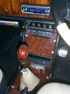

Looks like you are going to be busy :lol:
What a shame ..........................................looks like a 60`s centre console from a Mk 1 Mini, made in the Blue Peter studio :( :( :(
"Here`s one I made earlier" :lol: :lol: :lol:

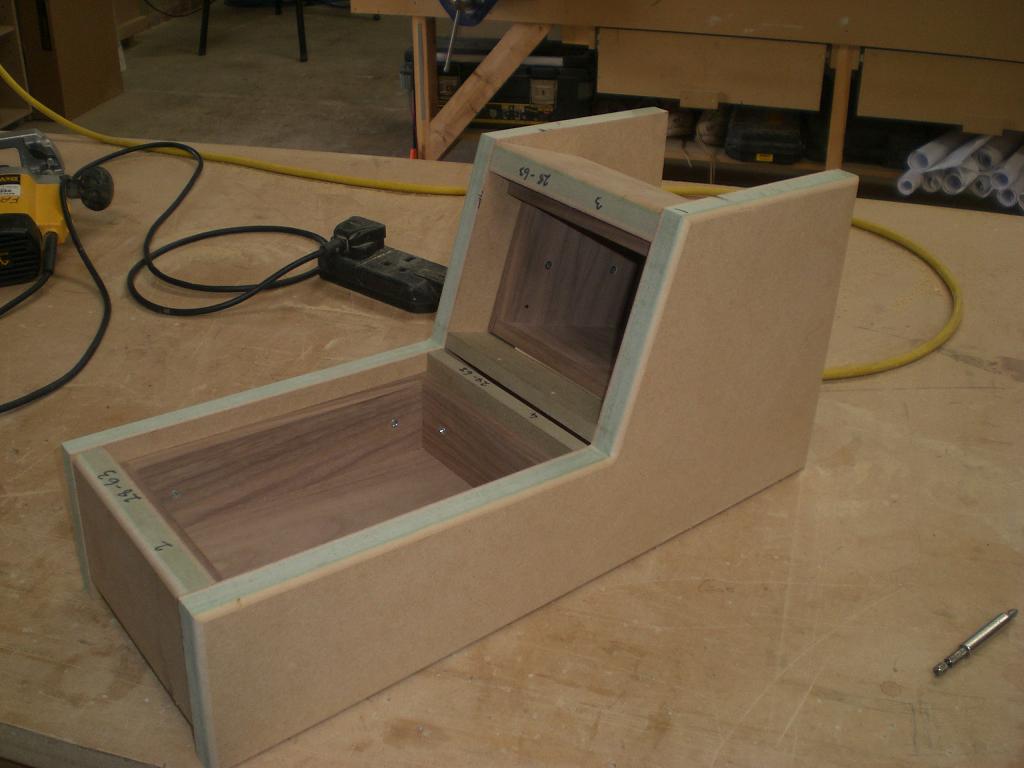

At least the one I made isn't plastic laminate and is real walnut and in a far better car.
ANTON wrote:What a shame ..........................................looks like a 60`s centre console from a Mk 1 Mini, made in the Blue Peter studio
Looks like MDF to me :? :? :?
