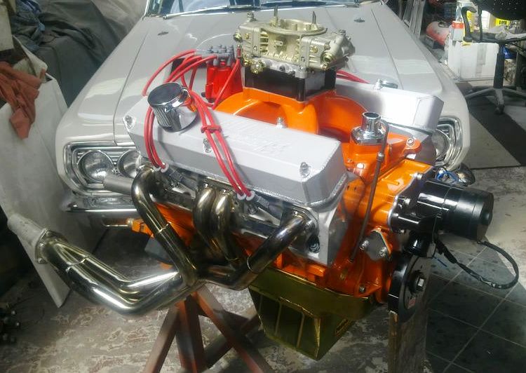

Pretty much ready for dyno pull next week.
Carb spacer is to mock up distance I need to fit the refrigerated air intake plenum which will go on once I get the motor back to Norfolk.
Am taking refrigeration kit to the dyno shop that will get batches of my fuel anywhere from ambient to - 50 c on the day so will be able to simulate the partial effect of the intercooler.

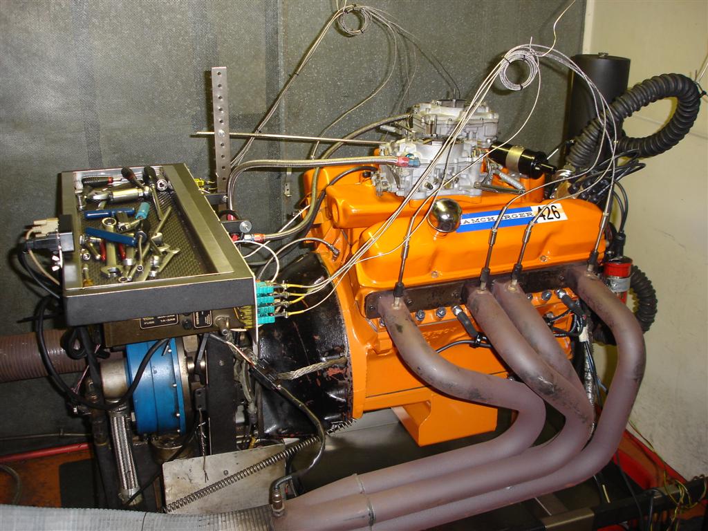

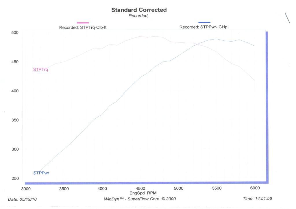

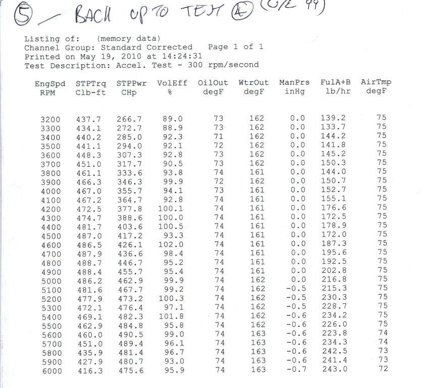

Had the motor on the dyno yesterday
492.8 TQ @ 4700 RPM
490.5 HP @ 5600 RPM
Did 8 pulls in all including one with fuel at -37 c ( had no effect at all on a carb`d motor but will definately work on a rootes blower according to Dennis who has had cooling issues with Steve Nimantis` blower set up ). Slight oil leak from the rear seal but no dramas.
Big thanks to Dave Billadeau for all his work ... he`s done a lovely job and would recommend him to anyone. I`M VERY VERY HAPPY WITH THE MOTOR :D
dyno graph.JPG (33.09 KiB) Viewed 1571 times

Surprisingly, race gas had absolutely no effect at all, so premium unleaded it will be.
C/R is 11.2.
Will also get a lambda sensor on the exhaust with a handheld so I can keep an eye on its state of tune

Best looking SB I've seen for.... well, ever! :thumbright:
Where was that outdoor pic taken Jon? Or more to the point, who's/where is that 64 plym? :love10:
BTW, I was gonna ask where you got it dyno'd but, seeing the pics, I dont need to ;)
KENNY 1.jpg (163.65 KiB) Viewed 1528 times

Rob Twin ............ That 64 Plymouth is right up your street, really nice car ( HEMI TOO )
