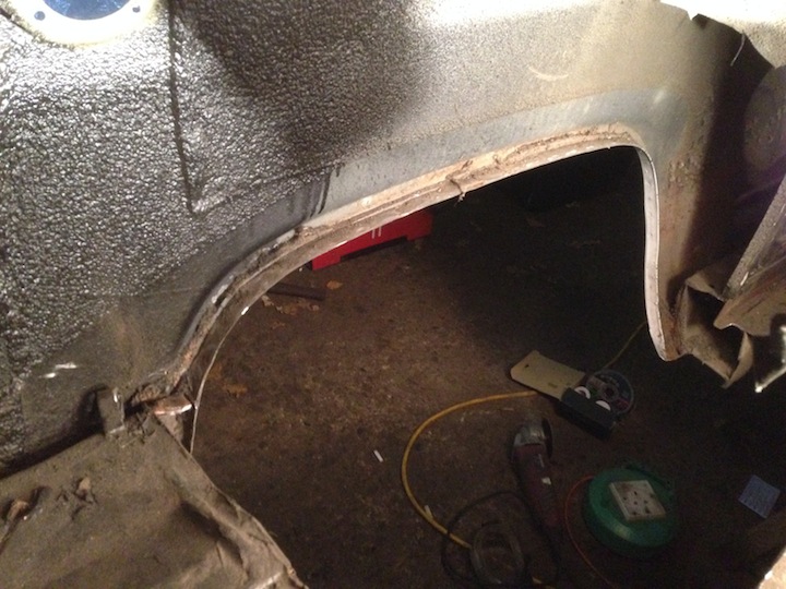

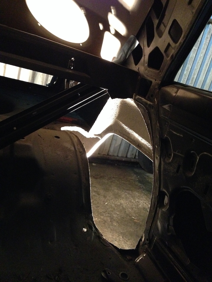

Now that Christmas is out of the way, time to crack on. You can remove the inner part of the arch pretty much in one piece.
Posts: 14502

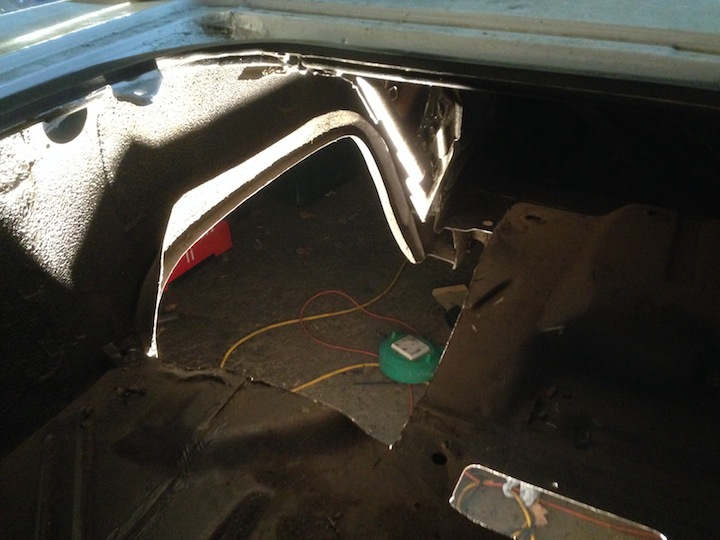

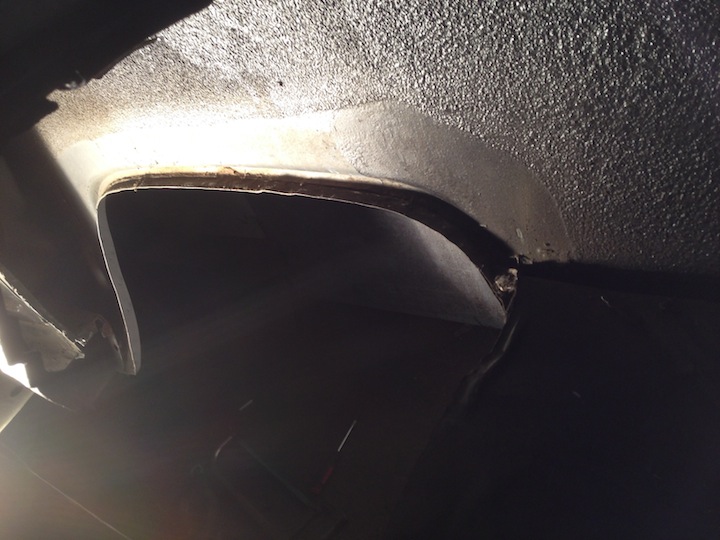

After that you just have to keep taking out bits to get access to other bits, it's slow and dirty work. Removing the last section which is spot welded to the outer arch is tricky and requires a steady hand to avoid cutting all the way through. I didn't get on too well with the plasma cutter and ended up doing most of it with an angle grinder with thin cutting discs, I've got through a box of 20 so far :roll:
Nice and neat Blue.
Will the diagonal braces need to be modified once the arch is " tubbed" ?
Posts: 14502
So it's mostly all out now, will leave the final trim until I have the tubs. I'll order them tomorrow now I know what size they need to be.
