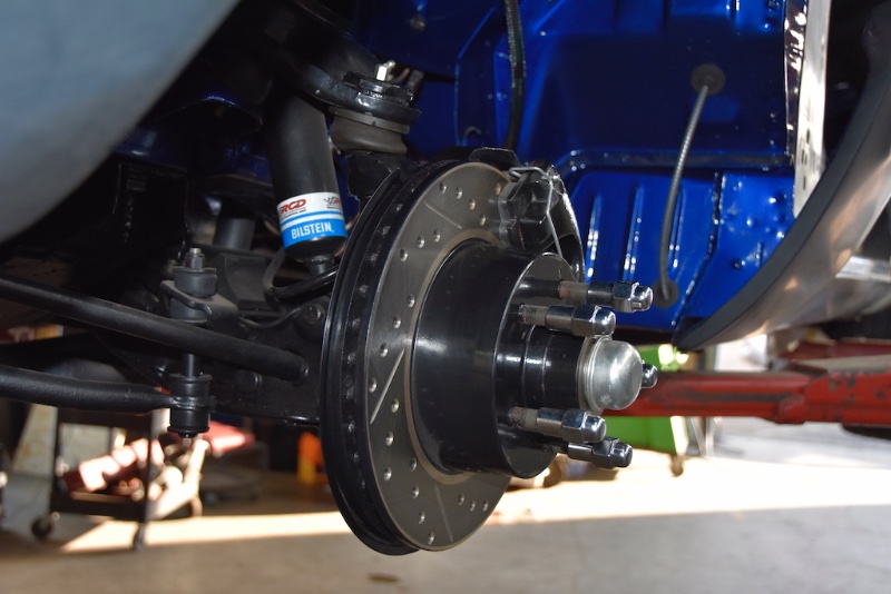

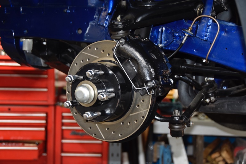

Completed the brake upgrade to discs from the old drums
_DSC4519 copy.jpg (116.89 KiB) Viewed 3033 times
_DSC4518 copy.jpg (140.01 KiB) Viewed 3033 times

Cleaned out all the old dried up grease in the spindles re-greased and ready to go
_DSC4522 copy.jpg (114.53 KiB) Viewed 3031 times
_DSC4524 copy.jpg (162.79 KiB) Viewed 3031 times

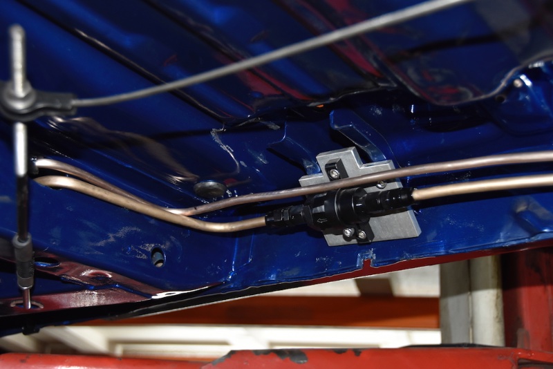

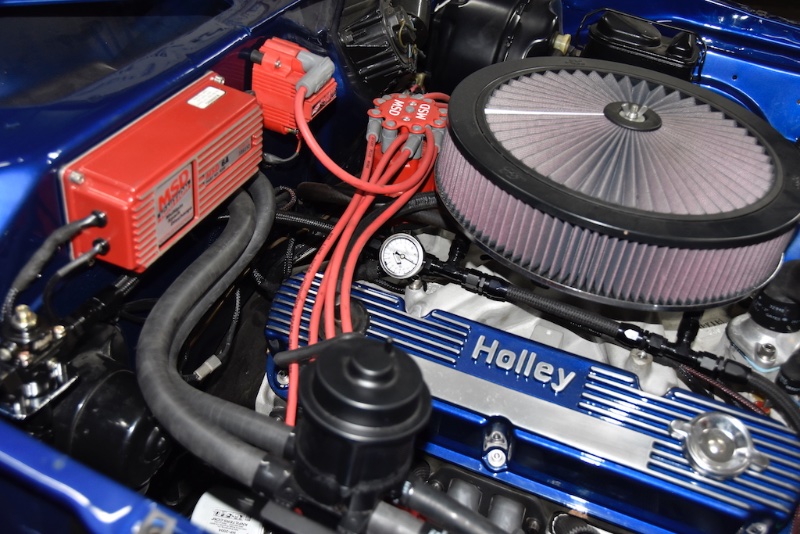

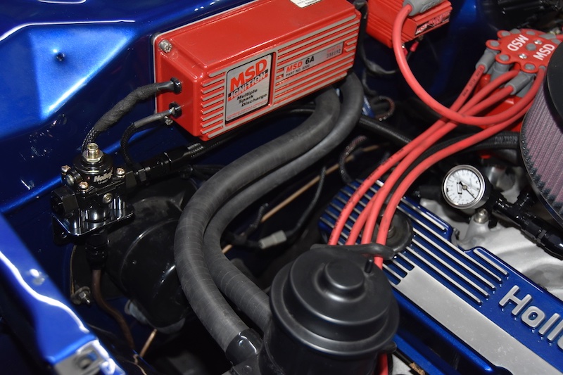

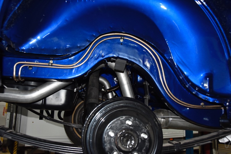

Run new 3/8 fuel feed and a 5/16 return line - really struggled to get a descent line with the long lengths of pipe without kinking!!!
Fitted an inline filter midway .
I've tried fitting a fuel pressure reg on the return side of the carb - Seems to work even though Holley tell me it's not correct , but I'm gonna try it anyway.
It all seems ok so far but not tested the road fully .
