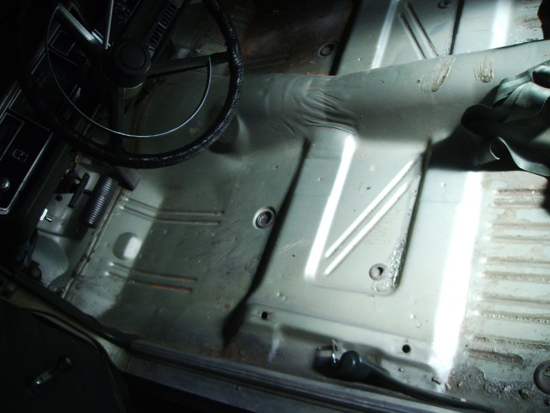

just had a sweep out inside the car now the seats and carpet remnants are gone. there are just 2 1/4" holes together on the pass' floor (dead centre in the last pic, show as 2 beige circles) which is about what i expected. this car is excellent rust wise, it just looks a pos ;)

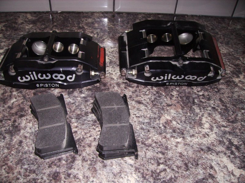

So if you like stuff matching then look away now. I've sorted a pair of wilwood calipers for the front at work today. They are nice billet superlite 6 piston jobbies which is all good. Now the bit you may cringe at, as they are ex display ones one is lug mount and the other radial mount. Every other detail is identical so on the basis you can't actually see the mounts when on the car and considering 'i don't care', at £150 the pair including fast road pads then that's what I'm using. I'll add pics later, Neil.

caliper pics, as you can see the only difference is the mounting type. so it'll have a different bracket each side, that's no problem to me. ;)

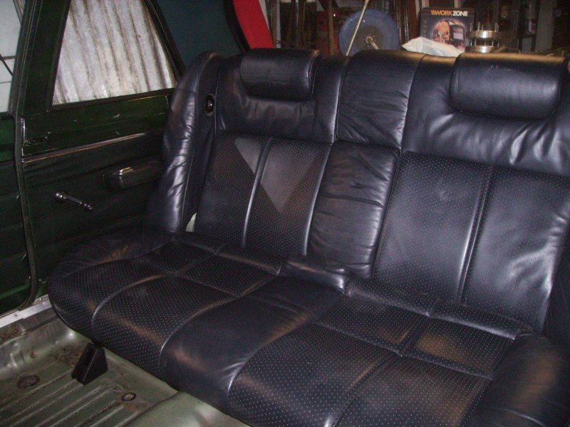

i thought it's time to start fitting the scorpio seats so when i got in today i dug the rear and a front seat out of my van. a quick offer up of the rear and the width is about spot on, the back sections will need shortening at the bottom so the base will slide back under them but that'll be easy enough. once they're mounted i'll see how much of a job making the front's 'tip' for rear seat access will be.

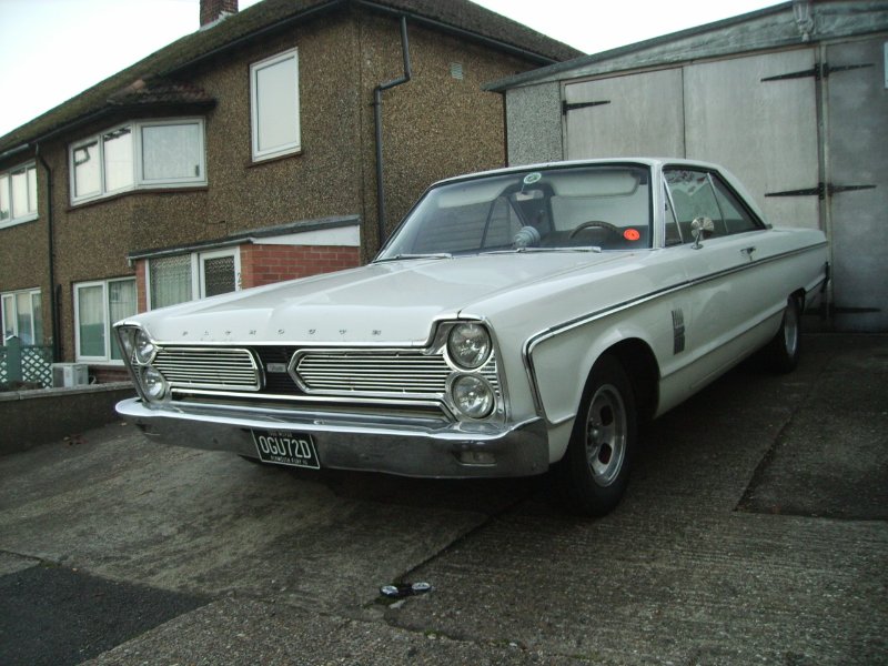

as an aside i borrowed this '66 fury back from a mate as i needed a car to 'do' a wedding tomorrow. i had it briefly some 10 to 15 odd years ago and painted it then before selling it. the new owner wanted the poly 318 taken out for a 440 instead and proceeded to strip most of the car, selling the 318 and box and buying a 440/727 from duncan watts. the project stalled and he offered it back to me so i knew a mate was looking for something to build so he bought it. it's been back on the road now about 18 months and i thought it'd fit the bill for this wedding.

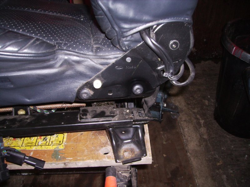

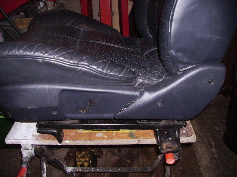

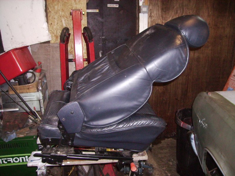

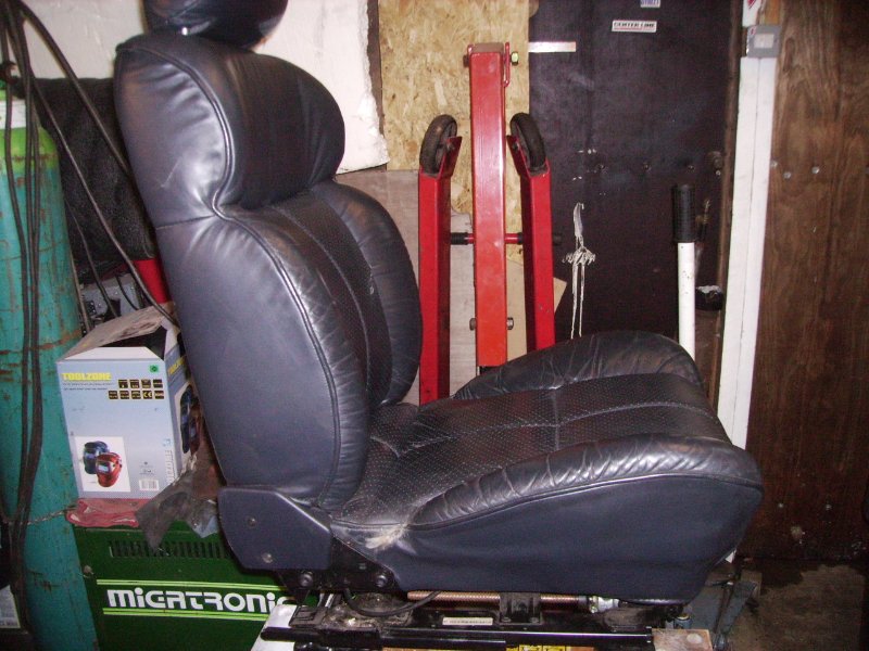

next job was to see how i could get the scorpio seats to tilt for rear seat access in my 2 door car. i removed the plastic side covers and straight away could see it would be an easy job 8-) . the backrest is held to the base with a basically triangular bracket each side with 2 bolts to the base and one to the backrest. so first i removed the rear bolt each side and loosened the front and hey presto a tilting seat. to keep it from reclining too far i slotted the rear bolt hole and refitted the bolts loose. now it tilts and has as stop when it's back. last part of the job was to cut the plastic cover in 2 as it screwed to both the base and the back of the seat. oh, and i ran a pair of wires to the 'feed' plug to check all the electrical functions which all work fine. i just need to loctite the bolts so they don't back out in use.
one seat done and one to do :thumbright:

My VW van drivers seat used to hinge like that as standard
MOT man never liked it
seat back must be fixed in upright position.
my protest was that they were and its been like that sibnce 1966. No way could i suddenly end up lying back facing the roof while driving as the seat back was locked from going back.....
and the seat back could only go forward if i wasn't seated in the seat
his interpretation was it didn't matter which way.. so i changed MOT stations
luck of the draw with the tester
Other than that
What a nifty way of getting cool seats into a 2 door.....
Nice idea.....
any problems test wise do up drivers seat tight and take out the other when you go for a test
access to the rear is open via passenger side and the seat back on drivers side is fixed.... can't test the other seat if it aint there.
