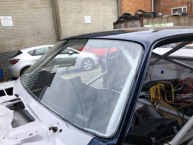

Fitted the new AMD windscreen, after installing the clips for the reveal moulding .

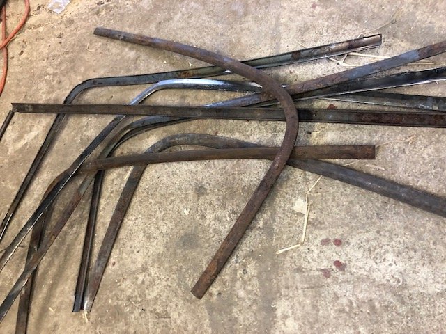

Used 10mm butyl rubber strip. All went well until I left the car out in the sun and the screen started creeping down over the course of a day. Managed to slowly and gently wedge it back up again and then installed rubber blocks underneath (which I should have done to start with...) I started work on the reveal mouldings at the same time. The car came with several sets for the rear screen , however they all look like they've been in a bonfire. I cannot imagine why.
Fortunately it buffed out , but took a lot of time and effort

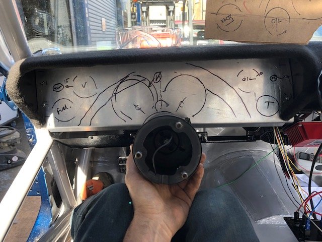

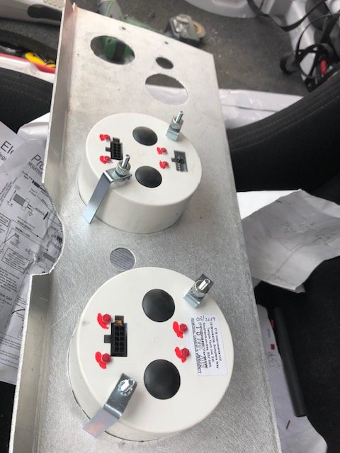

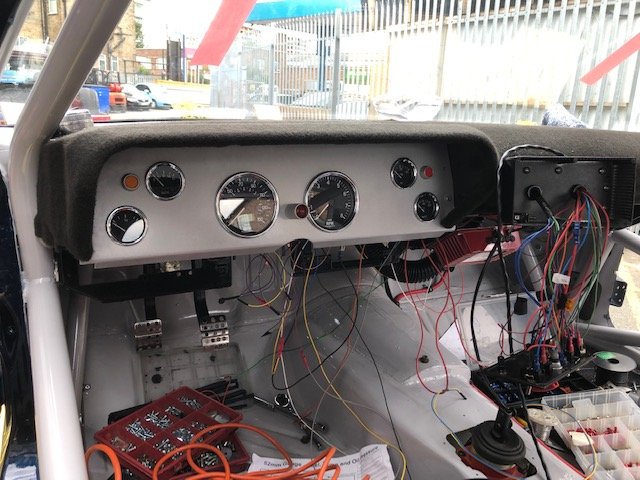

Carrying on with the wiring, time to install the dash. Sat in the car holding the steering wheel in mid air, and drew the gauges on where I could easily see them.
I had thought about getting gauges from the States, but ended up using a British company ETB Instruments. Quality looks nice . I went for full electronic speedo, as the Tremec box has a compatible sender built in.
The amber warning light is for the alternator, the red one for the oil pressure. I've been saving these for ages - they came from a generator control panel and they're beautiful quality. Only problem is they take obsolete telephone 'slide' bulbs, but I found some on ebay without too much difficulty.
The larger red light in the middle is a shift light, which runs directly off the tach.

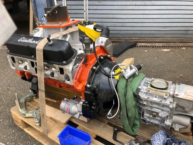

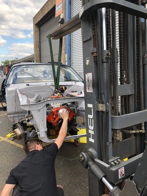

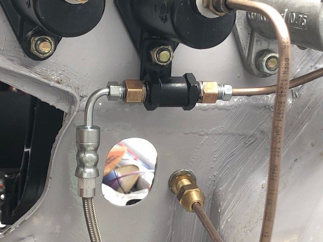

Engine mated to gearbox with hydraulic clutch release bled and attached
Dropping it in - hopefully for the last time in a while.

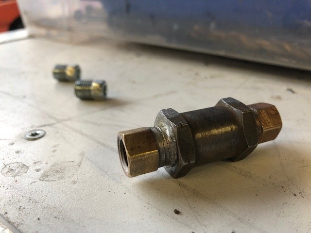

However since the clutch master is in a non- standard position, the flexible hose from the release bearing won't reach. Difficult to find a union to extend a male 3/8 fitting with a female flare. Fortunately I had a couple of 3/8- M10 adaptors in the parts pile, and they were an average fit into a BSP coupler, so I screwed it all together and soldered it up to seal the threads.

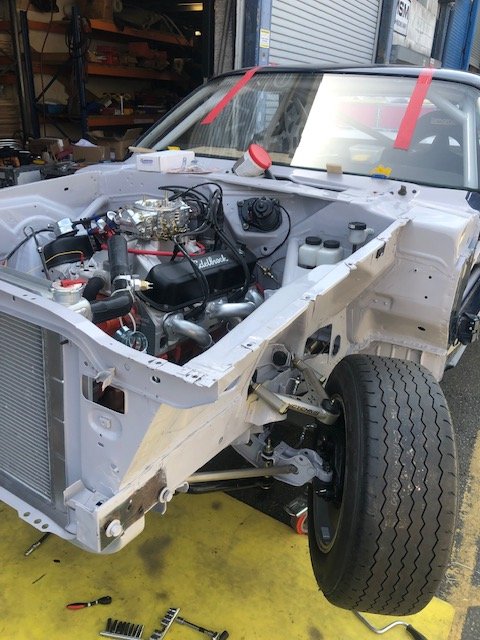

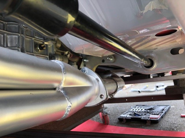

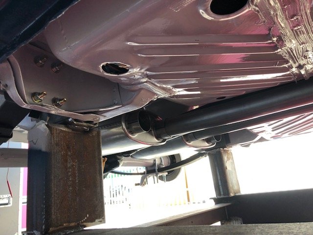

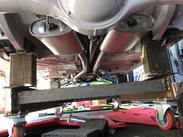

Starting on the exhaust system.

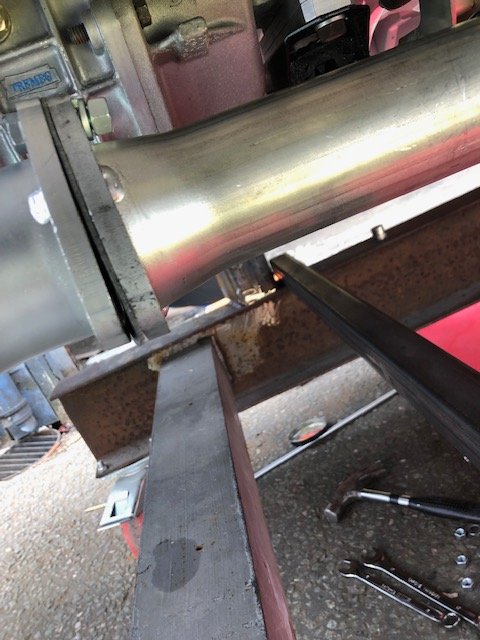

Despite the fact that the Tremec transmission will not install *any* higher , since it's about 8mm off the Torsion bar crossmember, I still get the impression that the engine/trans assembly is tilted back more than standard.
Quite a lot of clearance between headers and crossmember, and tti headers and H-pipes not meeting at correct angle.
Hopefully there will be enough ground clearance once it's all done.

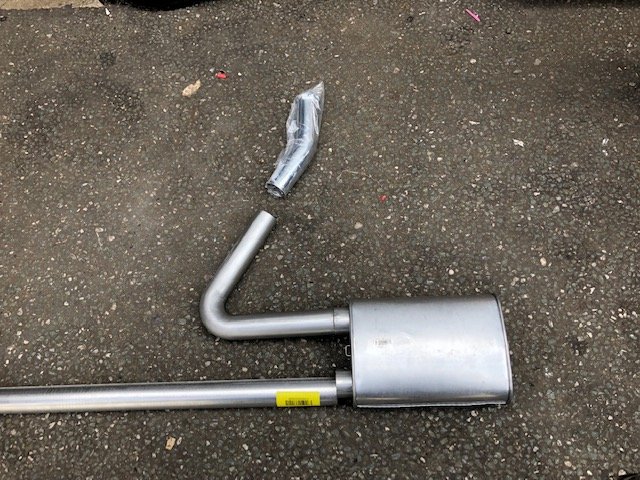

The intention is to have a side exit exhaust just ahead of the rear wheels like on the race cars. I've bought a selection of standard parts which should let me accomplish this, however I'll wait till the car's on the ground before going any further as I'm not sure if there are going to be any ground clearance issues with the exit pipes.

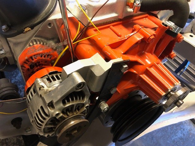

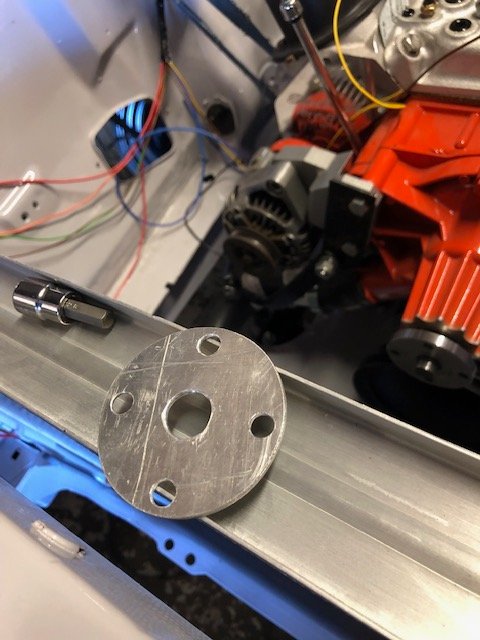

Mini Denso alternator and bracket bought from a member a few months ago.
Had to make a 3mm spacer to bring the water pump pulley into alignment

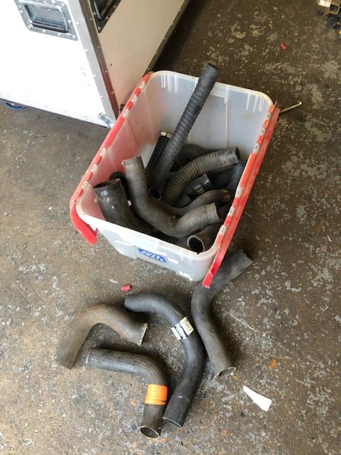

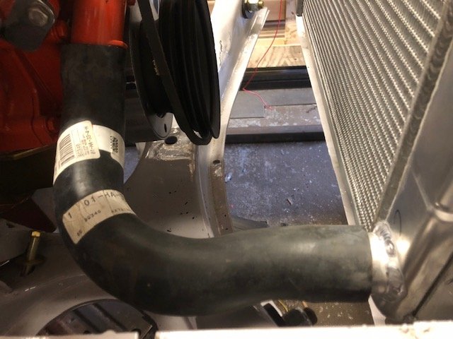

Modified Ford radiator in place . Raided the hose box, and happily found that a B-Body big-block lower hose (although I think it's mounted back to front..) is just the job.

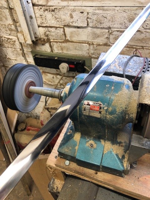

Yes thanks Super Sloth the stainless is looking much better . I could probably do with a polishing mop that isn't forty years old, and the right sort of buffing soap, but I'm pretty pleased overall.

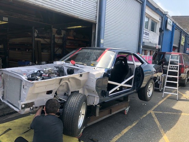

General assembly continues without any major hiccups.

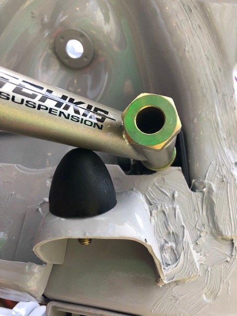

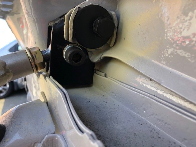

Hotchkis front suspension all OK
Instructions confirm you will have to grind for clearance around this allen bolt
but don't mention the fact that front of A-arm may foul frame rail near pivot on rebound. Soon cured with the grinder
Dr Diff brake conversion kits good so far, but instructions either vague or lacking. No torques given for any fasteners.

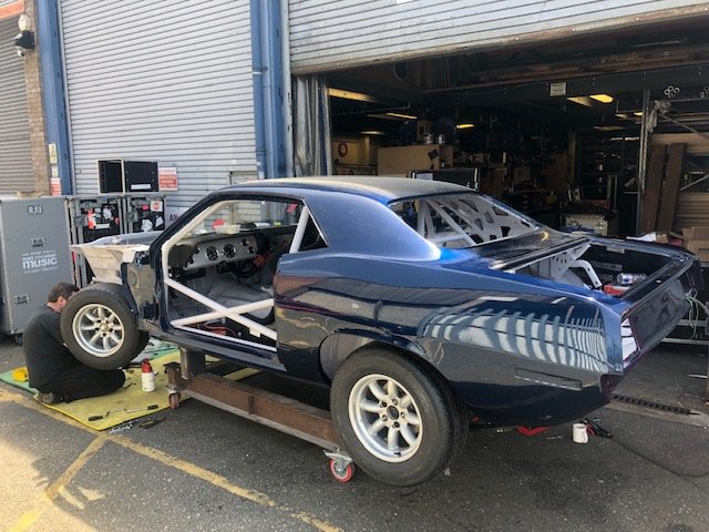

Definitely startng to look like a car now . Doors and wings are still with the painter, and now he's gone on holiday for a week !
I'm about to order some real Minilite wheels in white which should give me a more authentic look.

I have a box of similarly aged mops and soaps from my Grandfathers old metal finishing business.
If it works don't knock it! I think many of us would have written them off as a lost cause.
If you know your fastener diameter, thread pitch and strength there's little tables you can look up online to get max torque settings. Pain in the bum looking every fastener up but it gets you out of a bind when you're working with less informative kits and peace of mind that nothing is over done.
