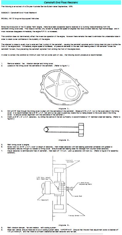

Yes i'm peculiar in running a button. but it was a factory warranty fix on many hemi 6's to solve oil pump and worn block/cover issues. so most fit something better than a welded on nut with a bolt through it on the timing cover.

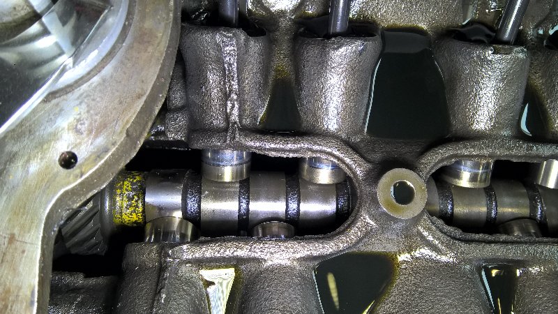

Sorry I'm confusing myself... The cam is too far BACK. In this pic you can see the dissy drive.
Is it a problem? Possibly. It inexplicably snapped a pushrod 2 years ago. The same valve has now punched a hole through the lifter. To my thinking if the edge of the adjacent lobe caught under the edge of this lifter it could lift it. Could that explain the damage? It's DEFINITELY been rubbing against it as it's ground the bottom 1/16" edge of the lifter
- WP_20170825_16_52_59_Pro.jpg (184.6 KiB) Viewed 1911 times

i run a set with a bearing on the back. the centre of the big sproket is offset to to acomodate a bit more "stuff" bearing etc between it and block when compared with a near flat single row standard sprocket. so it dictates how far back the cam sits for me.
the reason people use these on hemi 6s is that the cam sprokect used to grind its way into the front of the block. resulting in a cam that slopped too far back and too far forward once a single row standard chain streteched a bit.
not of much of a problem with a dual roller chain but, bearing and cam button os belt and braces to avoid a smashed oil pump (none made since 1982) it is still the norm on hemi 6s

Yes but witness marks on those 2 lifters shows something is clearly amiss.

Thanks Blue, yes there's no way the cam is right in relation to the lifters.
If the the cam hasn't moved and if there's no play, the best I can think of is to take the cam out and very carefully chamfer the offending lobes so they just clear the adjacent lifters. At least I can be sure I've eliminated any possible future contact.

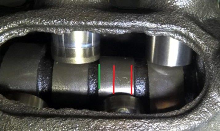

It sounds gruesome but I'm confident in my bodgery after many years of it
When I say chamfer, I mean to take a tiny amount off the rear edge of the lobe highlighted in green.
The lifter proper to the lobe only contacts the front part between the red lines, well away from my meddling.
It'll be fine
It'll be fine
- Lifters on cam 02.jpg (53.36 KiB) Viewed 1834 times

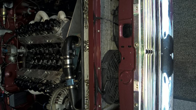

Today, thanks to the wonders of the new website, you'll be treated to live reporting as I dismantle the front of my car to get to the cam.
- WP_20170930_11_07_16_Pro.jpg (159.46 KiB) Viewed 1827 times
