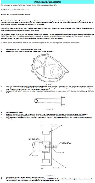

so if we assume no button
and a chain that runs straight and is decent and not stretched
that leaves 4 things
1) its always been like that and it isn't causing a problem
2) the cam has been ground with its lobes in the wrong place, nigh on impossible to do cos the cam blanks dictate where they are
3) the boss on the end of the cam is too fat or too thin
4) the drive on the end of the crank has moved forward. it can't move back i don't think and in theory it can't move forward as it is pressed by the snout of the balancer....but it might have done
but in your photos i don't know where the front of the engine is
Yes i'm peculiar in running a button. but it was a factory warranty fix on many hemi 6's to solve oil pump and worn block/cover issues. so most fit something better than a welded on nut with a bolt through it on the timing cover.

so if its too far back obvioulsy it needs to come forward slightly.......Mmmmm...
i think you are going to need to look at the timing set and see whats what.
i run a set with a bearing on the back. the centre of the big sproket is offset to to acomodate a bit more "stuff" bearing etc between it and block when compared with a near flat single row standard sprocket. so it dictates how far back the cam sits for me.
the reason people use these on hemi 6s is that the cam sprokect used to grind its way into the front of the block. resulting in a cam that slopped too far back and too far forward once a single row standard chain streteched a bit.
not of much of a problem with a dual roller chain but, bearing and cam button os belt and braces to avoid a smashed oil pump (none made since 1982) it is still the norm on hemi 6s
this is not a problem i have ever heard of on a v8 motor mind, its a failing that is as far as i know unique to the hemi 6.
when you get in there it could be as easy as the sprocket has an offset, no bearing, looks the same front to back and is currently on backwards
if it has a bearing obviuously that won't be the issue
if its the cam it will have to come out and have a bit taken off the end i guess. pull the whole lot forward a few mm in relation to the sprocket
I'm guessing..........there may be other ways.
are you missing come kind of spacer on the crank behind the crank sprocket....this is where i illustrate that i have no clue about the v8 :)
but i don' think you'll know until the timing cover comes off

how does a small block cam retainer work??
have you got the right one?
this is some kind of genius they forgot to add to my motor...hence my preoccupation with other cam retention methods
