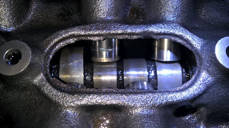

I made this piston stop tool and I've proved that the original crank tdc mark is spot on.
The cam lobes align properly with the lifters now.
With both valves closed on #1, lifters are level on #6 (near as dammit).
I think I can move on now... ;)

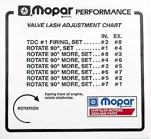

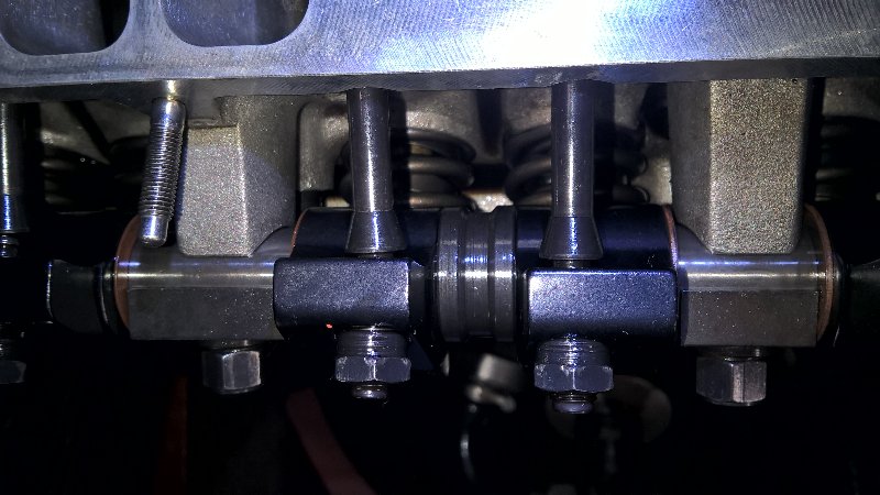

So the timing case, motor plate and water pump are back on, jack is away, rockers are all adjusted with the help of this...
Rocker adj chart.jpg (29.77 KiB) Viewed 3839 times
Won't be long now...

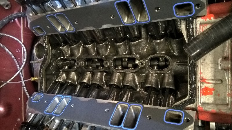

Posts: 8369
Re: db's 66 Belvedere
Because of the ally heads, normal inlet gaskets don't fit. I'd remembered this about the front and rear seals and applied a thick bead of Wurth's finest. However I'd forgotten that the side gaskets also have to be thinner than stock. The new one's I've bought won't fit so I've re-used the old ones as they're undamaged.
