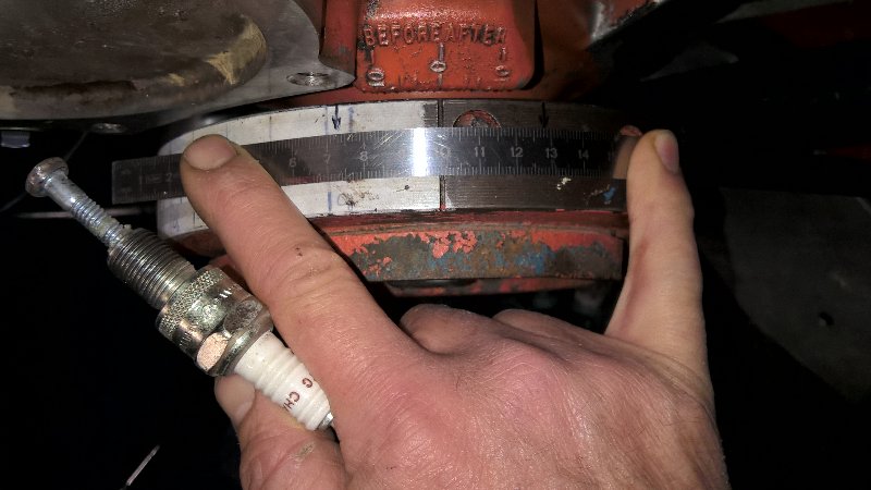

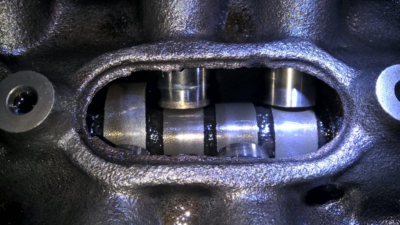

I made this piston stop tool and I've proved that the original crank tdc mark is spot on.
The cam lobes align properly with the lifters now.
With both valves closed on #1, lifters are level on #6 (near as dammit).
I think I can move on now... ;)

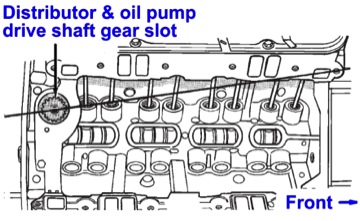

Well the paranoia wouldn't go away, mainly because the oil pump drive wouldn't line up correctly.
I gave in and pulled the timing case off and all was correct so I went away puzzled...
It was only when I was trying to explain the problem to someone who knows nothing about mechanics that I realised what it was.
I had the oil pump drive 180* out #-o
Oil pump slot.jpg (41.82 KiB) Viewed 3858 times

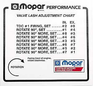

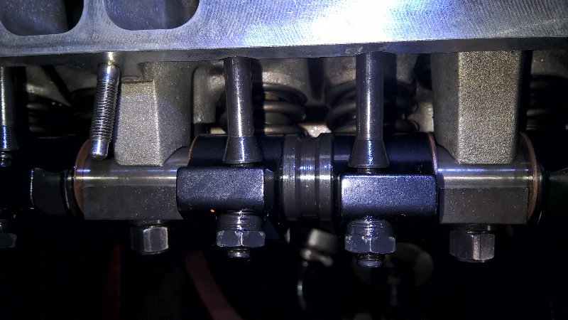

So the timing case, motor plate and water pump are back on, jack is away, rockers are all adjusted with the help of this...
Rocker adj chart.jpg (29.77 KiB) Viewed 3858 times

Just for info, it isn't essential you fit the oil pump drive in that position. You can just drop it in anywhere and all that happens is no1 will be at a different position on the cap so you just move the plug leads around to suit. The only thing that might happen is the vacuum can could end up in a less than desirable position when you do that.
