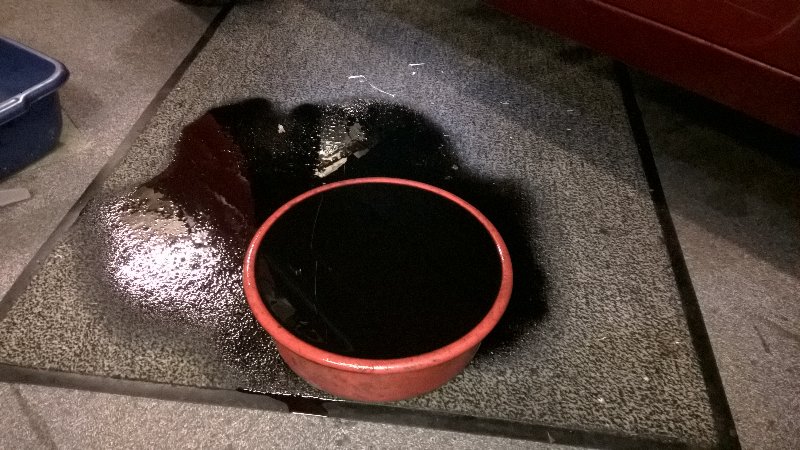

Another important lesson... Check your continer is of adequate size for the quantity of oil in your engine...

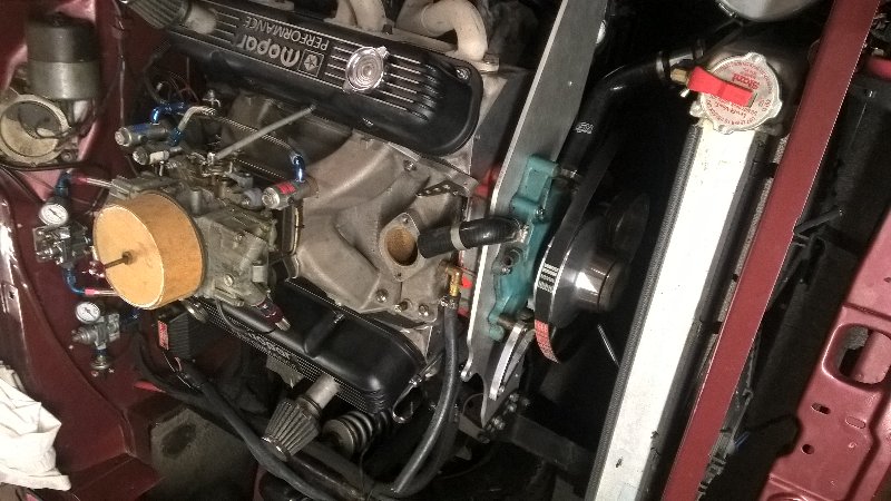

Well after a shaky start I made some decent progress this evening

Re: db's 66 Belvedere
So what have you done to position the cam in the correct place ????
Oh balls, don't be throwing doubt in my mind again mate!
I've screwed the bolt into the end of the cam with the dished washer so it pulls the gear onto the cam. I can't remember now but the gear must sit against a flange or shoulder on the cam? Anyway the chain lines up and there's no fore/aft play so I'm sure it's right now.
Well I'm VERY happy and not a little surprised to report that my first drive of the Belve since rebuilding the motor was a complete success
NO cockups, nothing fell off, I remembered to pre-pump the oil, I got the oil pump drive and dissy in the right position first time, it started instantly and kept running, I just had to tweak the timing 10 degrees or so. I hooned up and down the A55 from junction to junction half a dozen times, including a nitrous run for the last blast under the tunnel. No breakdowns, no horrible noises and NO LEAKS! Not a single drip.
It didn't want to idle when I was parking it up, probably just needs some fine tuning. Happy days
