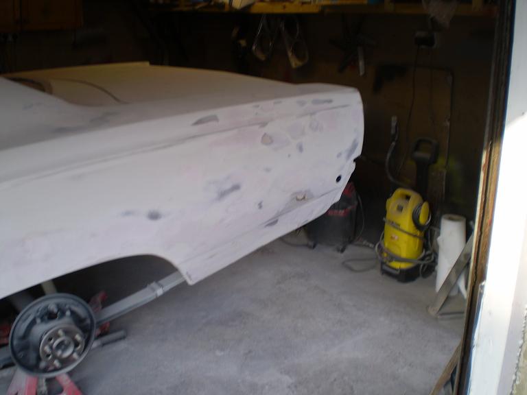

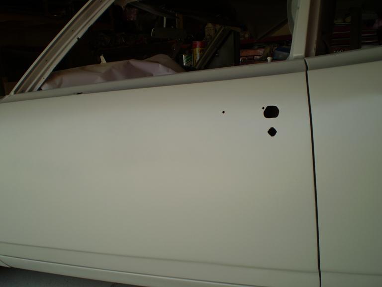

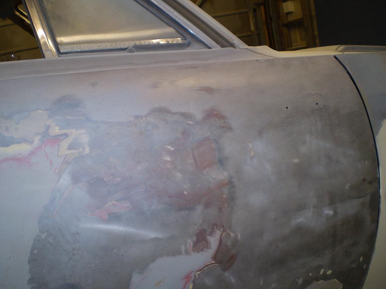

driver door wasnt to bad two small patches in both lower corners then more filling and painting to get both rear wing and door straight
Posts: 13003
Is that a ripple I see in that door?
Nope, thought not! :D ;)

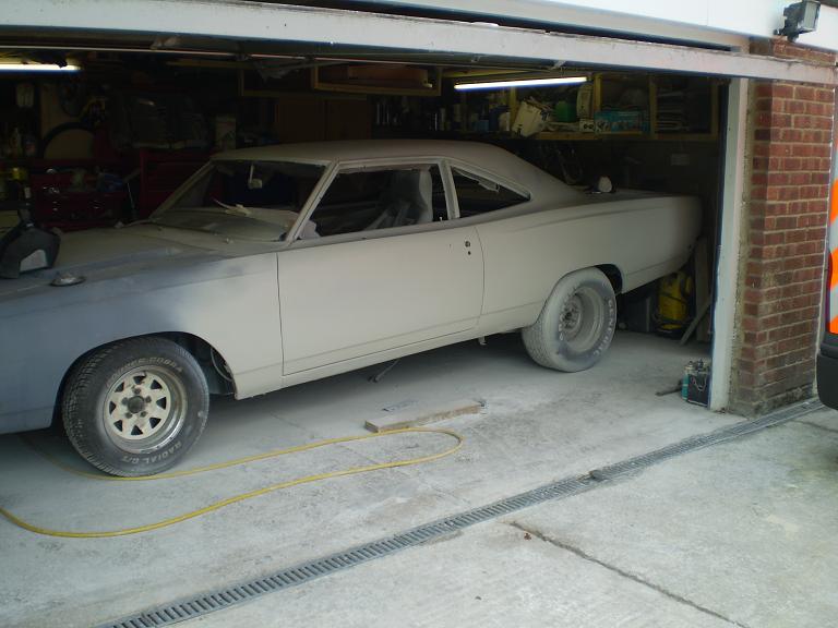

Hiya Nick,
Just seen this thread, cant believe the Chevy's gone but wow what a fantastic replacement, an original post car :thumbright:
Cant wait to see the progress on this one mate, what are the plans? Colour, wheels etc?? or are you keeping it close to your chest for now?? 8-)
Posts: 5254
fantastic stuff :thumbright:, and great garage/workshop you have there 8-)

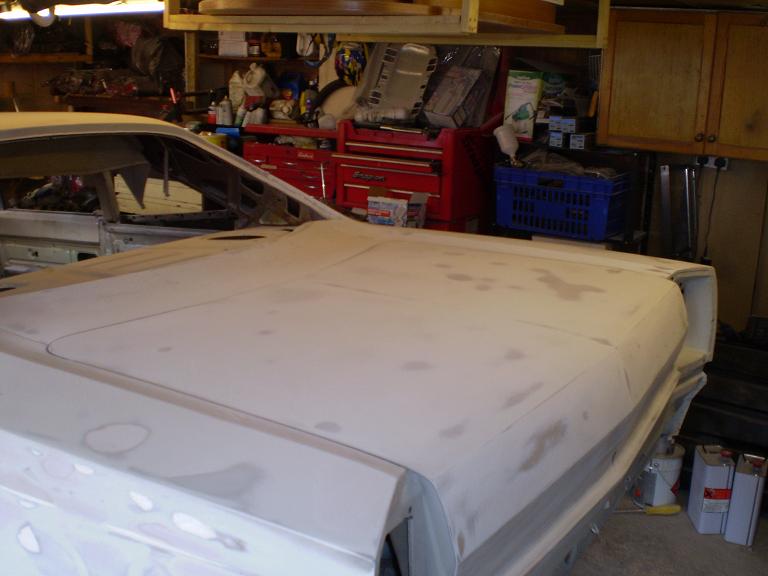

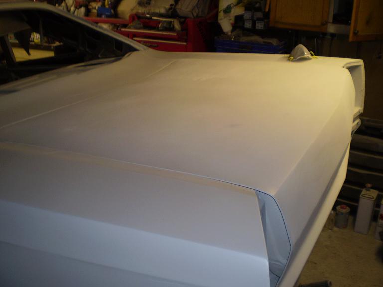

boot was in great condition just a few high and low spots

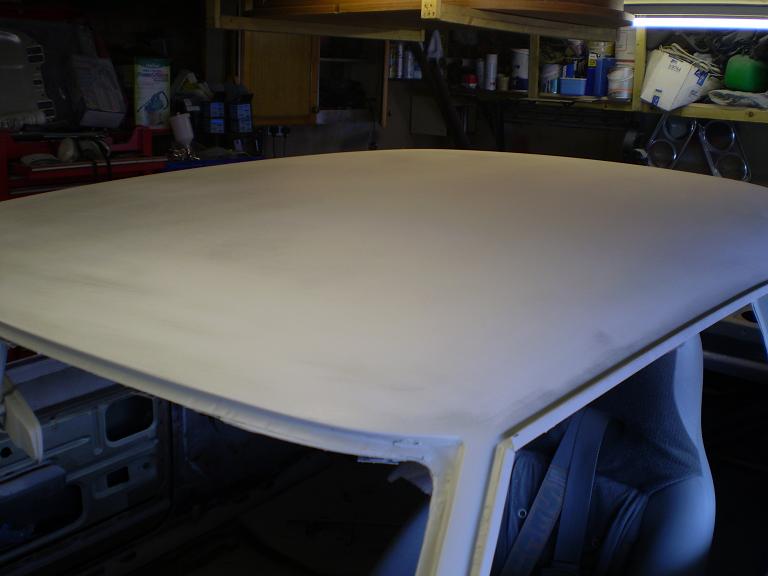

rear panel had two small patch panels roof was good

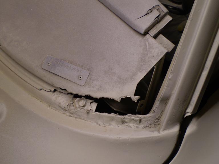

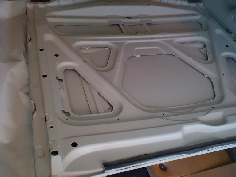

Post by Anonymous »

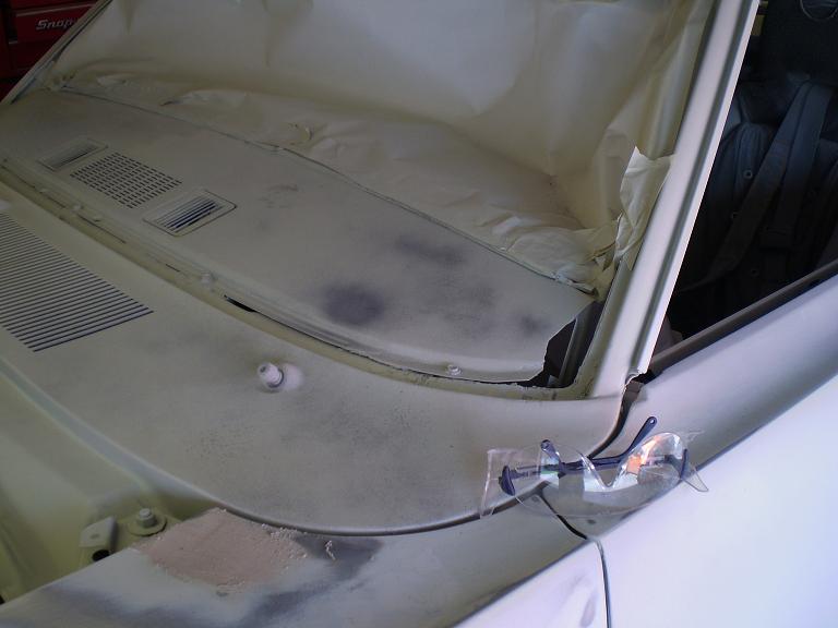

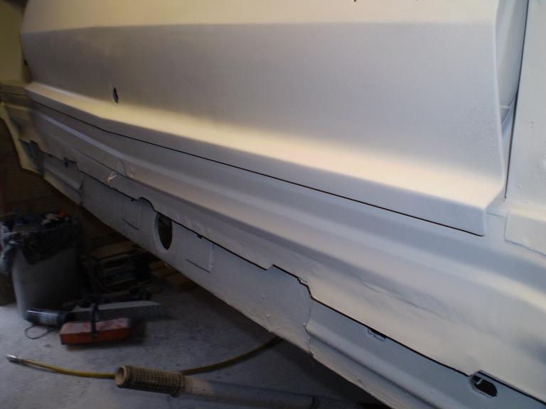

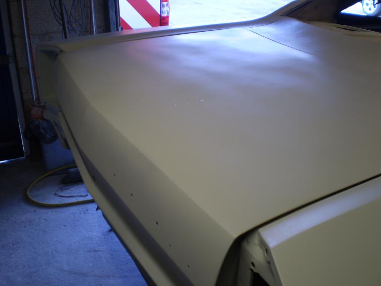

underside of bonnet was grit blasted came up great two small pin holes repaired. front screen valance was rusted drivers side. cut out and welded a small patch, when the screens in it should be a ok repair.
Picture 015.jpg (48.21 KiB) Viewed 2323 times
Picture 005.jpg (43.61 KiB) Viewed 2323 times

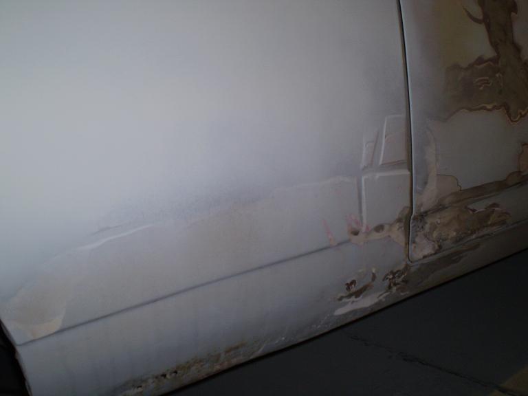

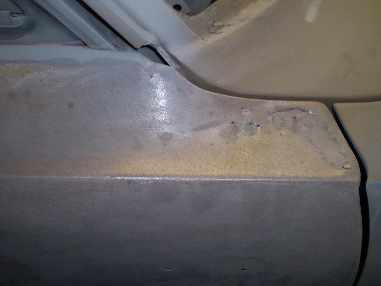

Nick Eagle 68 Roadrunner
Post by Anonymous »

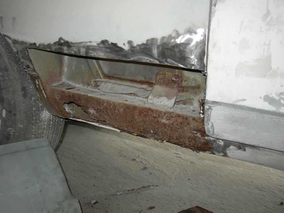

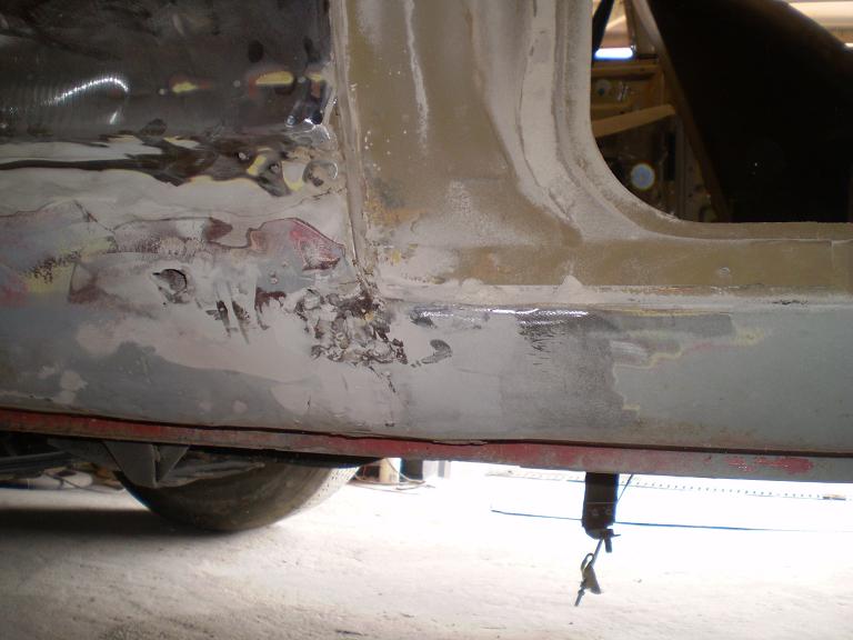

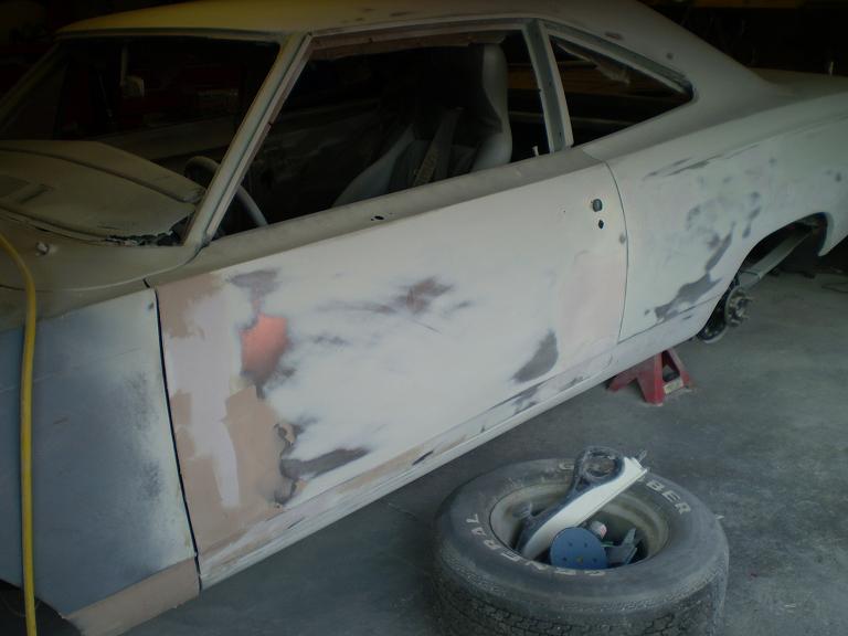

Nearside rear quarter panel and had 10mm of filler. the bottom of the door was rusted out and front of the rear quarter was the same
Picture 008.jpg (57.3 KiB) Viewed 2313 times

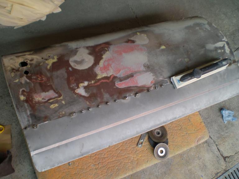

Post by Anonymous »

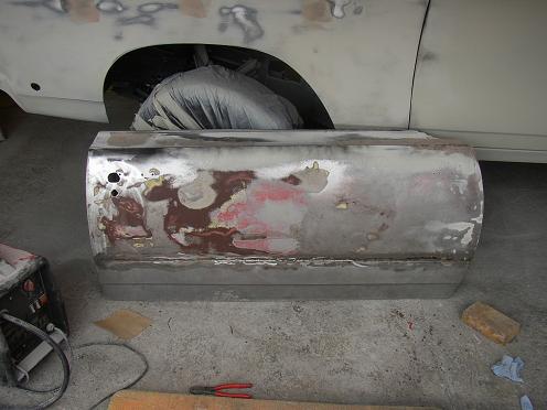

door had a new lower skin repair patch from roc autos.

cut out the rusted rear quarter
Picture 021.jpg (93.48 KiB) Viewed 2298 times
