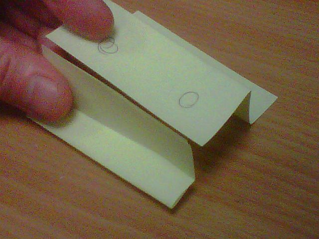

Dave wrote:I think folding two halfs and seam welding them down the middle is probably the easiest way of recreating them with basic garage tools. ie vice and hammer.
Think i will go for this first walk before i can run :oops:
Dave is this what you mean made from 2 parts and joint down the middle
Dave-R
Posts: 24752
Post by Dave-R »
Yes because to bend a complete chassis rail with just a vice and a hammer is going to be tricky as it is a lot more narrow than your bit of card.
Also if you do not have steel hole cutters it would be easier to drill and file the holes in two halves too before welding together.
