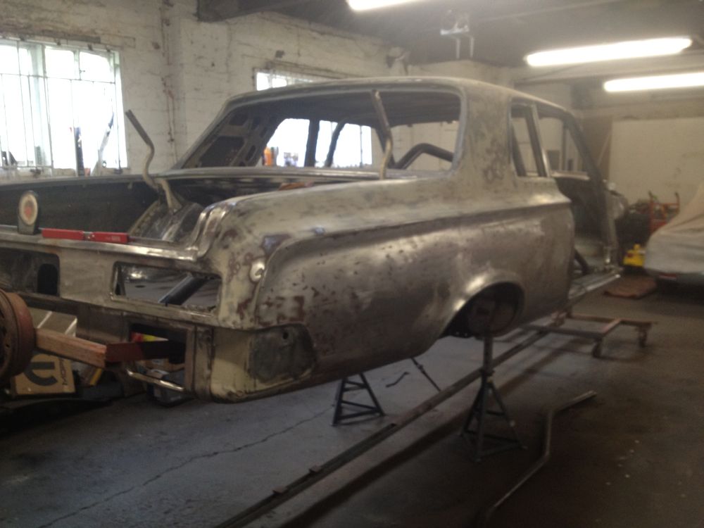

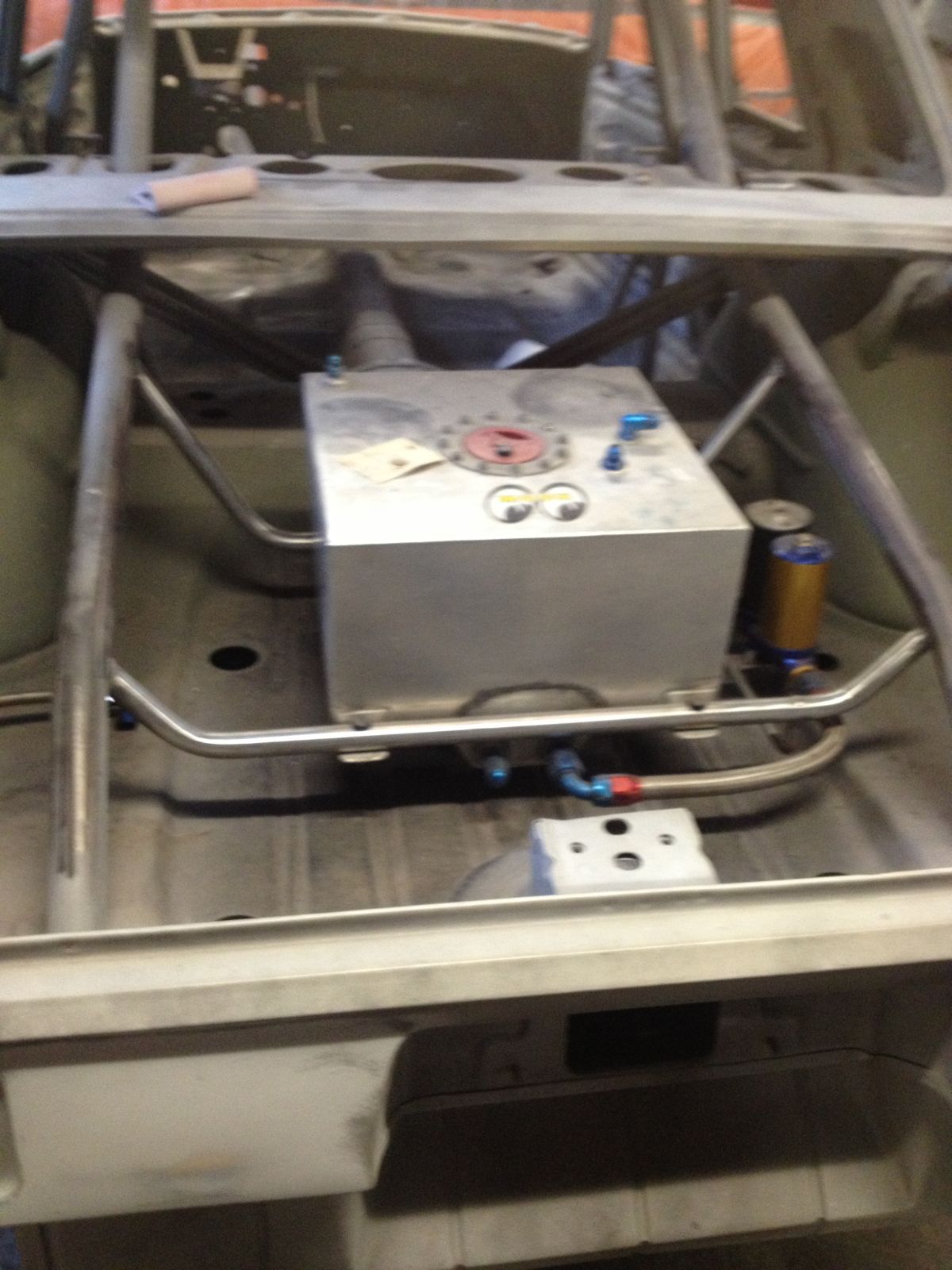

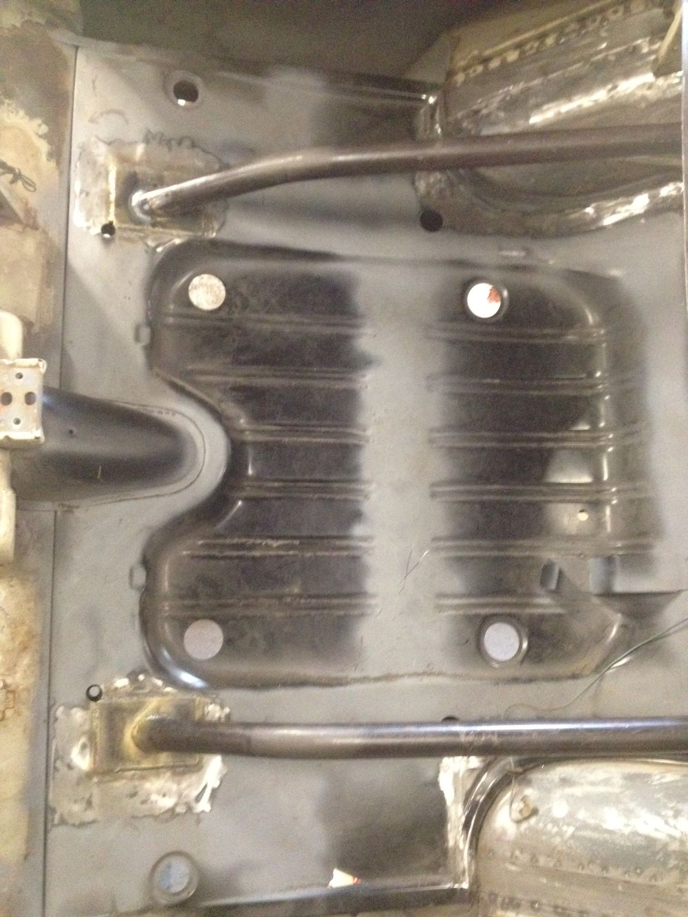

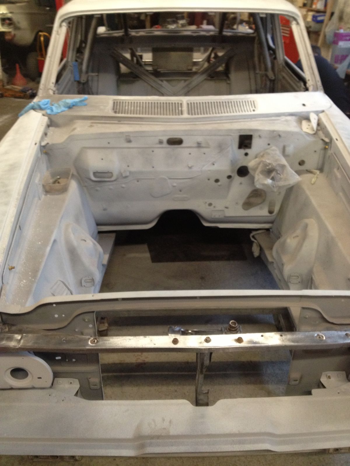

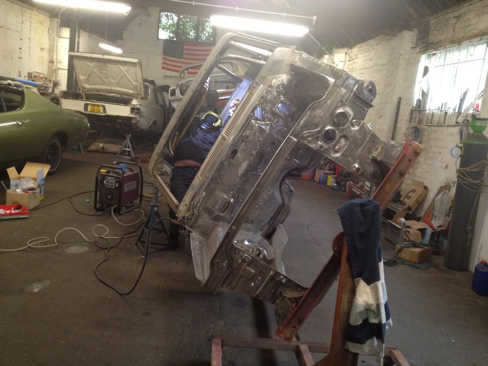

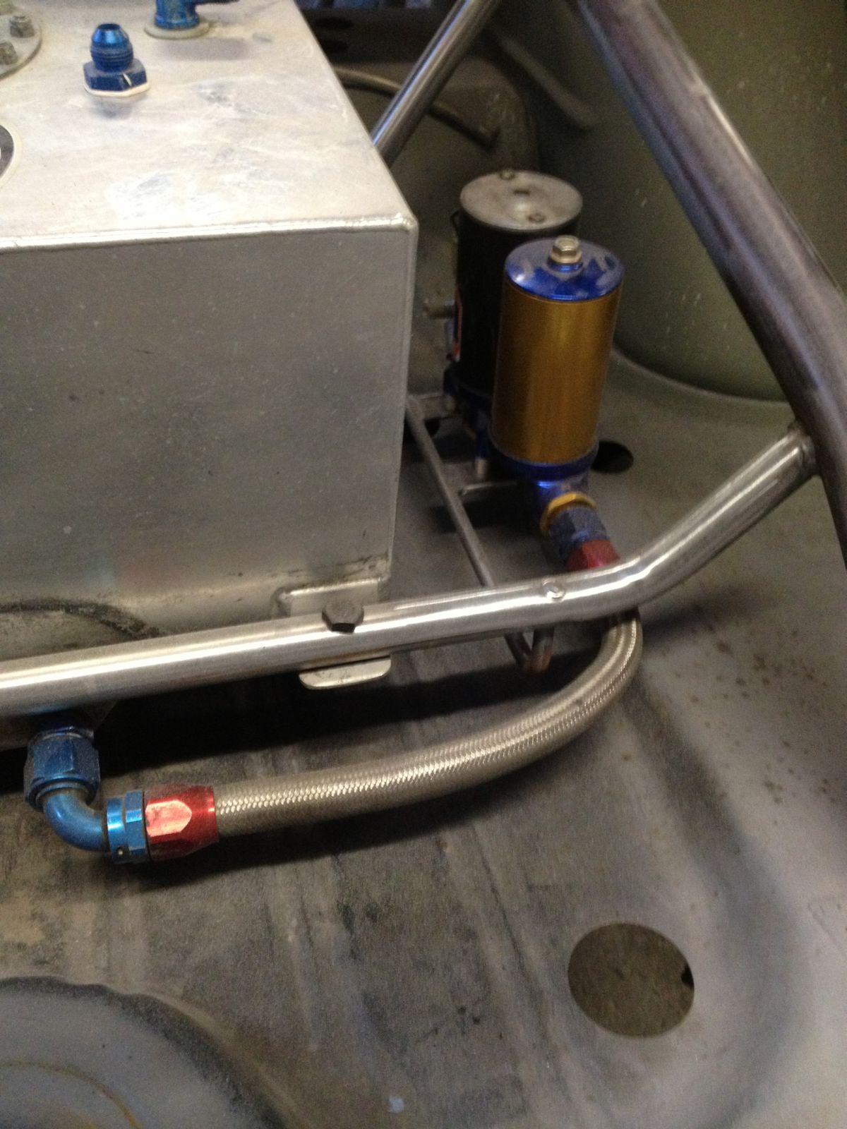

Not updated this for a while, the car has been progressing steadily, all fabrication work is now completed, Craig has in-boarded the springs and minitubbed the car, and installed the chassis connectors, me and Marc have been down again today and have finished off the welding on the cage so craig can now put the car in the paint shop, he is painting the underside whilst on the spit, we will then go back install all the suspension plumb the brakes and fuel lines and run the main battery cable, it will then go back in its wheels for Craig to paint the body and inside the car.
All the interior is now trimmed, just waiting for the headliner and carpet from Kramer Automotive (would reccomend anyone to use them, very knowledgable and helpful), The motor is built (Thanks to Dave B), Craig is about to freshen the trans and install a steel drum and bolt in sprag.
Hopefully will have some more progress shots in a few weeks
the rotiserie makes welding the cage much easier
IMG_1781 edit.jpg (119.98 KiB) Viewed 2640 times
IMG_1779 edit.jpg (97.72 KiB) Viewed 2640 times
IMG_1778 edit.jpg (82.66 KiB) Viewed 2640 times
cage with swing out door bars and removable rear seat bar
IMG_1775 edit.jpg (155.95 KiB) Viewed 2640 times

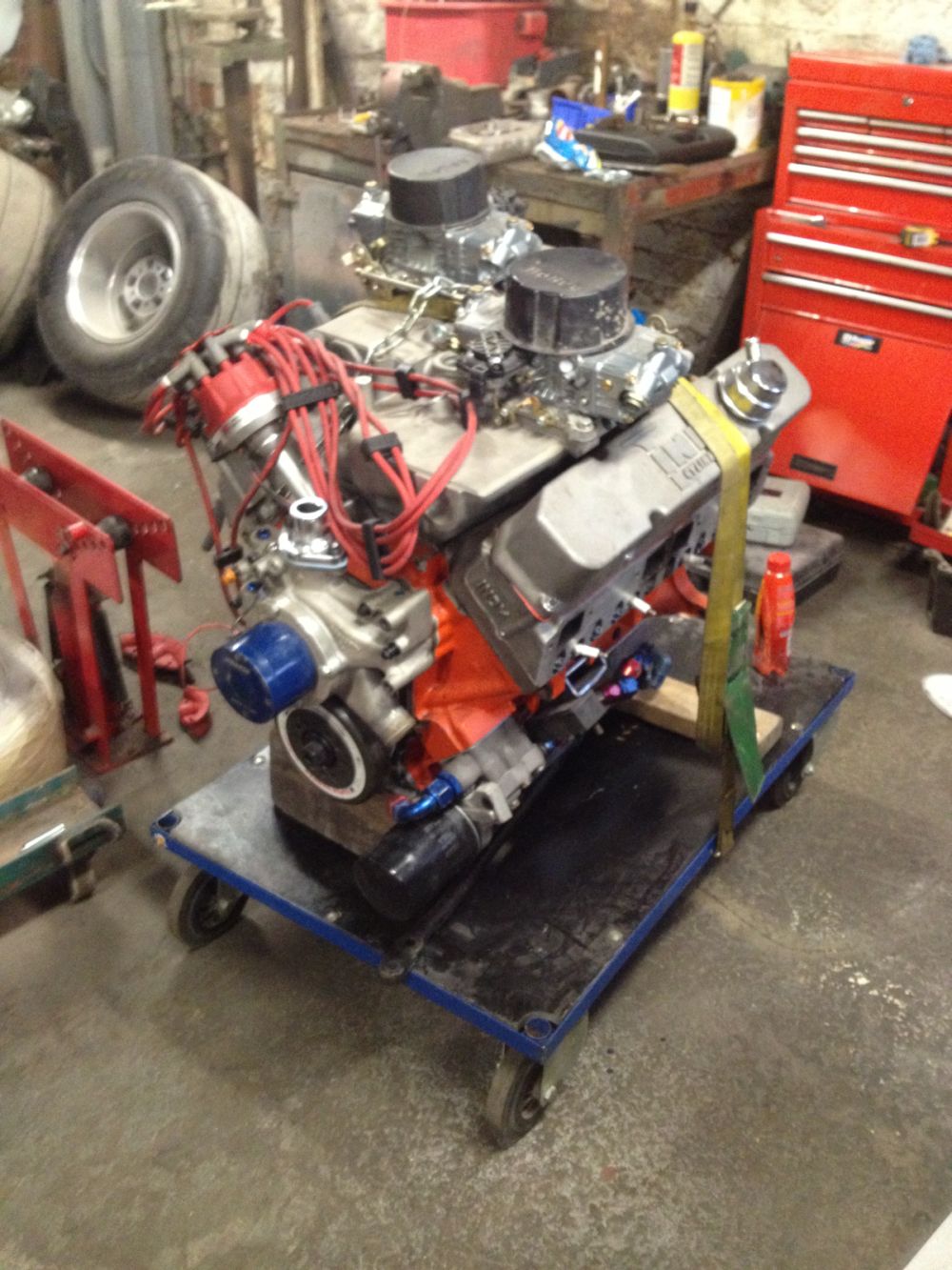

more pics from today
front seats
front seats

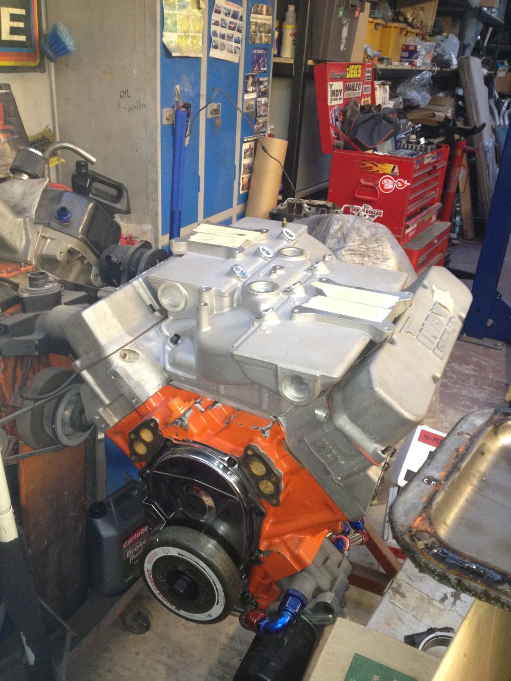

Motor
Motor
IMG_1713 edit.jpg (228.74 KiB) Viewed 2635 times
IMG_1782 edit.jpg (192.95 KiB) Viewed 2635 times

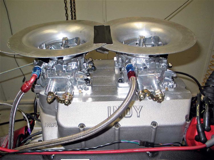

What inlet is that Jerry,,is it Indy ,,,got a part no????
Jerry Smith
Posts: 396
Post by Jerry Smith »
Pete its a A&A trans manifold the indy ones have a bolt on top so you can switch set up, you can use a single 4, inline 4's 6 pack etc, for out and out racing supposed to be a no brainer but as this is been built for street/strip i went with the A&A :thumbright:
pete walton
Posts: 1403
Post by pete walton »
Thanks Jerry,i have had a look at the Indy cross rams ,they are massive,,, but they are supposed to make power...Yours will fit under a Hemi scoop.without the help of a saw... Great car Jerry :thumbright: :thumbright:

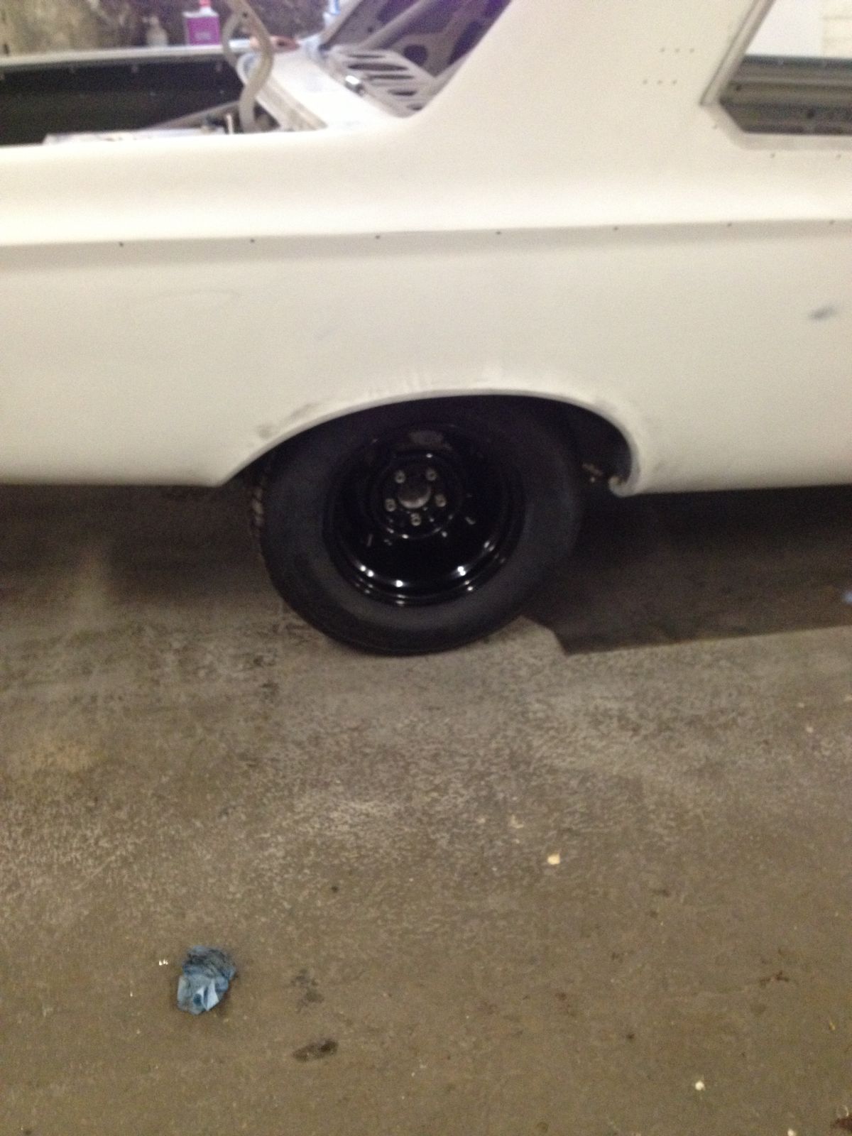

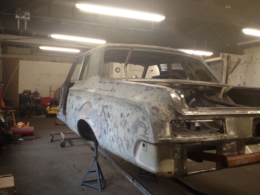

Its been a while since the last update, took the new wheels and tyres down to Craigs today, the car is looking great, Craig has put a lot of effort into this car and I'm really glad i entrusted him to do the work :thumbright: heres a few pics of the car as it is today,

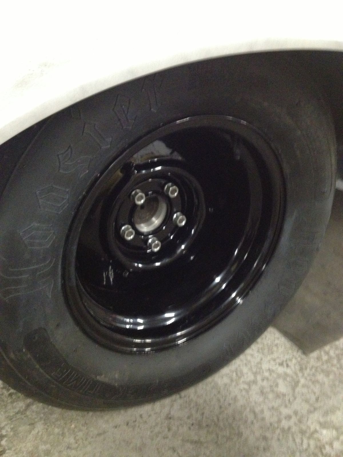

a few more pics, tyres are 325 hoosier quicktime pro's mounted on 15x10 wheel vintiques wheels, and ive adapted them to take the 10in hub cap,
