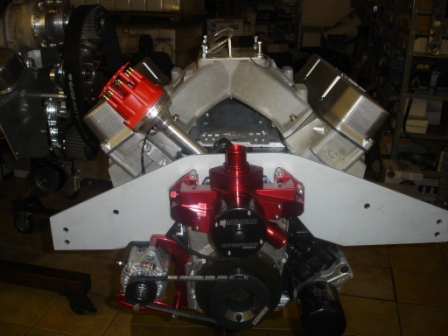

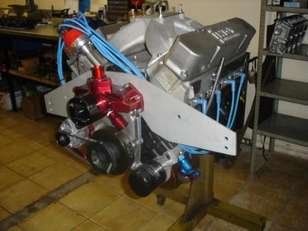

Not sure what make mine is,,got it from Kev ....Low fitting alternater from Mancinis ...so is the timing mark set... Now i am no engineer but they do not look that hard to make...And as Pete says,, fit a torque strap ,they flex no matter how powerful the engine is
Posts: 22199
OOOH! One of my heads in the background!!!
If I did not know better I would say tat is one made by Duncan's mate.
It looks the same as the one I had in the Dart............
Posts: 8369

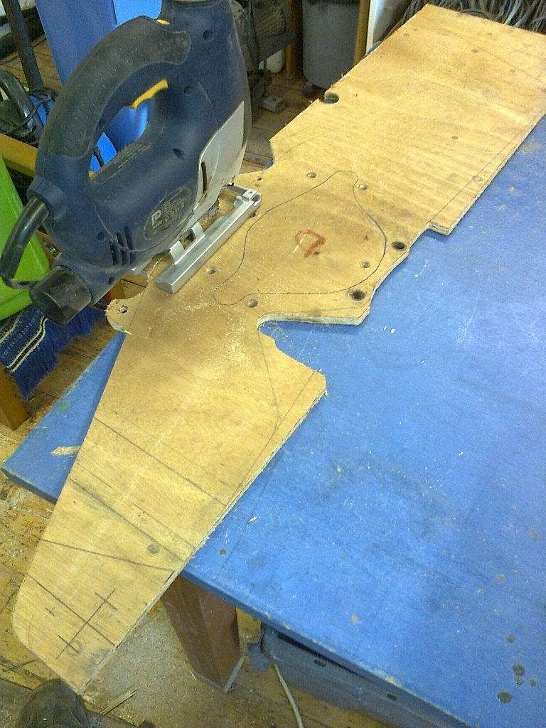

Thanks for the pics Pete. Very similar to the design i came up with! ;)

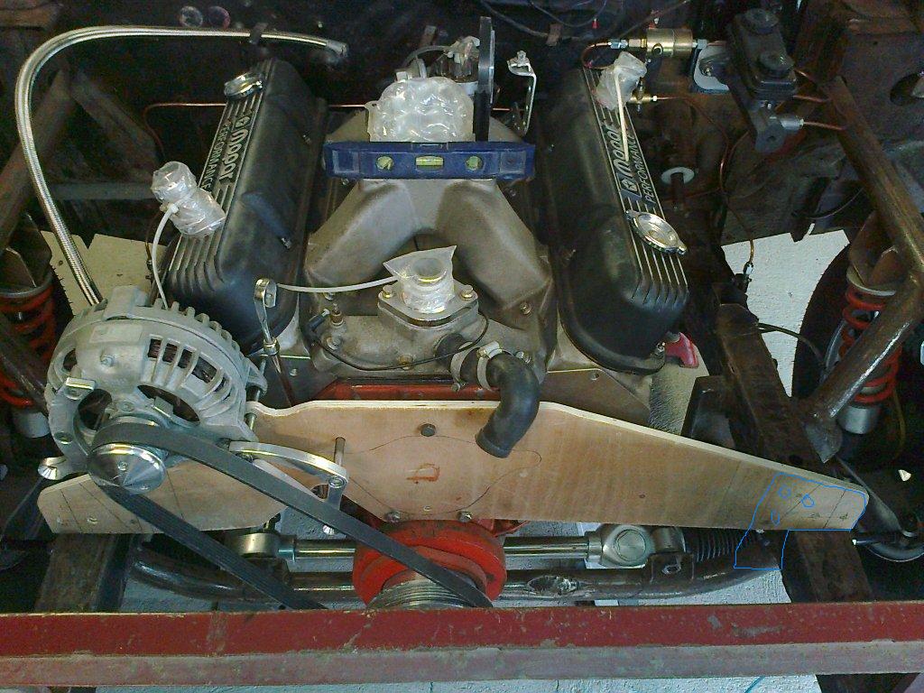

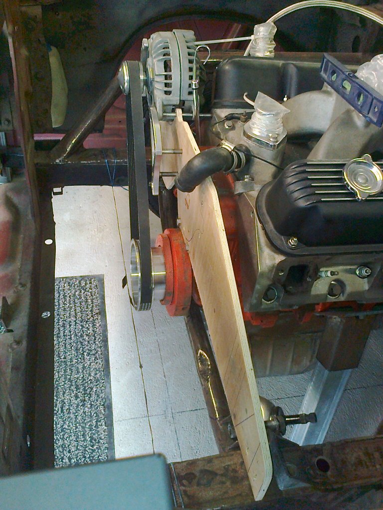

I'll need to tweak the alternator adjuster & mounts, make a few spacers and source a longer belt from somewhere, but it's looking good.
For now i'm going to extend the A-bod plate i already have.
Where should the torque strap go? Are we talking a rose-jointed bar? or two?
Motor plate template 05.jpg (180.73 KiB) Viewed 1701 times
Motor plate template 04.jpg (179.3 KiB) Viewed 1701 times
Motor plate template 02.jpg (164.73 KiB) Viewed 1701 times

It's Fore and Aft movement that you need to control.
Take it off the engine mounts and to the chassis - use both engine mount lugs - they have been known to break just one :shock:

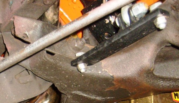

You should have enough room to put a torque strap on your driver side head to the chassis rail or K frame
A tube with 2 rose joints - 1 bolted into the end of your head existing thread and the other onto a piece of angle welded on the chassis rail / k frame
Here`s a pic of mine ( mine was on other side as I didn`t use an alternator )
Hope it helps
