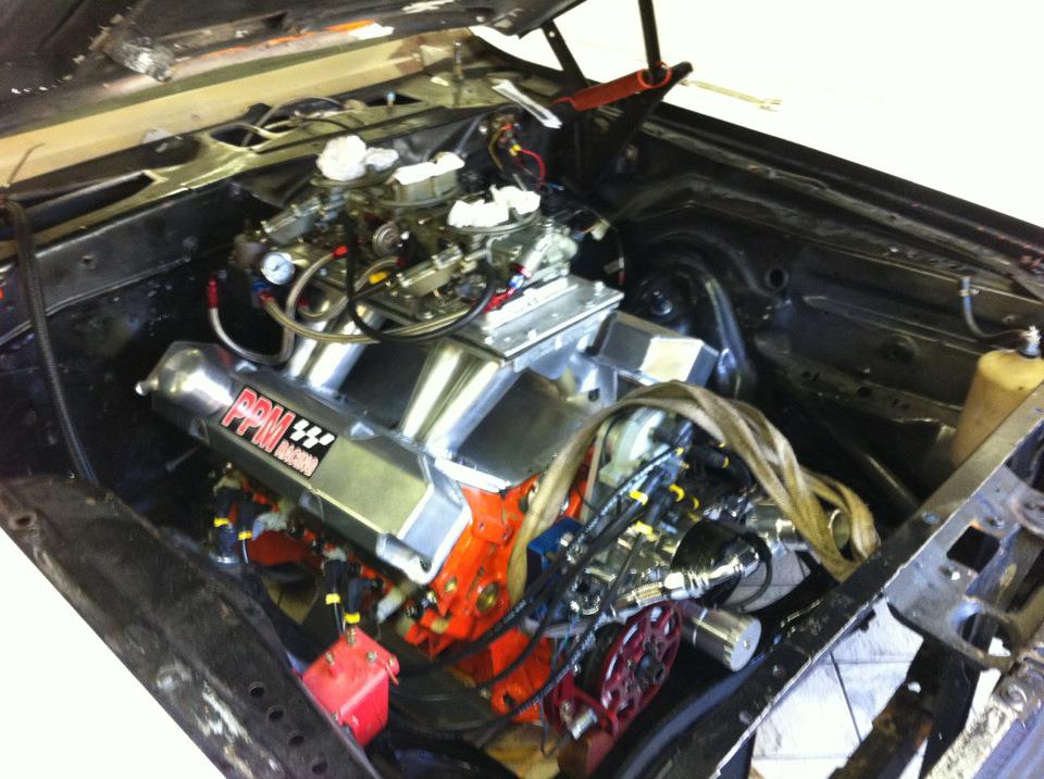

Cannonball wrote:using a good back halved car coming in at 3,050 with driver its going to take circa 800hp to run 9.2s if all is in your favour,
rays dart is 3,100 with driver that has an honest 700-20 hp and runs 9.7s
that is one hell of a 440 to make that sort of power and i would think would need to flow enough air to rev around 8,000rpms tpo make that hp
Yeah, I think I'm a bit out with the ET's/weight etc Dunc...was basing it on my 9.96 at 3300lb at about 630hp +100hp for the PPM motor which is normally 8th's or so worth....but I guess it don't quite work like that always.......would've thought ray could do a bit better than 9.7's though.at 700/3100?
he has a glide in the car lez and maybe that is hurting it a little, reason for this is it came with the car as a roller and was new never run the converter is also not matched to his engine/car combination i think longterm it should go 9.50.s,
and it might weigh a bit more going off lod information on that,
have you seen the hemi darts/barracudas now lez ??? barton and other builders are making 900-1000 hp from a iron 426 hemi i think they leave the line at 6,000 and take em to 9,000 massive money engines 50,000 us dollars and more but amazing power,
google barton on utube built some magic engines,

I am wondering, if that six pack is a 440, if they have gone for as big a bore as possible and with a shorter stroke. Then you could maybe get it to run high rpms to make that HP.
You can only make that power with big heads or high RPM. Or a bit of both.
Do the rules allow for bore/stroke changes as long as the displacement is the same?

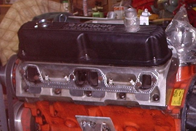

I am not certain of the rules regarding this class .But i THINK stock crank can be offset ground,bore as big as you dare,,,,They almost rebuild whats left of the runners after porting with resin ....Not sure about the cam.....I know in there stock class the cam has to run the same lift as factory specs i.e i think the 383 was .430 lift from the factory,, so your cam can be any way you like it but .430 is its lmit...I know Glens cam is all revs on the line,,,, Lifters are them fancy ceramic coated ones cost a bomb,anything else would not survive,because of the aggresive nature of the cam profile....,,,small verter and bang wheels up mentle 100 ft then driving miss daisy for the rest of the track...Les ,,hows sunny Enfield??? remember you from back when i lived in Edmonton,,,LOng looooong time ago,,you lived in Tottenham if i am correct???,,,,,

Fitted and ready to run,,,in the old Paul Rossi car
Posts: 8369
My 360 has heads ported by Mr Barton himself- good pedigree then :D

I saw the Rossi SS Car run a 10.00, that was its best I think, they may have dipped it in the 9.9's........?
So the PPM motor should be very similar? but we don't know cos the rules may be different to US SS class....same car...approx 3300lb w/driver as a guesstimate, maybe lighter now? + 700hp = 9.7's at 137 once sorted.
Anyone have any info yet on its times.....proofs in the old pud...
