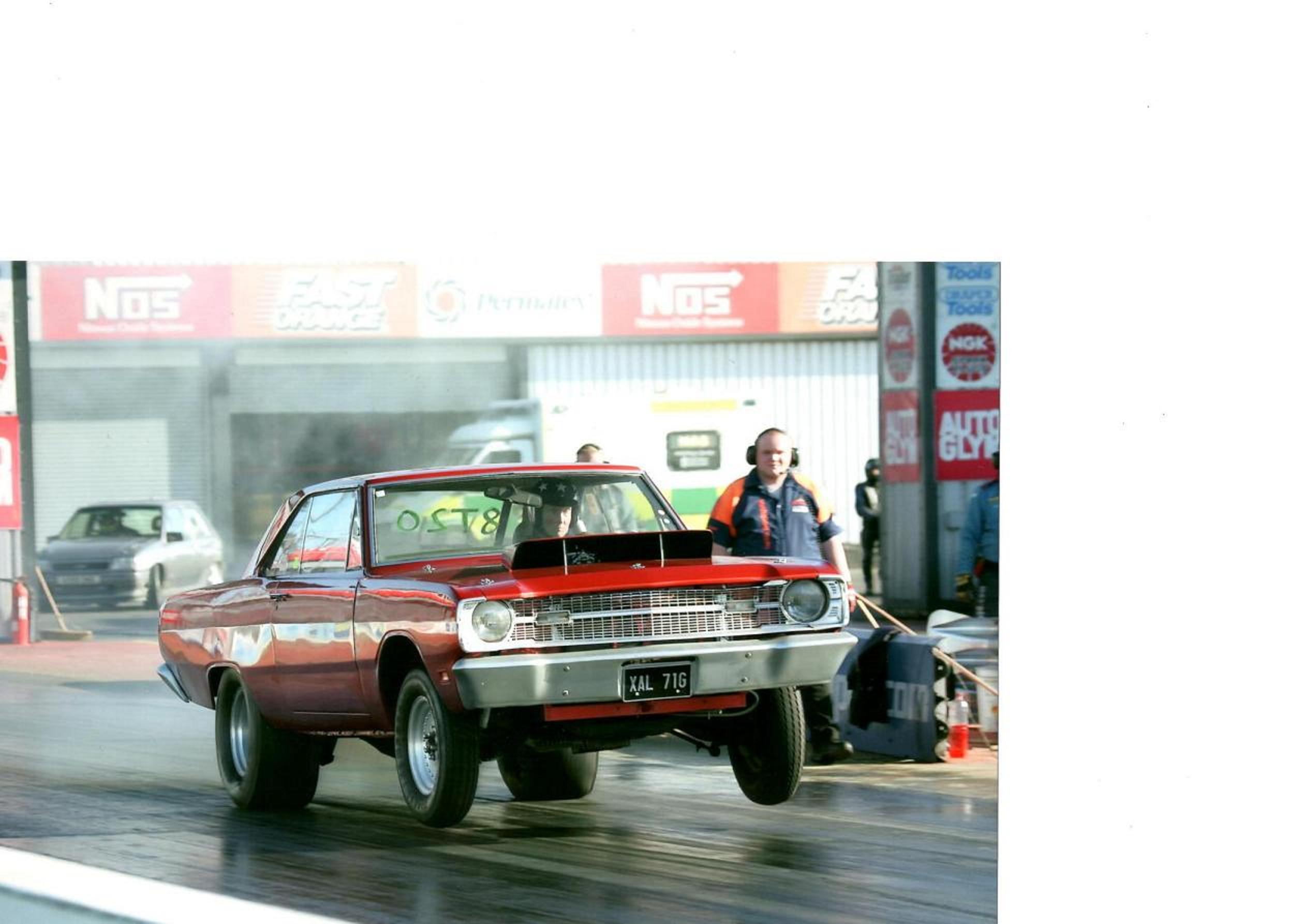

pic from yesterday
Posts: 14435
Looking good Mick, nice to see things finally coming together for you, I know you've had your unfair share of issues with the car in the past, looks like you've got a handle on it now.

Launching nice and square there Mick. :thumbright:
Posts: 13000
That is looking great Mick...no traction issue there by the look of it! ;)
Posts: 6738
Nice launch there Mick
Looks like a tailors Dummy in the seat, didnt look real to me at 1st :D

John S called me a crash test dummy LOL, my missus jumps every time i walk in the room, she cant take my good looks.
It's my race face. PV is a power valve.

Nice pick Mick...time you got it on here....yeah I remember I tried a dommy on mine, and you lose too much bottom end/response without spending days trying to sort it, but my mph went up a bit with 1...really pulled hard top end, crap low down....you can't beat a 4150 carb unless you got a brake.
What front acc pump you got on the 950 Mick.....31 or 35 extended shooters?, spacer above the inlet?....
work on them 60's and don't bother about mph too much, thats just a tuning tool.....

Off the top of my head, i think they're 35's, that pic was with the dommy on Les, it was down on top end. The 1050 was very close to the scoop, i had to cut the vent tubes down to clear, if i get a filter, i might try it with the bonnet off.

oh ok, maybe thats the answer then Mick, dommy took a bit of torque away low down enabling you to hook better on that tyre combo on the day/track cond.......better 60's = less time on the track = less mph as you know...although it should've pulled a bit better top end though if you got it jetted right.....
