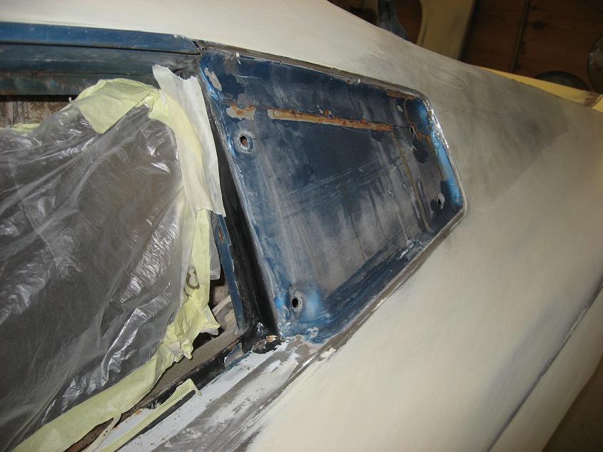

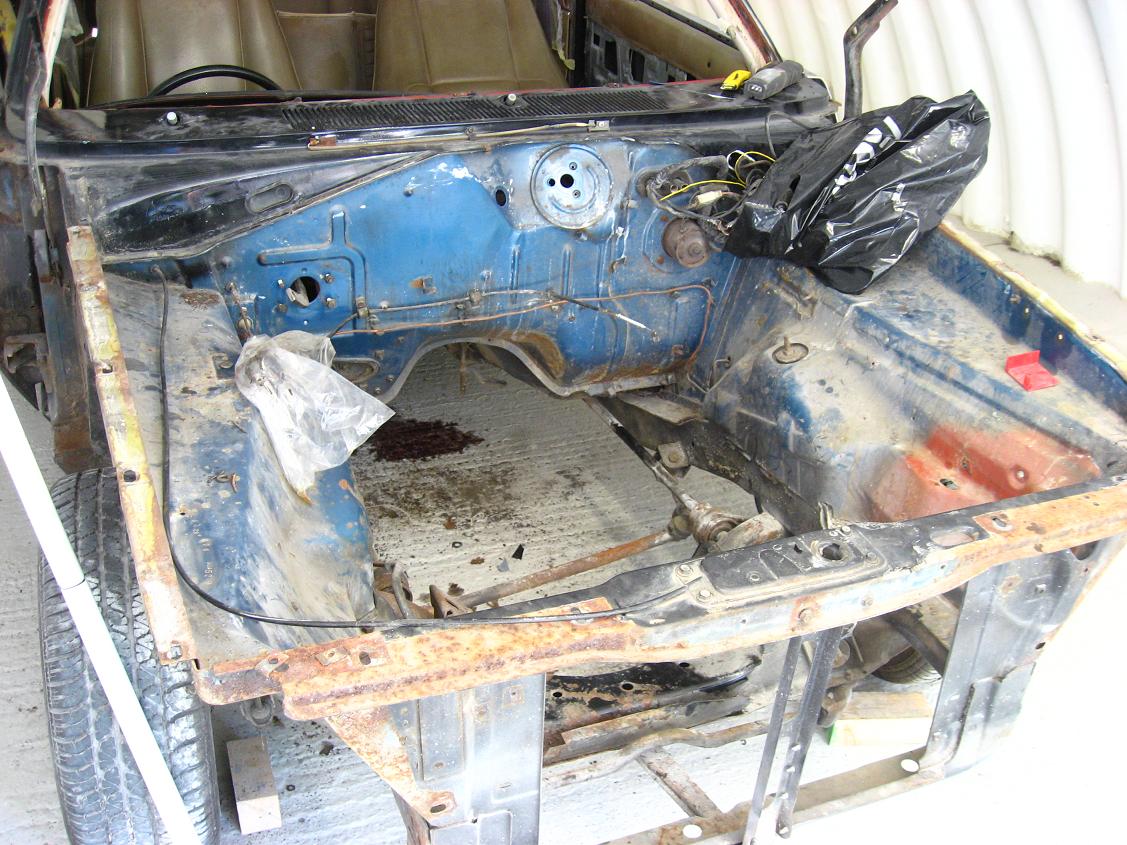

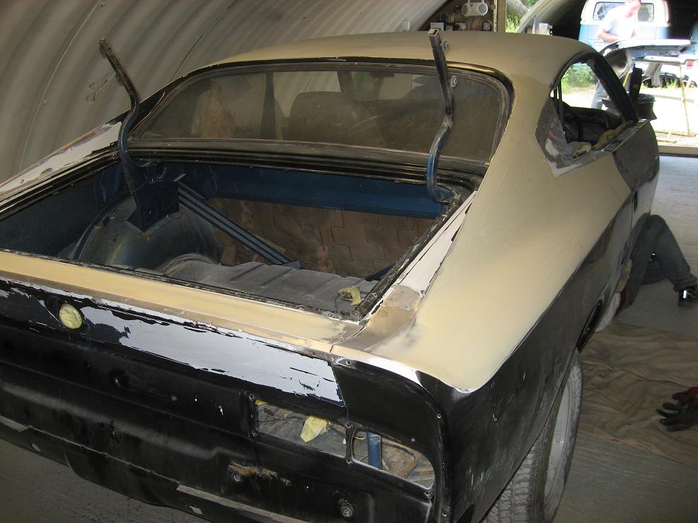

Spent some more quality time with the Charger yesterday...body's coming on nicely.
Resize 4.jpg (118.06 KiB) Viewed 1742 times
Resize 3.jpg (76.71 KiB) Viewed 1742 times
Resize 2.jpg (183.07 KiB) Viewed 1742 times
Resize 1.jpg (185.61 KiB) Viewed 1742 times

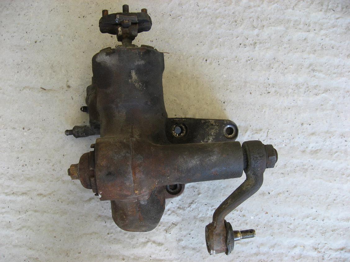

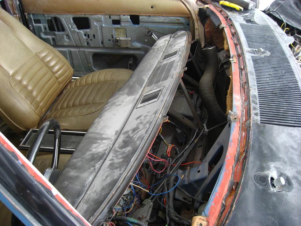

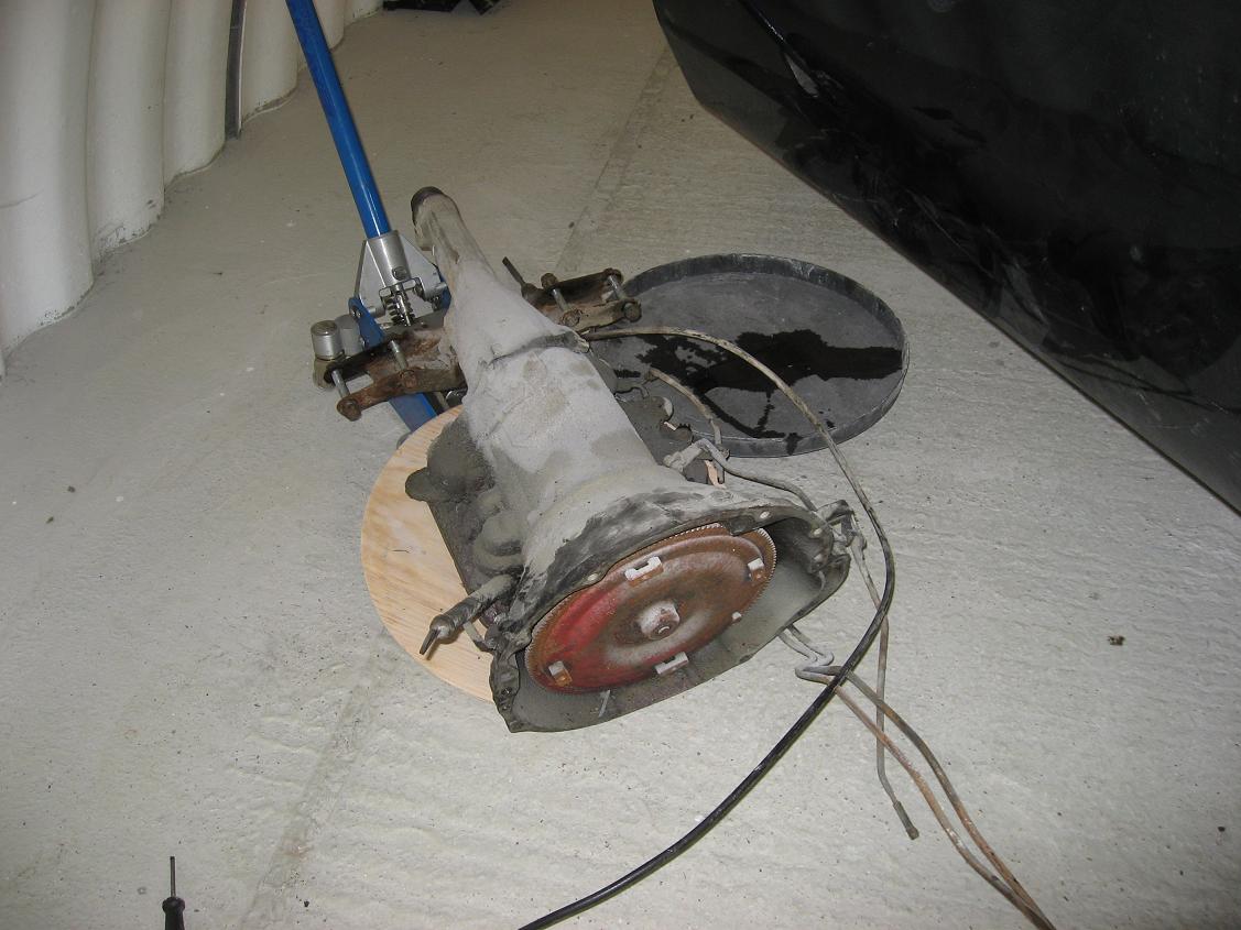

and some more...
Resize 7.jpg (135.89 KiB) Viewed 1735 times
Resize 6.jpg (135.02 KiB) Viewed 1735 times
Resize 5.jpg (101.23 KiB) Viewed 1735 times
David Ward
