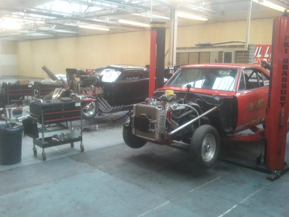

Well done Pete ,,,, I was told to mount trans cooler to the front of rad,,,,couple of bracketts welded to the rad and jobs a goodun..not a great photo...

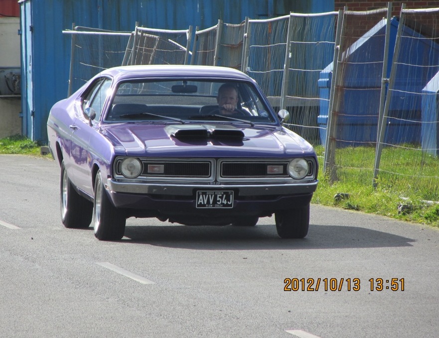

:thumbright: Great days driving, even better meeting people to put faces to names (not the best with names, see Billy Gibson on the Friday thread :oops: ) Loads of advice taken away with me to try and open my ol steam roller up :lol: soon be spring and we can start all over :thumbright: thanks guys.
Posts: 22116
Sweet car.
Also saw Chris (WASP) up there with a nice Camaro...
Demon James.jpg (217.69 KiB) Viewed 3380 times

Demon James
Posts: 1062
Post by Demon James »
:lol: :lol: Crickey! That's Dr Zoidberg from futurism a driving! :D
trouble with mounting the cooler on the rad is it comprimises the water cooling to a degree try to get it to the left of the rad pete under the headlight

Demon James
Posts: 1062
Blasted autocorrect, that's meant to say Futurama!
