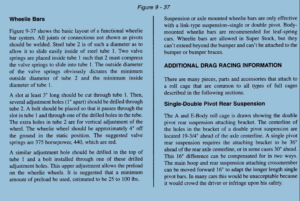

thats bloody brilliant blue.. so pete needs a 50" bar,
the sort of detail i reckon most people with wheel bars dont bother with.... thanks

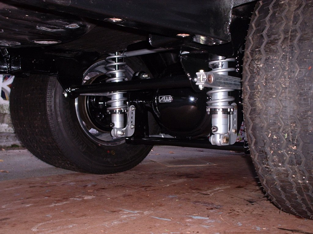

All rod-end mounted chassis components are designed to be mounted with bolts in the 'shear' position. My S&W 4-link with QA1 coilovers is all mounted with bolts in the shear position and all with nylocs. If you check out the Chassisworks site their kit is the same and as Pete says, all ladderbars are designed this way.
Sorry but I gotta disagree with you Clive (though I know I'm about to get shot down in flames
) Bolts ARE designed to be used this way aswell. They have a shear rating (which obviously will be less than the compression rating), you just have to ensure your application doesnt exceed this.
BTW, I've used nylocs for 30 years on bikes, mainly buzzy 2-strokes, and have never had one work loose. Maybe i'm just lucky?
- rear end 02.jpg (157.16 KiB) Viewed 2068 times
- Rear end 01.jpg (157.91 KiB) Viewed 2068 times
Anonymous
db wrote:All rod-end mounted chassis components are designed to be mounted with bolts in the 'shear' position.
Sorry but I disagree with you Clive (though I know I'm about to get shot down in flames)Bolts ARE designed to be used this way aswell. They have a shear rating (which obviously will be less than the compression rating), you just have to ensure your application doesnt exceed this.
Mate, of course bolts have a shear rating, but where a bolt is used in a horizontal (for want of a better expression) position, the bolt in full preload puts a compressive force between two surfaces and it is THAT clamping force between the two surfaces which you rely on to resist shear - not the bolt alone. Bolts arent designed for that.
I could bore you to tears about bolted connections mate. Really.
