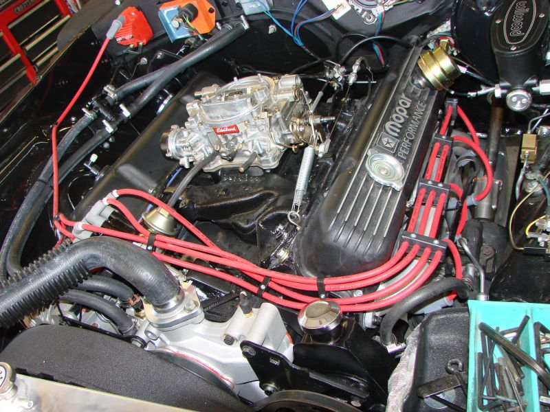

I am down the home stretch here,I bought an aluminum radiator and wanted to use the stock shroud ,so I was able to get some speed nuts to fit and with that sorted the engine is in along with the trans, exhaust,electrical,cooling lines, fuel lines all has been installed in the car.

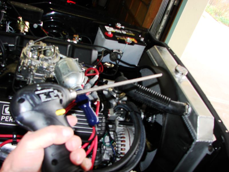

I DID manage to get it started last week but.................no oil pressure the engine sat for 6 years and the oil pump was dry so I removed the filter , jammed some assembly lube, pulled the dizzy ,got the tool spun the pump backwards ,got it to pressurize(pulled the sending unit to make sure...... spewed all over ,made a mess),clean that up and finally ........got it running :thumbright: :thumbright: :thumbright:
Its a bit smokey this was the first start up

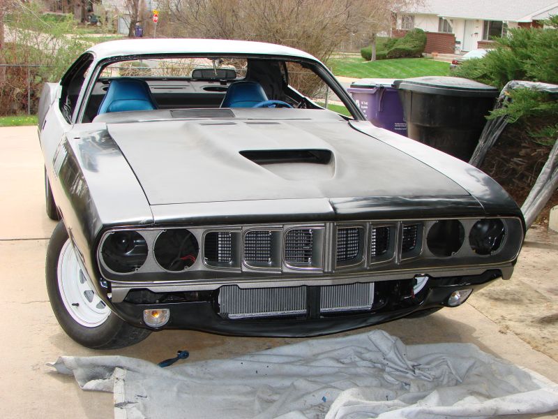

a huge mile stone here is a vid and a pic as it sits now I am taking a few days break from it as I really need to I have been on it all winter , but now I have something that moves under it own power a big step in the resto makes it way more fun
front install 003.jpg (111.37 KiB) Viewed 2009 times
oil pump and vid 009.jpg (86.1 KiB) Viewed 2007 times
