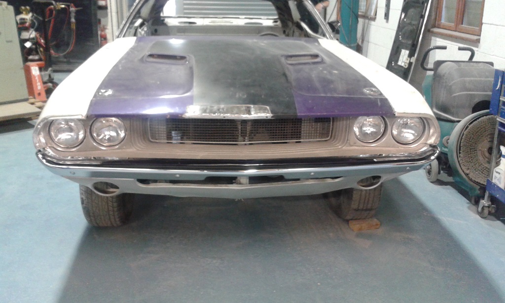

On the plus side, the front end panels have been aligned and the tear in the bonnet leading edge repaired. With the headlights (temporarily) installed the car now at least looks like a 70.

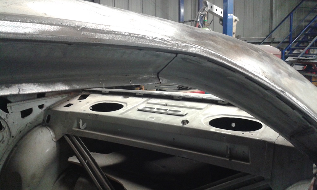

Whilst waiting for the new door skins to arrive a bit of investigation was done on the rear roof pillar join. A couple of pinholes on the left hand side and a patch on the right. Both sides cut out and new metal welded in and leaded.
As I've said, I'm using a bodyshop to complete this work for me (as I have very little aptitude for bodywork). I've included one of their more usual projects for information.

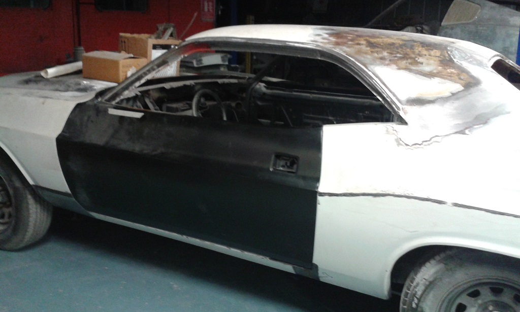

Well, looks like the bodywork is basically complete. New Year One door skins and deck filler panel installed and look good. Next thing, hopefully, is a trial fit of the 440.
Driver's side (masking tape line is a reminder to transfer mirror mounting holes across from the old skin)

Passenger side door (and repair to bottom of front wing)
20141018_110516 small.jpg (155.64 KiB) Viewed 3146 times

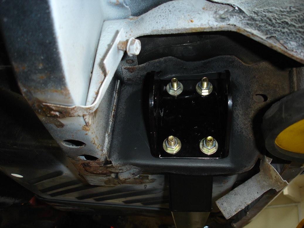

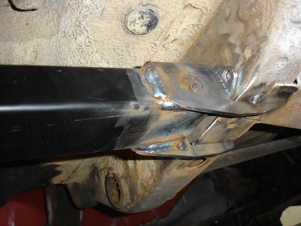

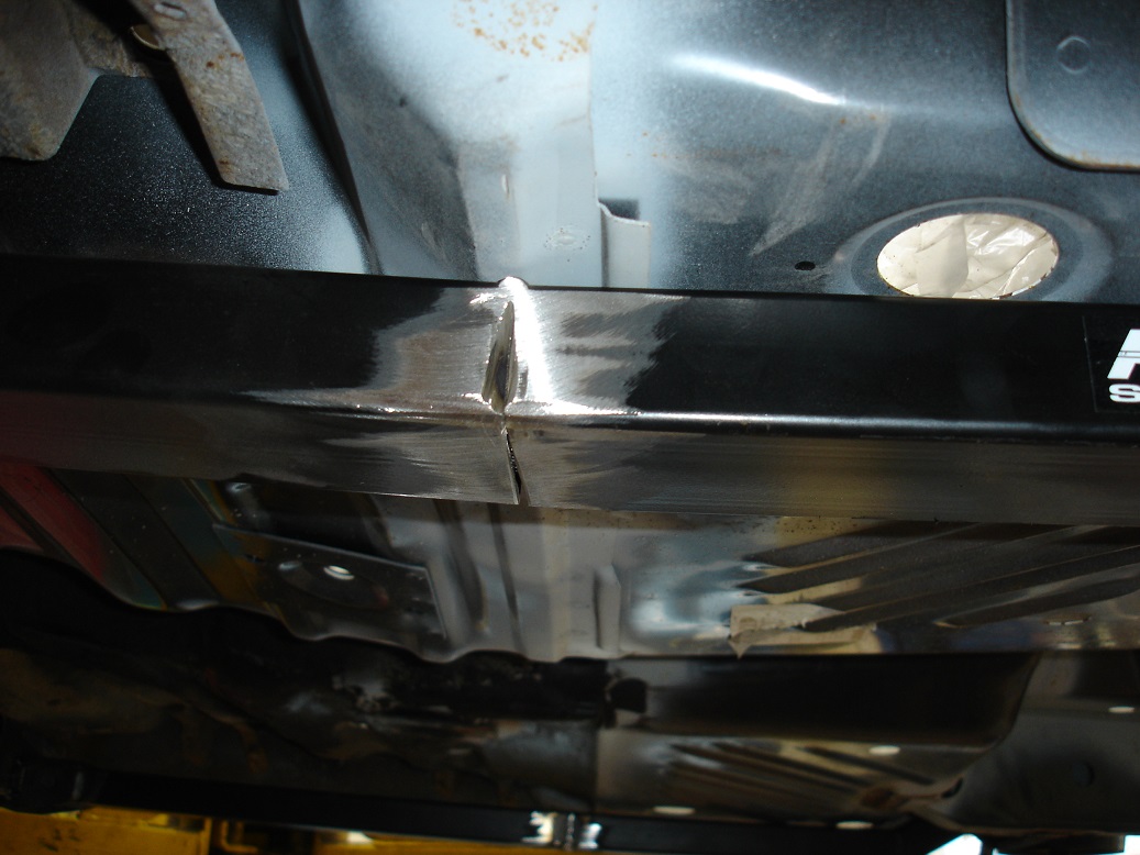

Next - a trial fit of the Hotchkis sub-frame connectors. These needed a bit of persuasion to fit where they'll ultimately reside. This may be due to the fact that my car had complete new floors installed before I bought it so they may sit slightly low but the end result is that the connectors have been notched and re-welded to clear the floor.
It also transpires that this car had the optional 2.76 final drive ratio diff rather than the 3.23 I was expecting.
On the plus side, a mock-up with a 15" Torq thrust shows the likely future stance.
Massaged to fit - awaiting welding.
Challenger 230515 011 small.jpg (197.48 KiB) Viewed 3004 times
Not my original vision for the wheels but I like it.
Challenger 230515 027 small.jpg (234.42 KiB) Viewed 3004 times
New leaf spring mounts -bolt to rear of the sub-frame connector.
Challenger 230515 010 small.jpg (218.54 KiB) Viewed 3004 times
Tacked on at the moment. Might need to adjust when the whole weight of the car is on it's wheels.
Challenger 230515 005 small.jpg (252.83 KiB) Viewed 3004 times

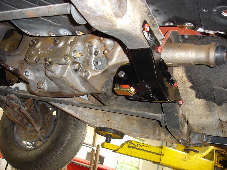

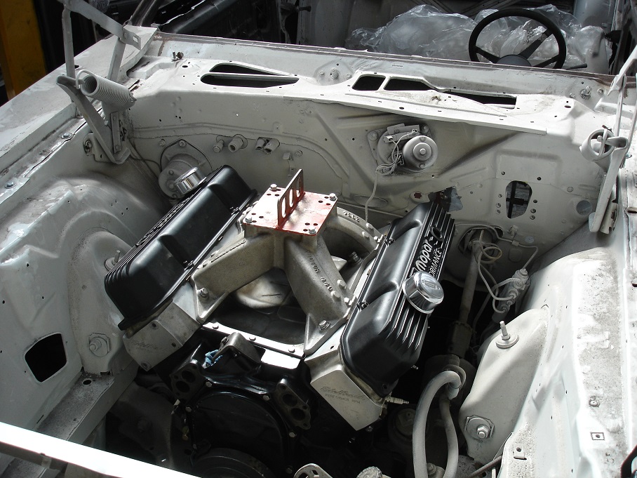

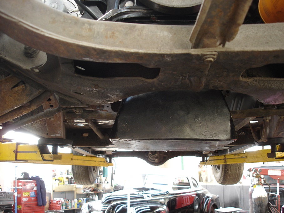

It was always the intention to trial fit the 440 and the manual gearbox to make sure everything lined up and, with the exception of the extended sump being a bit close to the K-member, it all seems to fit relatively well.
To balance the progress, it seems the steering box will need rebuilding/replacing at some stage.
More soon.
Transmission temporarily installed.
Challenger 300515 002 resized.jpg (223.18 KiB) Viewed 2943 times
Sump may need some additional clearance.
Challenger 300515 001small.jpg (221.58 KiB) Viewed 2943 times
Engine looks at home.
