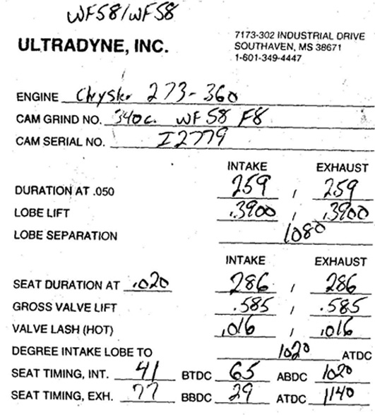

If you look up the cam spec it should tell you what spring to use with that cam....have you got the cam card???
Posts: 8368
I wondered why I couldn't get your attention Dunc ;)
Cam card below Pete... :)
CAM CARD.JPG (149.19 KiB) Viewed 3745 times
