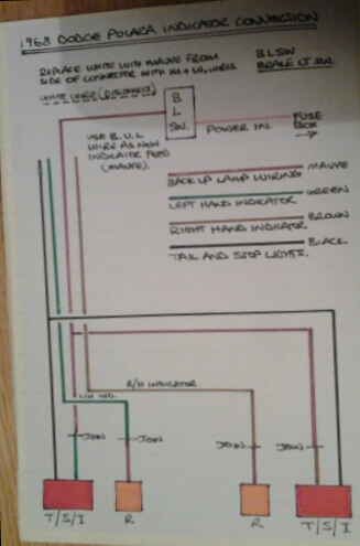

This is what I mean matey....I like simple!!! This is basically a schematic I did from Miles' advice re orange indicator conversion....give it a go, might help...
cheers Steve :read2:

Steve wrote:This is what I mean matey....I like simple!!! This is basically a schematic I did from Miles' advice re orange indicator conversion....give it a go, might help...
I like that Steve,I'll ad more on here tomorrow.
