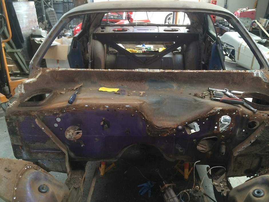

nigeltaylor wrote:Yep, 7 pieces of metal all riveted together and dropped in from the inside, not even riveted to the body just bolted to the valance and wedged to the wheel arch! Finished off with an inch of filler! I would guess its a home repair!!

I'll get some welding done on the floor and frame then get it blasted! Otherwise I might not get much back!!!

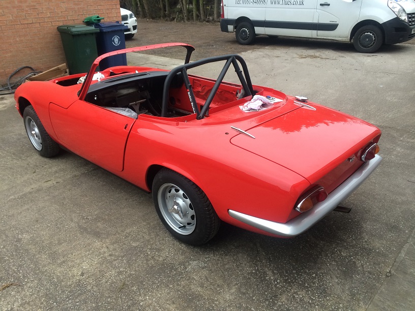

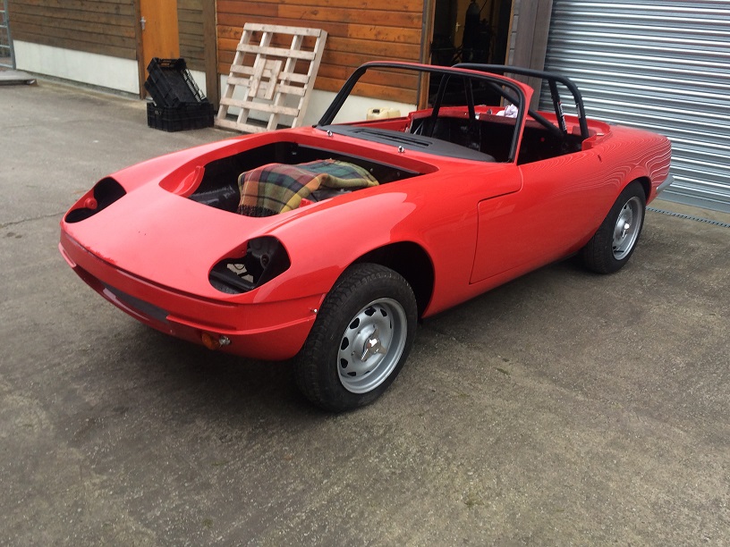

Yes it's an elan s3! Well guessed by the tail light I presume? Will add some photos tomorrow,it's just back from a full respray.

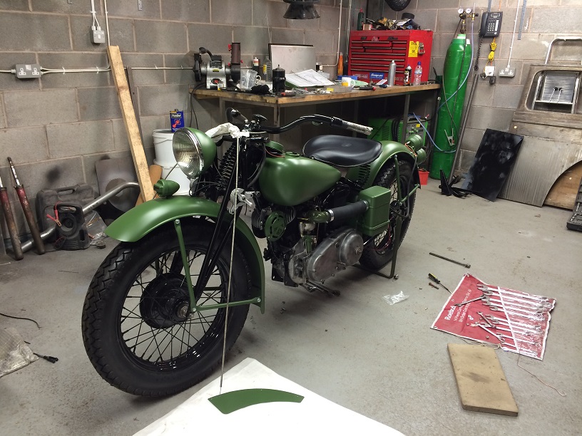

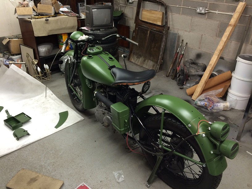

For those who asked, here is the Elan, along with my other project. The Challenger hasn't had much of my time this week, due to trying to get the bike finished!

Wow :shock: first with the work you have on the Chally and wow at the other toys. Oh and wow for the workshop. Good luck Nige. Another for the MMA 4 speed branch.
love the look of that bike nige, what is it an injun, ;)

Yep, Indian 741, should be running this week I hope!
Love that bike ! =P~

I thought our Chally was rusty but those 'repairs; on yours take top prize! Keep the updates and pics coming along - nice to see another one coming back to life... :thumbright:

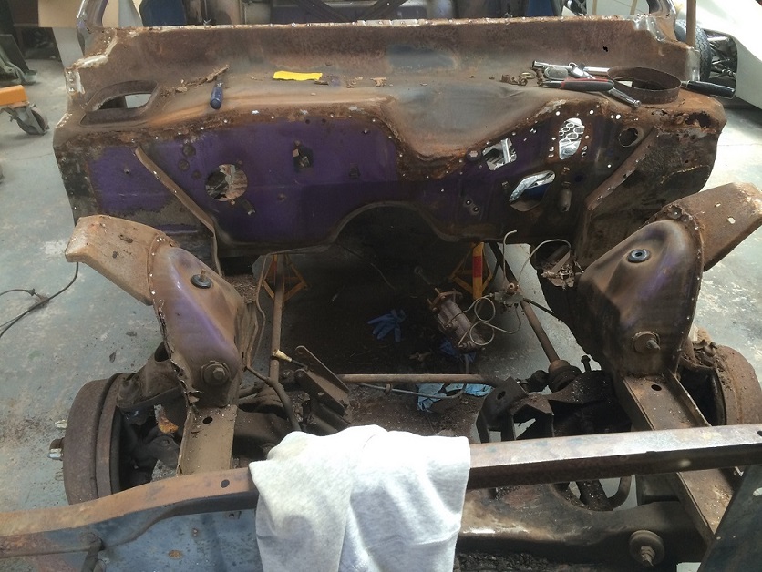

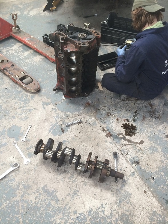

A little more progress. Got the replacement front and rear sub frames stripped, blasted and ready to put in. Am now waiting on all of the sheet metal arriving from AMD in the next few weeks
The plan is to put the car on the chassis jig (which I will hopefully be borrowing) get everything straight and bolted up, then cut out all of the rotten parts and replace them, bolting them back onto the fixed points. Well that's the theory anyway!!

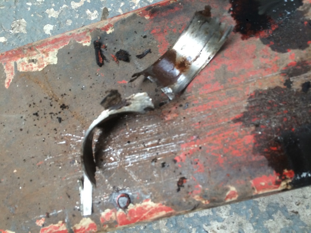

Engine is now disassembled, looks like it had spun a shell on the bottom of one of the con rods. Had a little look down the cylinders and a measure and decided on a re bore at some point whilst I wait for the sheet metal to arrive.
