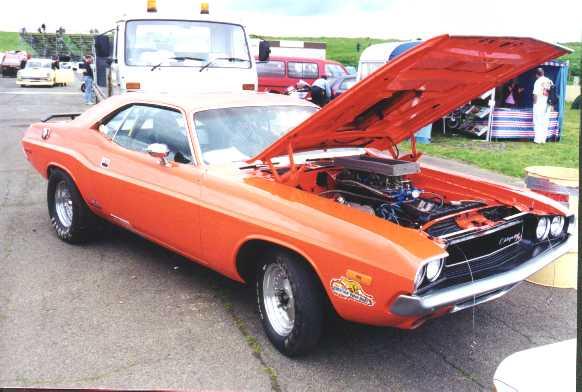

I remember some old boy years ago doing it long before i got hooked ..wonder what happened to him ......they say the older you get the faster you was ...be nice to see that old boy out doing it again ....

396ci .700 lift roller, dome pistons, full port alloy race heads, they must spin that over 7000 and i bet it's got at least 5500 stall.

Yep 6000 stall, shift at 8000rpm.....no suprises, in true A/SA style...get ready for some of the same Pete!!......
Also did you notice he shifted into neutral just after the traps....I guess these boys know what they are doing, maybe they have a special trans?...but never do that on a stock type built trans, firstly it will overspeed the drum and cut oil to it as the pump is driven by the engine = possible grenade!.....not good.
Les
Posts: 14617
You can get a special valve body that has another neutral after high gear so you can knock it out of gear and kill the motor after the lights. The reason is to avoid stretching ally rods by dragging the motor down, one of the biggest reasons for them letting go apparently.
