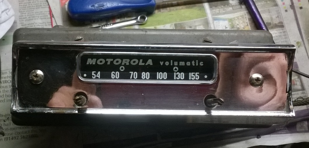

This is it- Motorola 5M Volumatic 1955
http://home.comcast.net/~vwradio/bigm/BigMRadios.htm
The missing valve is the vibrator tube you mentioned Dave-

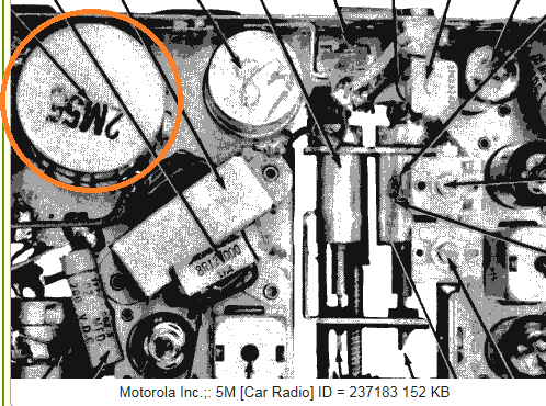

The electronic design uses a mechanical vibrator tube to produce high voltage (~200 volts) through an oscillator, transformer and rectifier circuit. The 200 volts used to power tube grid elements. Vibrator tubes have contact “points” which wear out with use and commonly need replacement along with the buffer capacitor. The vibrator tube also has a low volume but audible “hum”.

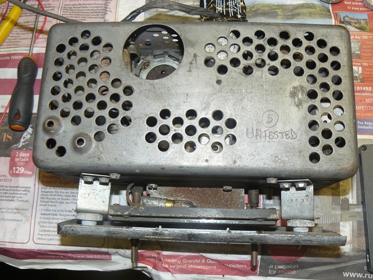

Looking at your first picture, all six valves are in place so the missing component must be something else. My guess is another electrolytic capacitor but can't think why it would have three pins unless the third is connected to the case.
Posts: 8369
Thanks Mick, yes it's a vibrator tube that's missing. Daves post explains what it does :thumbright:

Well these were certainly fitted in 53-55 Chevys, I've found fitting instruction manuals for those. No doubt some Mopars had them too.
This link has an amazing amount of information- it starts with an explanation to why Beetles exported to the US came without radios... European spec receivers could tune in to frequencies deemed illegal by the US!
http://www.thesamba.com/vw/forum/viewtopic.php?t=535705
5 =model year (1955)
M= manual tuner
12= 12 volt
Volumatic= automatic volume level (compensates for signal drop, etc)
The two little arrows on the screen are Civil Defense markers- tune in here when war breaks out! :lol:
