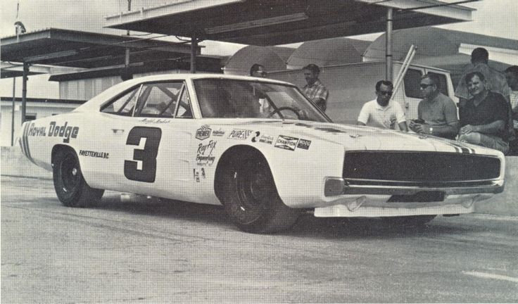

while i'm a fan of black steel wheels , ( gives the car a grandnational stock car look ) I originally wanted to fit , torque thrusts originals or TT2 , or daisy mags or centre lines , the thing that stopped me was , to have these wheels , I could not have , the same wheel & wide tyre , combo at all four corners , (255) , with the back space available , & give the deep dish look I wanted , that was safe imo , ( giving enough clearance between wheel arch lip & tyre wall at full suspension travel & lock to lock ,
slot mags , went being repoped back then , so went with second choice ( or 5th depending how you look at it haha) , 15 x 8 steel wheels & 4 inch back space , 4 & a half back space is better , but I wanted a deep dish stock car look .

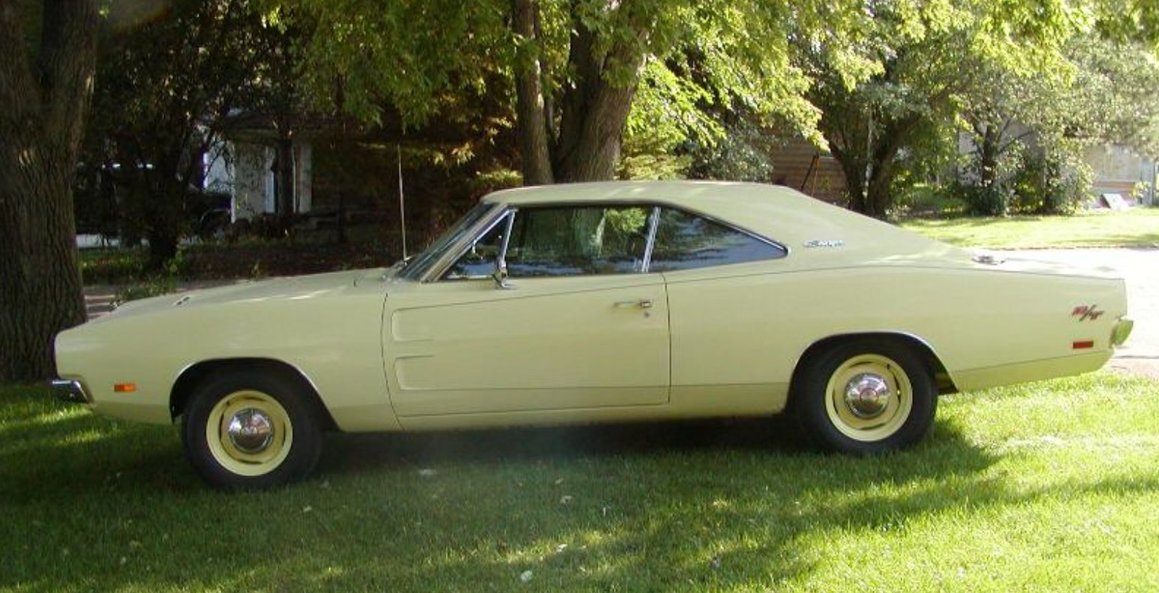

think painted body color steel wheels would look too much with out a vinyl , I thought mine would of been to much even with one , seen picture below , ( for reference )unrestored original paint Y2 .

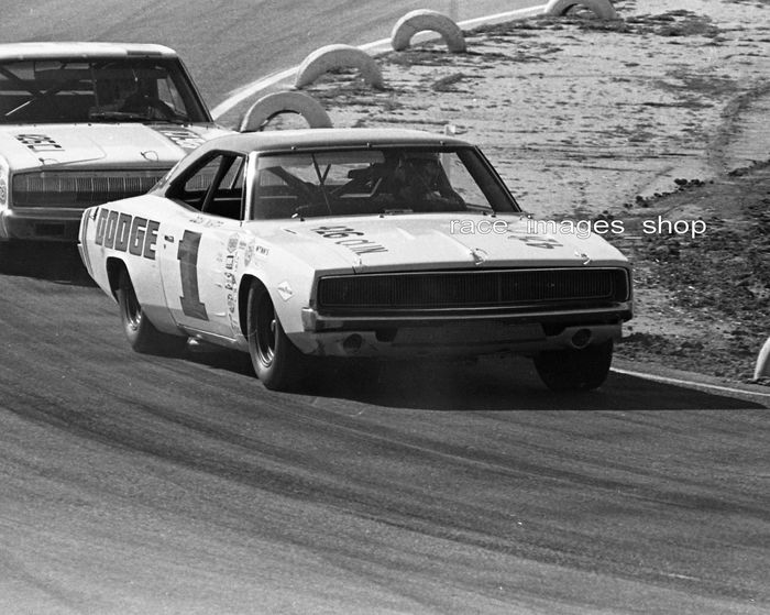

others are the deep dish grandnational look 8-) that I was trying to recreate , IMO look mean :?
