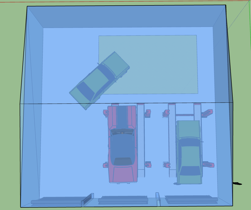

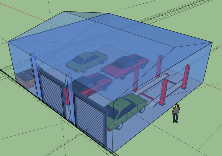

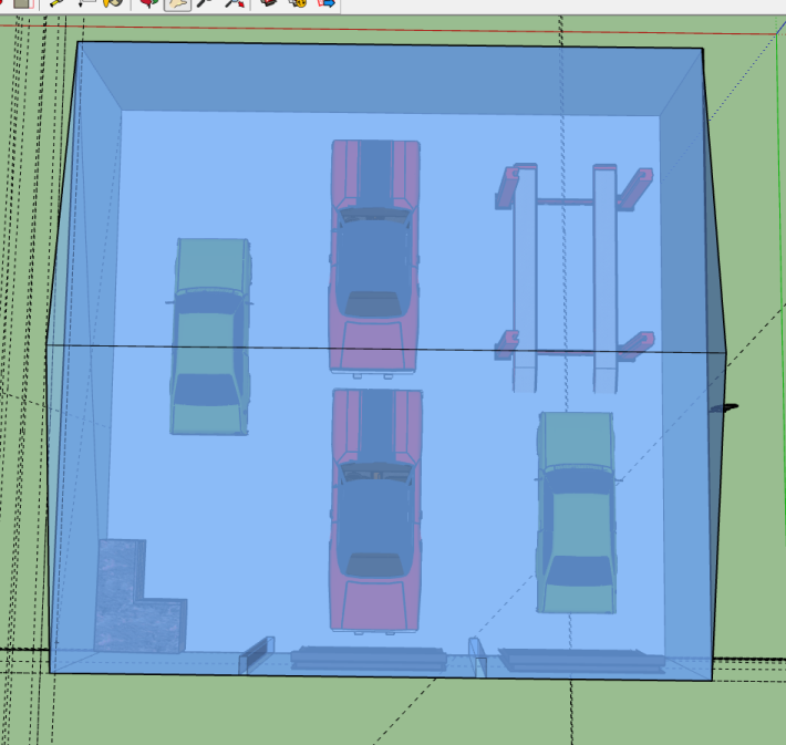

Please see V3 of the designs, now 40x40 (to allow for longer cars parking back to back).
Lift over to the right as suggested.
I can't really justify the 3rd door, I'm going to lose wall space also.
The far left area will be the welding/cutting/project corner. So cars there will be in long term parked positions.
Main question left, are the doors (at 3m x 3m) big enough?
Transit high top vans are 2.5m high and I can't see anything wider than 2.5 m going in...
Thanks!
J

From personal experience I would use a two post lift by the door so you can use it all the time and the car in front of it can be left there without moving a car to use the lift.
I prefer two post lift for most jobs. Four post lifts restrict access under a car too much. My door at my workshop is 3m x 3m and i have never had an issue with that size.

I think Anton's suggestion of putting the ramp closest to the door makes some sense, the only other thing I would add would be a mezzanine floor to the area beside the ramp, a friend has done this recently & it works really well, somewhere to put the stuff/junk we all accumulate & use the ramp & a short bridge to get heavy stuff up there.

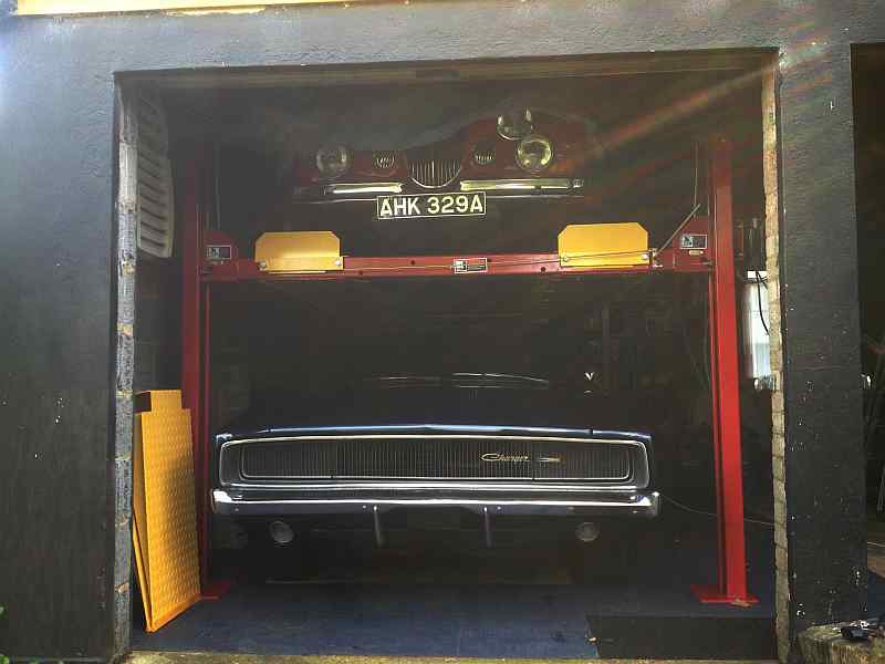

I bought a four post ramp lift from ebay a couple of years ago, been very pleased with it. Cost about £2100 delivered and assembled. Cannot find company I got it from, but looks very simular to this one.
http://www.ebay.co.uk/itm/4-POST-PARKIN ... SwRLZT14Vd
They come with a wheel kit, so you can move them if you need to ? I never bolted my one down and it sat very firmly on the ground, even with the Charger up in the air and me fighting the front suspension.

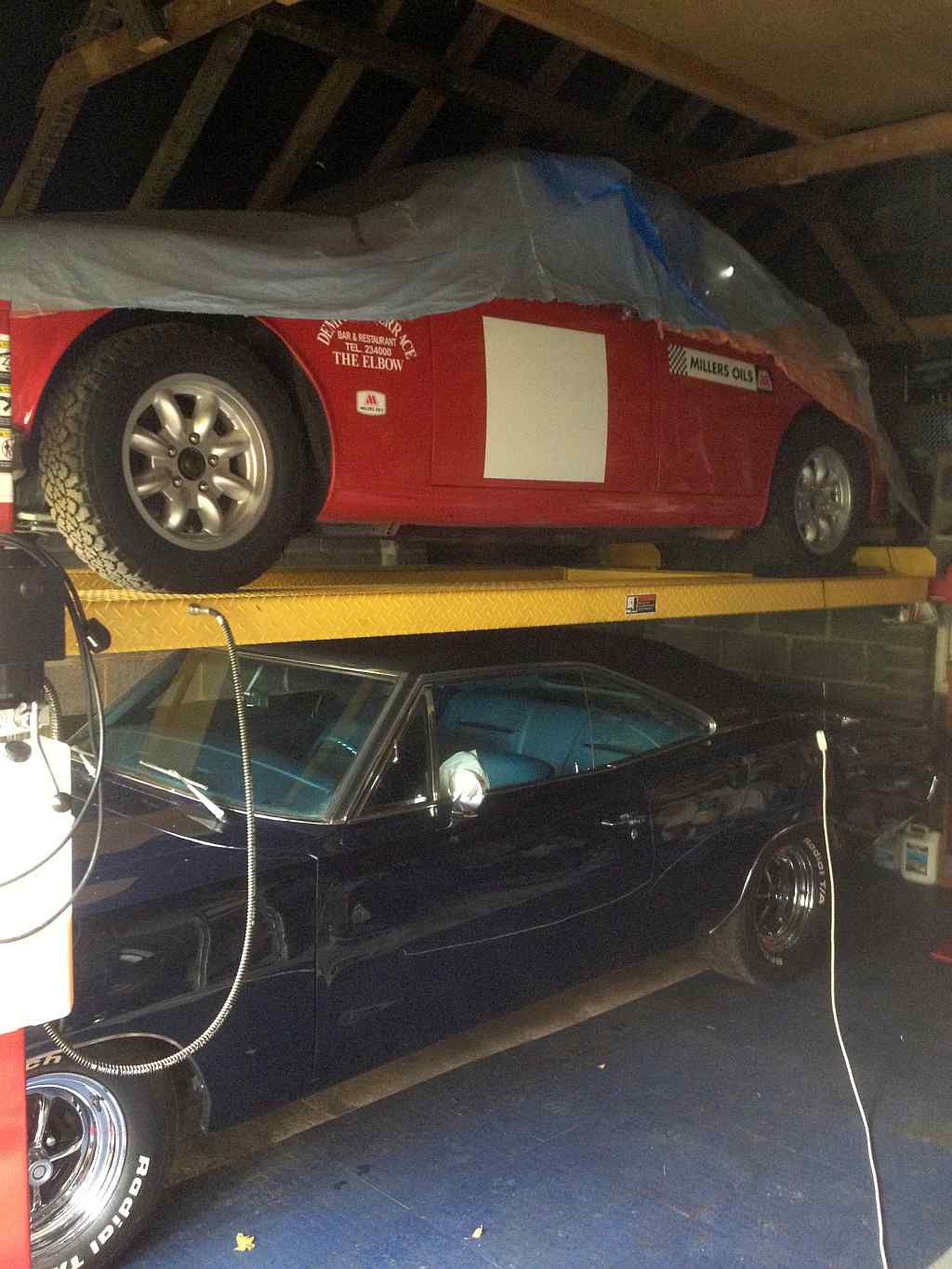

Has been very useful for stacking the car in the garage as well, so you might want to think about garage height ? Have just taken it apart, as we are moving and it is very solid made !! my back hurting just thinking about it.

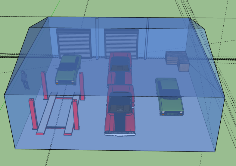

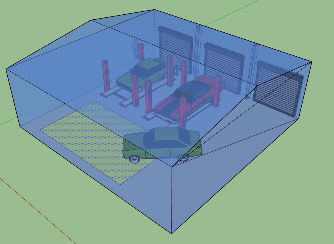

Thank you again all that have commented, I've taken feedback on-board and come up with Plan V4.
Still 40x40 square. 3.5x3m doors
Lift (maybe two) moved to the front.
long term project area moved around the back right of the garage, where a bench and tools will be.
It required a 3rd door.
Thoughts again please guys?

Helpful, thanks. The building I have will be 4m to the eaves, so enough to have 2 cars stacked without issue.Picture of the cars stacked
I've tried all sorts, in this space it seems to work best but only with a 3rd door.I think Anton's suggestion of putting the ramp closest to the door makes some sense
I toyed with this, I could still with a 4m to eaves high, over the project area in yellow could work and allow ramp walk in/wheel off access also.I would add would be a mezzanine floor

Regarding doors - I've been told the Cat5's are best. I might be as well to go for the slightly less industrial type as these doors are ~3k each!!!

If your going through the expense I would seriously consider putting water and waste services in.
The constant frustration of walking back and forth will do you head in.
One to tap and sink with a spur for hose connection. This will allow washdown, cleaning and chance to keep the mancave actions all within it. Especially in the depths of winter!!
Mezzanine for parts storage would also be beneficial. Only needs to cover half the open space with stairs in the corner. This will help to keep the car area clear when doing a total breakdown and rebuild.
